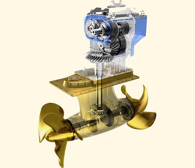

    Fortjes Pod Propulsion from Reintjes
    Dear HTM09,
    Are you familar with this pod propulsion system, FORTJES pod? What do you think of it.?
    It appears to offer a number of good features, and being a 'pair of counter-rotating props' (one at each end) it could provide generous blade area in an overall shallower draft unit, and a simplified engineering as co-axial shafts are not needed.....other features as well.
    https://www.navalengineers.org/ProceedingsDocs/FAST2011/FAST_C/C7-2.FAST2011.Weber_Schulze.pdf
    http://www.reintjes-gears.de/fortjes/pdf/fortjes.pdf
    Claimed to be 30% less fuel consumption in one installation?
    Break-away capability, and other features....
  13. HTMO9
    HTMO9 Senior Member
    Jan 13, 2009
    1,681
    Yes I am. It combines the Pod drive with the advantage of the counterrotating prop. The counterrotating prop converts a large part of the centrifugal force of the thrust into forward thrust, if made correctly!!!! Just like counterrotating propeller on some military aircraft.
    But the Reintje pod does not turn. It needs a rudder behind and therefore destroys part of its advantage.
    I have heard, the had to fix it for some reasons ????? This pod with 360 turn angle and the electric motor build gearless in its vertical shaft would be the most ideal and effective DE pod drive in the world (for yachts). Both for efficiency and performance. But even as a mechanical pod drive with gear and shaft to an conventional diesel engine would be great, if it would turn.
    The greatest advantage with this pod drive would be, it is usable both for displacement and planning hulls with different props and gear ratio. There are most likely some kind of legal reasons behind all that. Volvo Penta IPS, ZF Zeus, Schottel and Reintje, they are all fishing in the same pond. I cant say more.
    - Reintje will not build turnable drives for some reasons.
    - Schottel will not build counterrotating props (for simplicity ?).
    - Volvo Penta owns the counterrotating pulling prop with internal exhaust.
    - ZF owns the counterrotating pushing prop.
    - Schottel owns the Twin prop and rudder propeller and SCD
    I have no solution for that mess. But this excisting Reintje pod drive could be adapted to existing planning hulls even with prop tunnel. Part of the design is the assymetrical airfoil of the shaft fairing. It would at least be much more effective than these 20 degrees downward pointing standard shaft drives.
    :rolleyes:

  15. HTMO9
    HTMO9 Senior Member
    Jan 13, 2009
    1,681
    Pod Drives (DE or mechanical)
    All those companies like Volvo Penta, ZF, Schottel or Reintje have excellent engineers and are industrial leaders in their market segments. But they all have this Apple and Samsung syndrom.
    They know exactly how their product would have to look like, to be just perfect. But everything or at least parts of it have been invented or developed already and are covered by Patents or trademarks of somebody else. So, they develope a variant or even something completely new, just to stay outside patent coverage and legal trouble.
    Volvo Penta for example owns all patents and legal rights of the (IPS) Poddrive System with counterrotating pulling props and intergrated exhaust system. They were the first. And it can be mounted directly to the bottom of the hull, excepting existing deadrise. The pulling counterrotating prop is the most effective, because it chews undisturbed water and the exhaus gases exit within the laminar flow propeller stream and exit the water far behind the boat. Easy to install, works excellent in pair or quadrupple arrangement. In tripple arrangement the middle pod is blocked in the center position, because the steering computer does not know, what to do with it. So you either install 2 or 4 IPS. It works with 3 pods also, but not as effective, 2 pods are the minimum, single drive does not work. Biggest disadvantage, the system is only usable for planning or semi planning hulls and you are stuck with Volvo engines.
    All other companies had to come up with a new approach for the same task.
    ZF uses pushing counterrotating props but the pods have to be mounted vertically. That means, the hull has to be specially designed (pod steps). Biggest advantage, choice of engine manufacturer and even single drive is possible. Up to now not as many different types available. It seems to have better break away capability, less damage to the hull, in case of ??? Also for planning and semi planning hulls.
    Schottel lives in the big and heavy commercial world and just starts to look for yachts and smaller river cargo and cruising ships. Their systems are ment for the displacement market and are not easily adaptable for planning hulls. Because their pod drives are designed for much higher torque and power transmissions, Schottel is very reluctant to adapt the counterrotating principle of Reintje because of its more filigree design.
    So, what was left for Reintje, they were last in the race. What you see is their answer to paticipate on that cake and stay out of legal trouble.
    One should force those companies to cooperate and put their ideas together for the ideal DE or mechanical pod drive. But here we are back to the Apple and Samsung problem.
    "It is easier for a camel to go through the needles eye than profit-orientated companies working together"
    Cheers
  16. Opcn
    Opcn Senior Member
    Mar 15, 2009
    478
    Turning the mechanically driven pod is a bit problematic. All the torque that's destined for the props is turning away in the vertical shaft. If you have any resistance to the props turning (say a gear chips and the fragments end up in between the teeth) then suddenly all the mite of the engine is working against whatever is holding the pod still. If it's a little electric motor there to turn the pod it can probably be overcome with negative results.

    It might surprise you to know that Outboard Motors and Stern Drives have a very similar arrangement in their gearboxes, gear chips sufficient to jam the thing up are not very common in well manufactured and maintained constant mesh gears.
  18. Opcn
    Opcn Senior Member
    Mar 15, 2009
    478
    Not at all surprising, it's just a possible reason (an answer to HTM09's question) for why they would choose not to. I suspect that gears chipping are an infrequent reason for problems, and it was just one example off the top of my head of something that could happen, not a weakness in the gear arrangement, but even the best gears occasionally with chip off a little fragment, nothing lasts forever. Something happening to jam the apparatus and cause the torque that drives the prop to come largely to bear on the pod from whatever source probably happens often enough to warrant needing to plan for it and take care. A line fowling the prop would have probably been a better, and more common, problem to illustrate the situation. It's not an insurmountable technical problem, I think that Volvo Penta IPS uses a shaft and much the same gear arrangement, I just wanted to present a reason why someone might decide not to make such a pod azimuthing.
