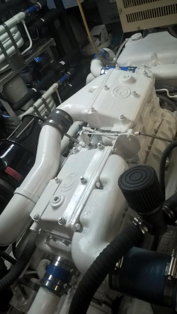

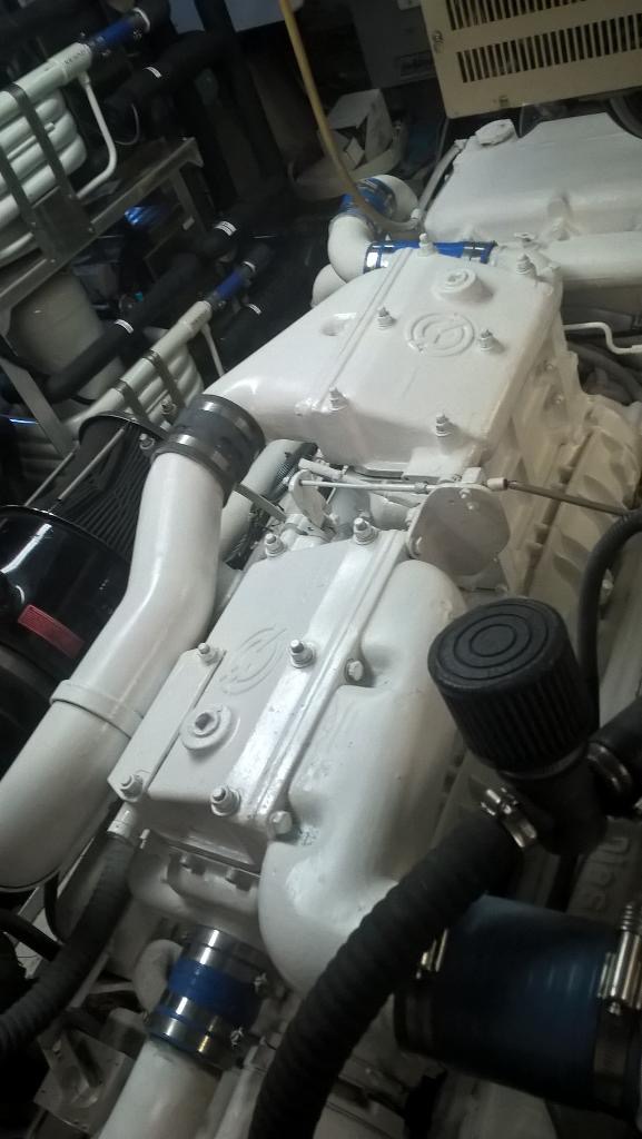

  17. cleanslate
    cleanslate Senior Member
    May 29, 2018
    1,661
    Cherry Hill, NJ
    Capt rtrafford. Beautiful motors and engine room. Looks real nice.
    But,
    I'm not sure if this is a current photo, I noticed that walker air sep filter possibly needs attention . Please don't take this the wrong way. I just noticed it.
  18. rtrafford
    rtrafford Senior Member
    Jul 13, 2019
    1,991
    Vero Beach
    Thank you. Yes, old photo taken as the airbuses were being remounted. Walker took some abuse during the effort, but all were changed when we then swapped out the 4 turbos. She's come a long way, and I'm quite proud of the outcome. Spent perhaps a decade with pure neglect from a disinterested owner/seller.
