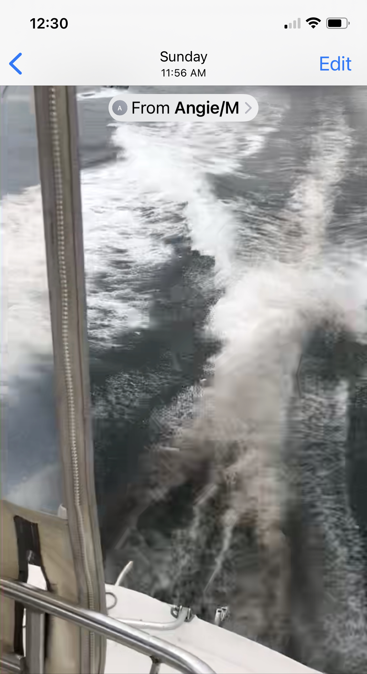

    Both turbos are brand new. We've run with the breathers off too. Right before COVID, we cracked the exhaust elbow on the stbd motor, which started the whole process. Sucked soot into both motors 1/2 btwn our port and Catalina on the return. Aftercoolers, blowers, turbos, injectors all rebuilt or replaced. Everything checks out fine w/out load, it's when you put a load on - we start to smoke. We played with the injector timing which did help a bit, but put it back to stock timing of 1508 vs 1484...made it worse. We can't reach 2350 loaded, so that's why I am thinking, over propped! Puffing black smoke and not making full RPM is kind of a sign we need some pitch removed - I know black smoke indicates lack of fuel or air, but could also mean the wheels.....just so frustrating!

    Can you help with a better timeline? Did you change the prop pitch after you did the rebuild from losing the exhaust elbow or before? You said the smoke issue started when you did the rebuild from losing the elbow. Did you run the added pitch before this happened? Did you have the smaller pitch props after the rebuild? Or did you re-pitch the props at same time as rebuild?
    And are you saying you have very visible black smoke at 800 rpm and up or is your main soot on the transom? Just trying to get a better sense of what you are dealing with and what changed, when. I'm struggling to understand the heavy smoke at 800 rpm if your only issue is being overpitched some. Yes, too much prop will cause issues throughout the range but hard to imagine that much issue at 800 rpm from 1"-2" too much pitch.

    Prop change was after the exhaust leak. But that said, we were smoking a bit as I stated earlier before the prop change. Stbd turbo was not making adequate boost, so we replaced the turbo. Injectors are 7425- 145 mm spray - they are not the Reliable injectors but rebuilt stock injectors. To be clear, pre re-propping, it was only the stbd that smoked, now that we are propped as close to factory spec - 24 x 27/28, both motors now smoke. Trying to upload a video, but can't for some reason - keep getting an error notice.

    100 over is not a bad place to be. 25 to 50 over is probably perfect. But if you were 100 over, why in hades would anyone recommend 4 inches of pitch be added? Well, that's a bit rhetorical.
    My rule of thumb has always been that an inch is the very rough equivalent of 150-200 RPM. Now, that's a very general rule, but it's at least a mild guideline. Had I been asked, and why would you ask me?, I would have recommended adding heavy cup and no pitch change, check and balance, and splash. I'd be looking to trim you by perhaps 50 to 75 RPM, not more given what I know of you situation. You don't need to hunt maximum speed. Efficiency and longevity is your friend.

    I have 2in shafts and the props were at 24 x 24. We cavitated terribly, which is the reason we jumped up in pitch. Original spec's on the props were 25 x 28. They were cut down to 24 x 24 by the previous owner. Couldn't add diameter back so we got as close to original as we could, which is 24x27/28. I think if we take about 1.5 to 2in out of pitch like rtrafford stated, we might be as close to dialed in as we are going to get.
