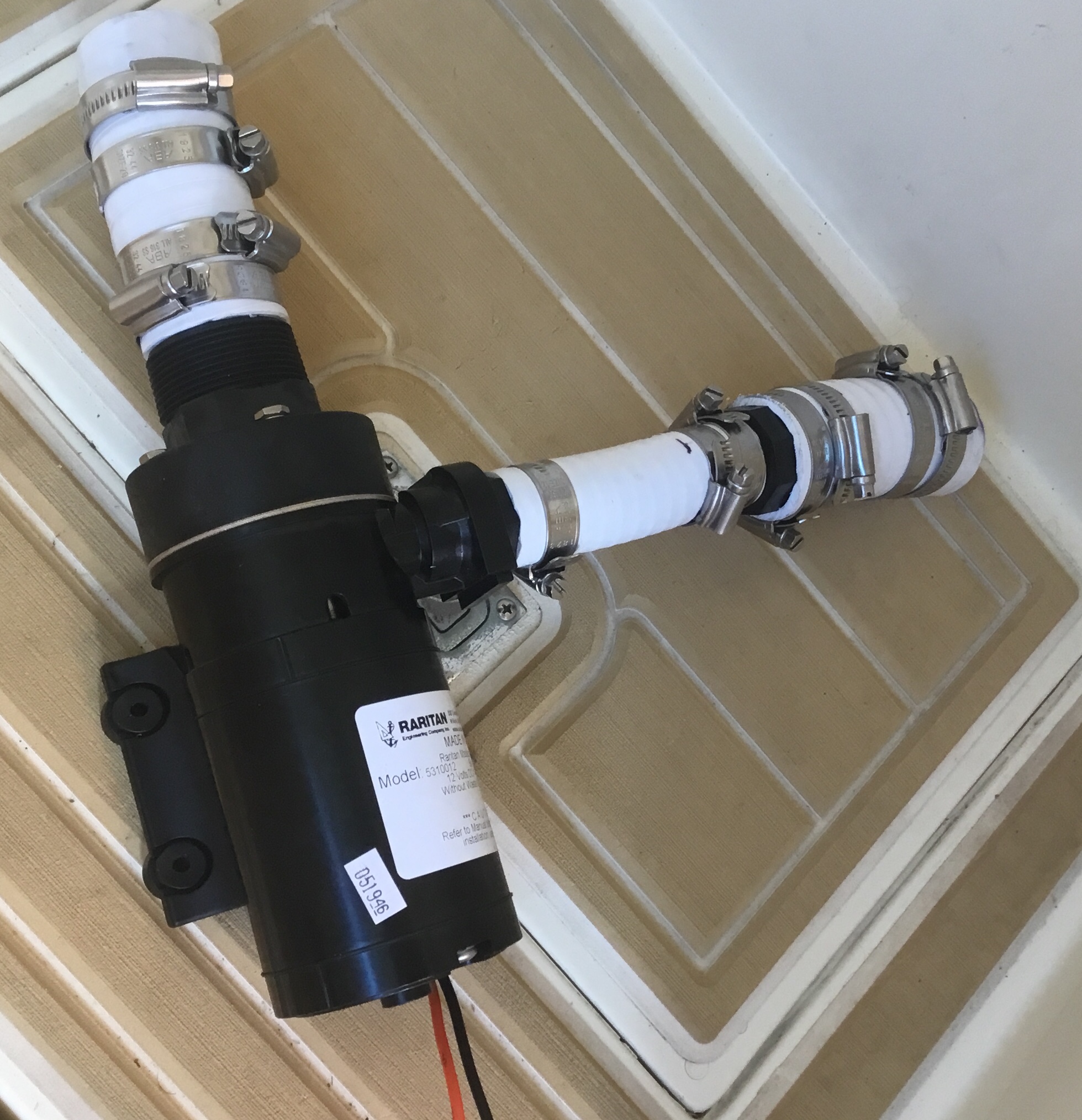

    The Jabsco Motor/pump is about 2.5-3 years old, if that.
    Replaced just before I bought the tub 2 years ago.
    No visible corrosion, wiring and power good.
    Probably an impeller problem, lack of use: Guesstimating 3 minutes each pump, 10 pumps per year. Rotten impeller and internal corrosion, maybe.
    No point in buying the cheapest macerator pump on the market, same problem over and over again.
    Been replacing and even overhauling these $110 Jabsco pumps on client’s boats, not my fondest memories.
    Would rather pay twice the price on my own boat for something that will last longer and work better.
    Hopefully this Raritan will do just that.

  10. Norseman
    Norseman Senior Member
    Feb 24, 2005
    3,598
    Palm Coast, Florida
    Almost ready for installation of new pump and new plumping.
    The surgery is being done through a small opening: Picture.
    Took me 2 hours to get the old pump and hoses out and disconnected, laying flat on the belly with a flashlight strapped to the noggin and sweating like a 220 lbs pig. :(
    Installation should be easier, 1/2 hour max..:rolleyes:
    Something to be said for bigger boats and more space..
  11. Capt Ralph
    14,582
    Looks just like a Jabsco pump to me.

  16. Beau
    Beau Senior Member
    Jan 15, 2010
    2,261
    Beaufort, NC
    Missing a double clamp on the inlet? There is also a soloution that uses bacteria to target the waste in the hoses. I think its a Raritan product? CO something....
  17. Norseman
    Feb 24, 2005
    3,598
    Palm Coast, Florida
    I knew some eagle eye would see the single clamp..
    That particular barb did not have enough real estate for a double SS clamp.
    I tried and measured, but forcing 2 clamps on a shortie could do more harm than good.

  19. Norseman
    Feb 24, 2005
    3,598
    Palm Coast, Florida
    Not sure I need it.
    You get calcium buildup in the hoses if not pumping enough. On my tub I counted 18 strokes minimum on the handle to empty the discharge hose.
    Instructed guests and crew to do minimum 18, but bonus for 25 pumps.
    (Learned that the hard way on previous boat. Calcium clogged up the hose and caused the famous exploding head..:()
  20. Pascal
    8,950
    At least he used the good stuff. Solid band.
