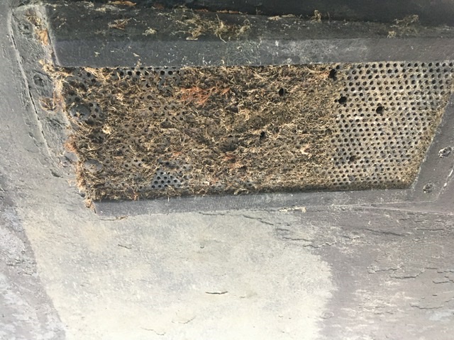

    my engines were running great until two weeks ago temperature was 175 no matter the RPM.
    Port started going up to 185 when I got to 2200 RPMs last weekend.
    Now I see why I hate these screens but I have to live with them for now what kind of paint can I put on these to keep them clean any suggestions? B1995C80-226A-444C-9D2D-BD6B6DB8F65A.jpeg

    Bottom paint.....can even use bottom paint in the spray can......first see what drill bit size is just a touch smaller than the holes.....As you'll have to clean some of them out after painting.

    OK thanks I just pulled all three of them scrub them up clean them up and use an Allen key to clean the holes I’ve got paint in a spray can I’ll give that a whirl
    Trilux 33 Interlux I hope that will work

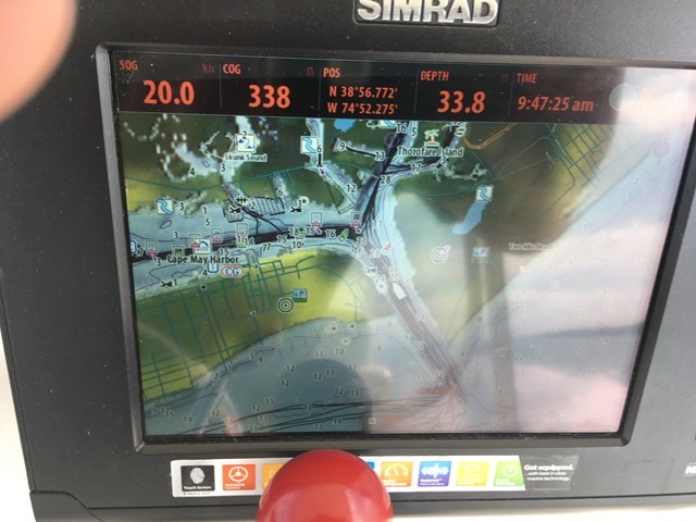

    here you go today’s solo sea trial information;

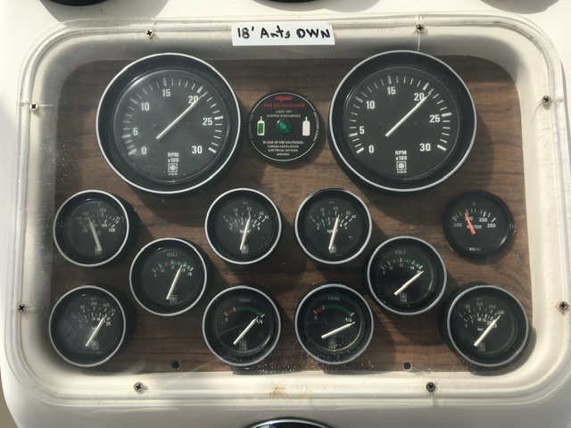

    Motors are back to 175/180
    Yes my voltmeter starboard side is broke it’ll stay that way till I get to it.
    I’m taking a month off from working on this I’m taking a month off from working on this SOB! 2A68A30D-9C65-46F1-90F9-E4CA5F2C92F9.jpeg
