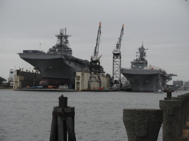

    I just came back from Hampton Roads where I saw this. Should imagine the same thing would work fine for the Costa Concordia.
