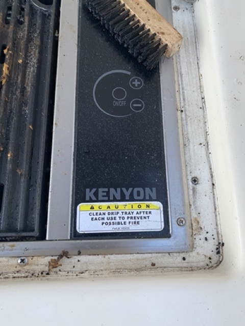

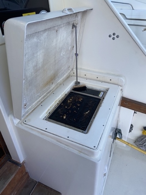

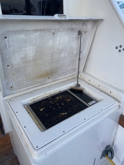

    Sorry for the delay guys- here are the grill pics. It's a mess because of cooking striped bass we just caught on it.

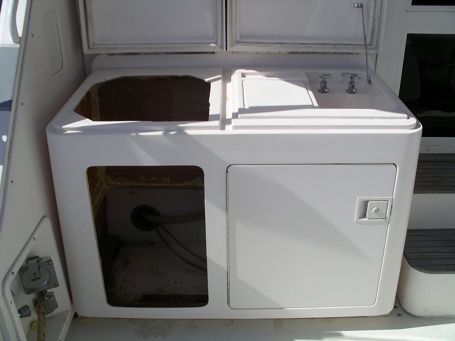

    Super. Now I just need to find someone that can duplicate a fiberglass door for the lower face of my cabinet where I'll probably add either shelves or additional tackle drawers.
  7. Stainless45
    Stainless45 Active Member
    Jul 19, 2019
    173
    Post 46 Long Island NY
    Yeah the grill has minimal depth, so a lot of space is now available below it where the freezer used to be. I'd like to do the same

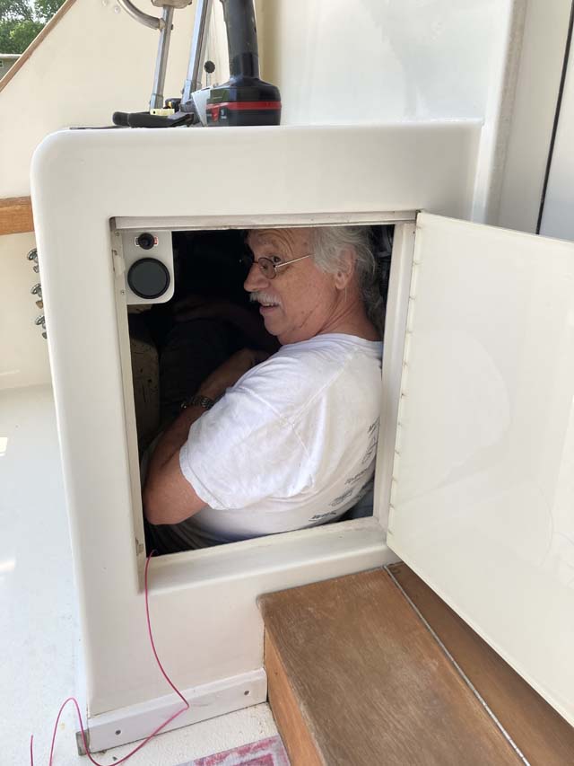

    I had someone look at mine yesterday and if an aft facing opening was CAREFULLY cut, the piece cut out can become
    a door and then this entity will custom build the interior for shelves or drawers.

    The doors on my cockpit cabinets are actually clear acrylic painted on the outside to march the cabinets. Can see the screws inside the acrylic on hinge edge.

    Mine too! Hoping to be able to cut out nice and neat like SplashFL mentioned and do something with the space

    One option: Undercut the opening by about 1/4-3/8". Make a carefull wood template and clamp in place, then ease up to the final cut using the template with a sanding drum so won't chip the gelcoat. Can cut a ring, or use 4 separate strips, to bond inside to get thickness for a nice internal lip.

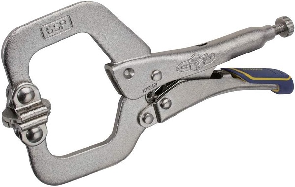

  13. Capt Ralph
    14,547
    When it comes to thin materials, this is done on all of my projects.
    I use big welders vice grips, to clamp with and scrap wood.
    Welders vice grips are also used for my many epoxy / glue jobs.
    I luv the floating pads on the contact jaws. Don't gouge the work.

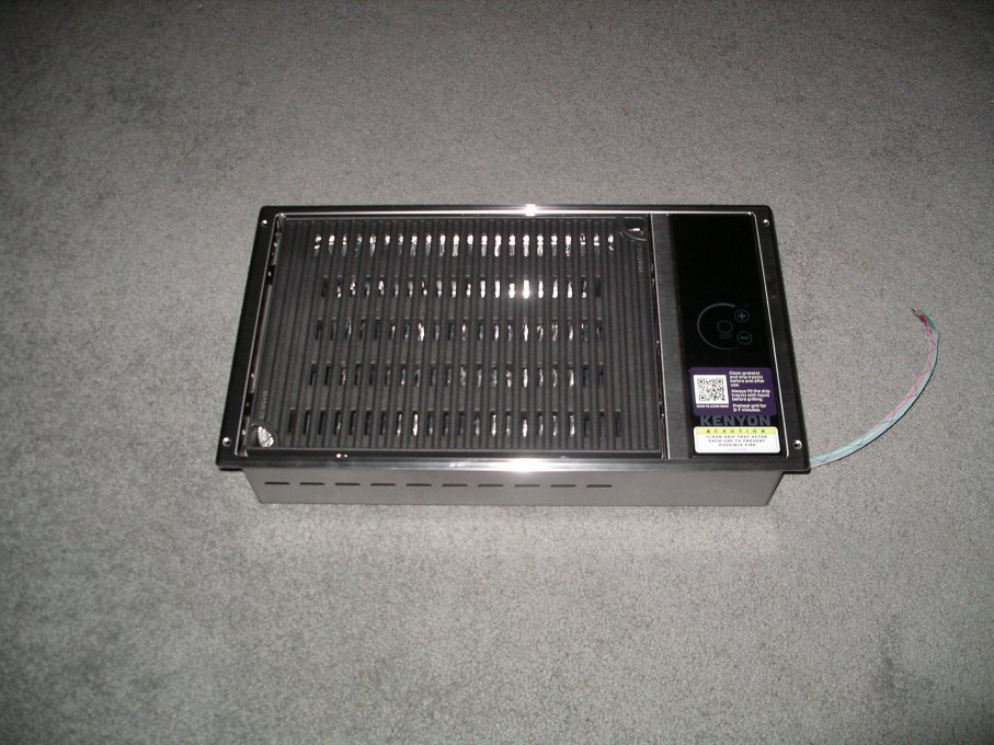

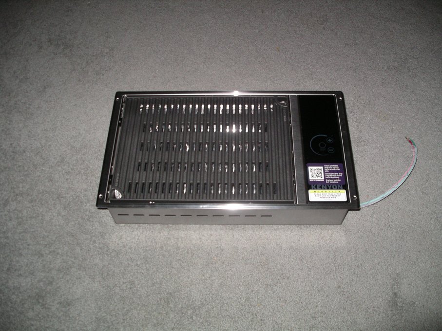

    Grill finally arrived. Only draws 6 amps on 220 v. Have a couple extra 220 breakers so only fresh fish will be needed.

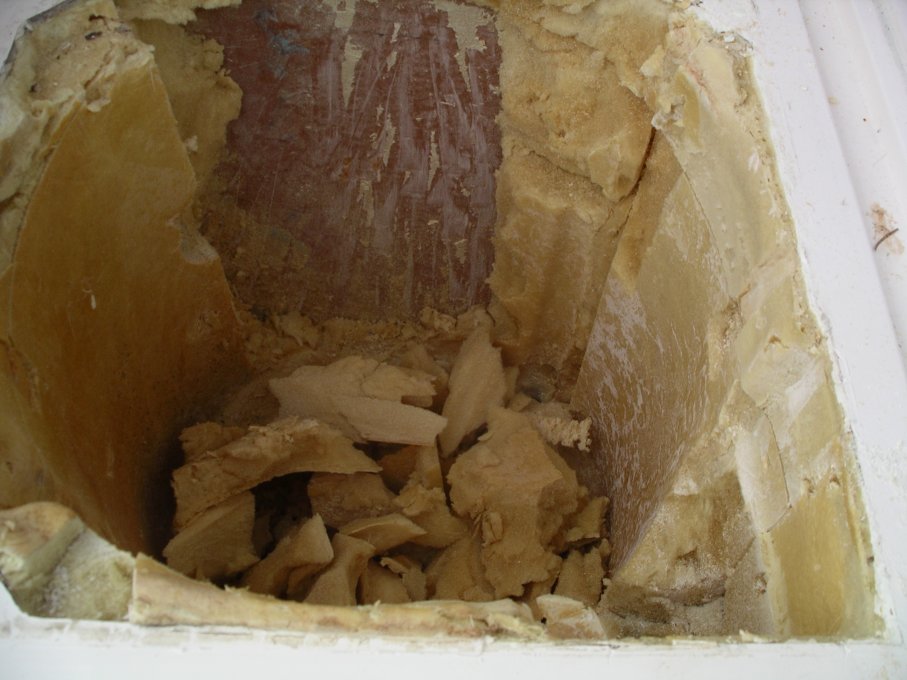

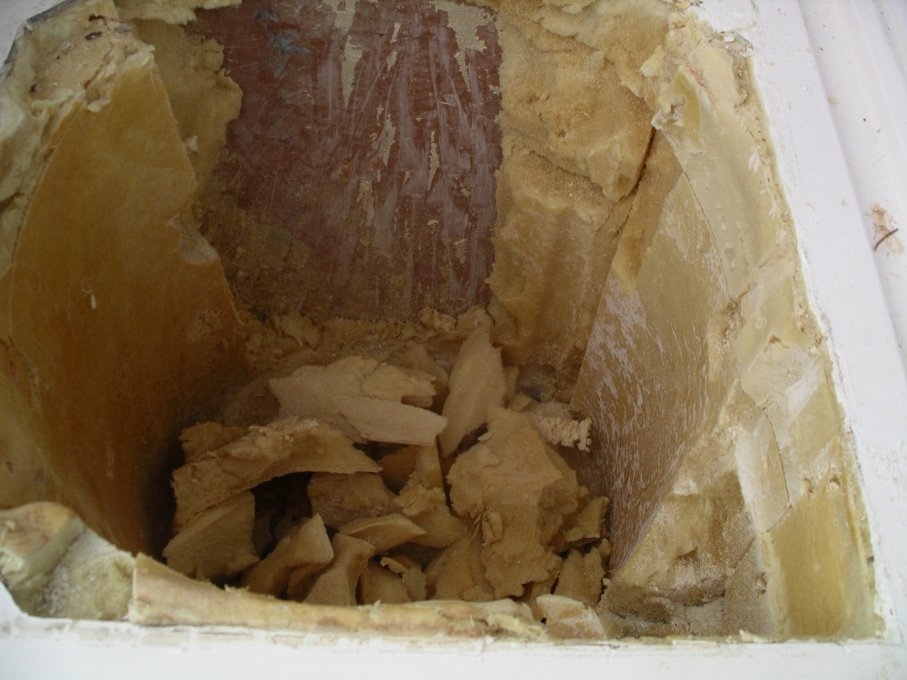

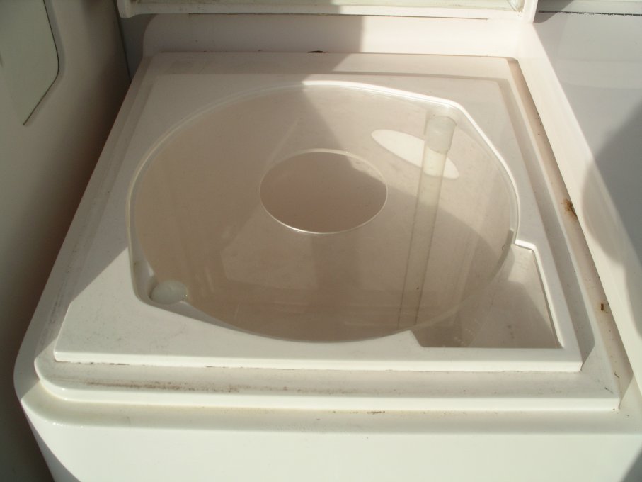

    I'm making room. I think I read someplace Weber, and others make portable electric grills which are popular with those in apartments that don't allow anything flammable. Since I don't live bait fish this grill is replacing the unused live well. Two plus hours so far and still tearing out. If Bertram built the rest of the boat as they did this thing she should last as long as the planet.
    Evidently they foamed the round well into the box with no thought of the poor guy that might some day want to remove it so had to cut it and all the plumbing into a bunch of pieces to remove but still dealing with the foam removal.

    So the new grill is 220 v. draws 6 amps and the paperwork says install with a 220 v. GFCI. Only ever seen them for 115 v. so anyone have suggestion ??
  19. chesapeake46
    chesapeake46 Senior Member
    Jul 26, 2009
    1,874
  20. SplashFl
    SplashFl Senior Member
    Feb 2, 2021
    725
    S. Florida _ Bertram 46
    No idea what brand panel Bertram used. Wards Marine Electric in Ft. Laud. wrote they could supply a GFCI set up so will speak with them Monday. In the mean time the piece that was cut out will become the new door. Hunted all over for a matching white latch but only found a stainless one on Amazon so may replace the two existing ones if its exact size.
