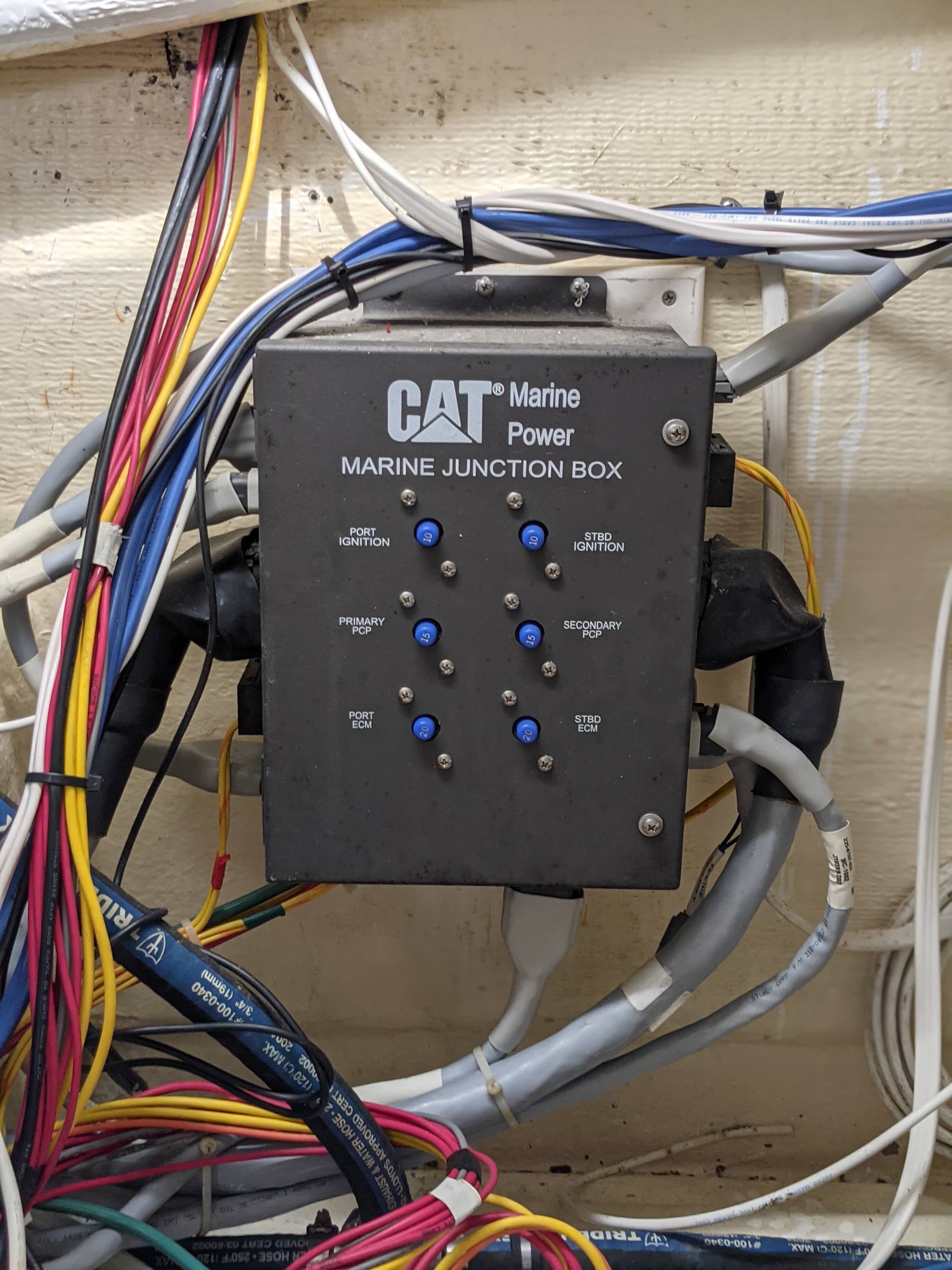

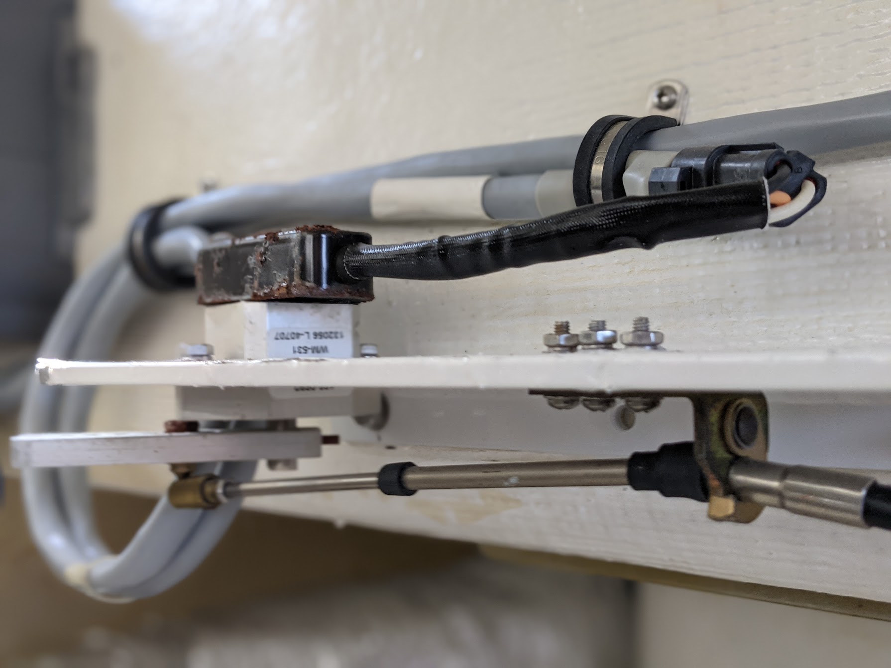

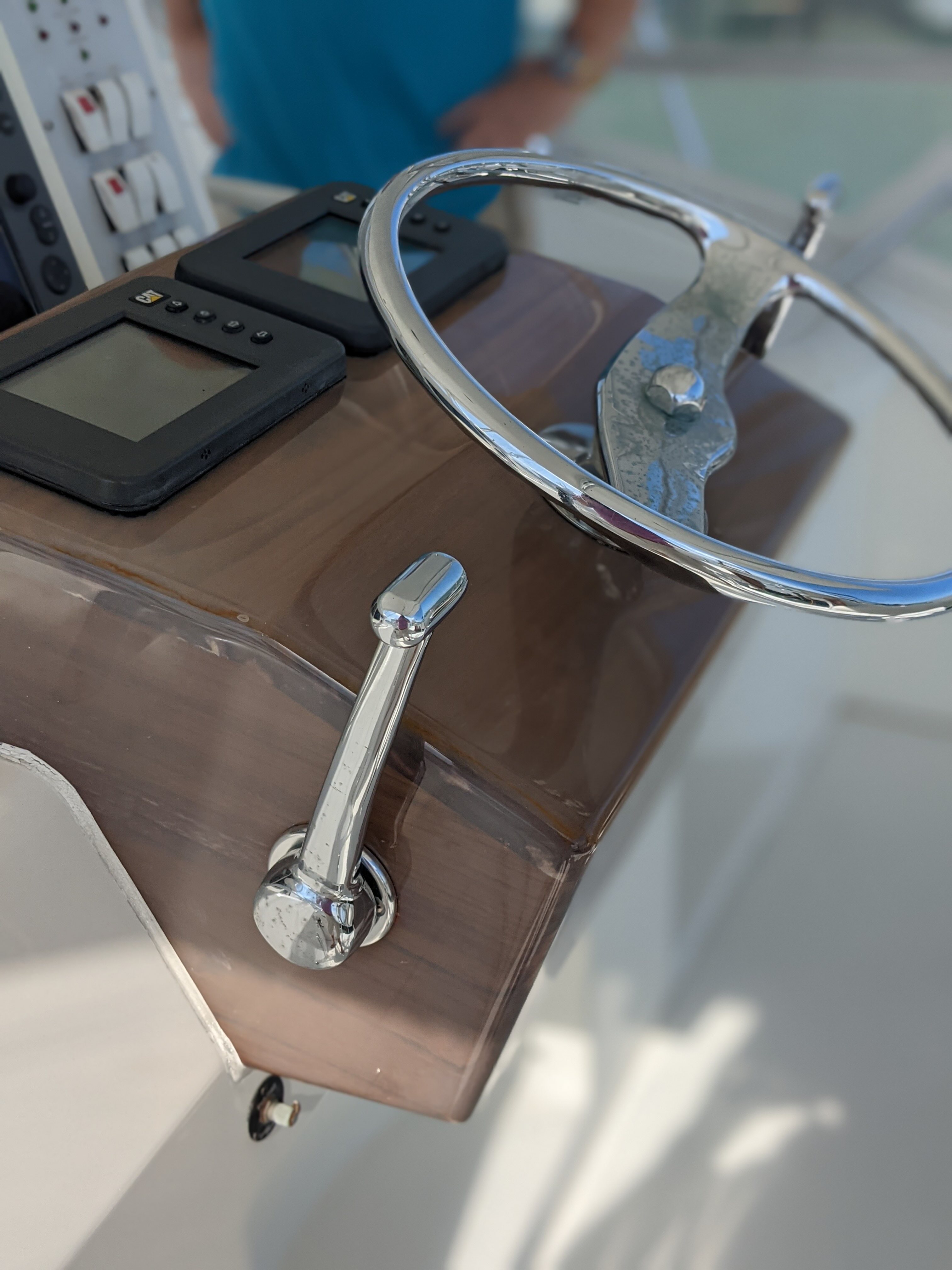

    Regarding mechanical or electronic controls some pics:
    My Palm Beach controls
    CAT junction box under helm, I do not see the ~4awg from the APS connected here. What's PCP?
    Pic from under the helm, pretty sure this is the mechanical connection from the throttles (one for each side) to the CAT electronic controller. No MicroCommander box in site.
    Confirmed with my mechanic, the Throttles are electronic (CAT), the gears are mechanical.
