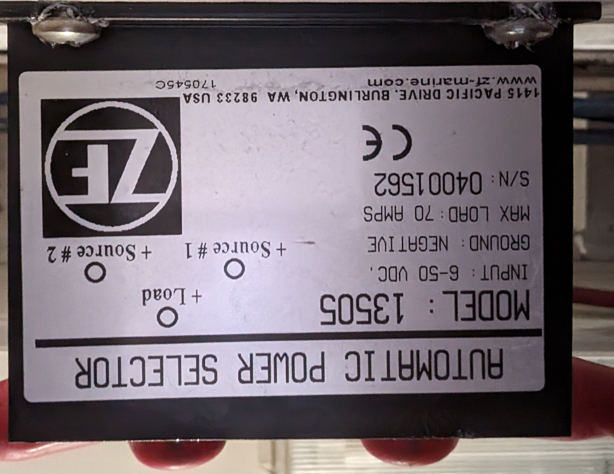

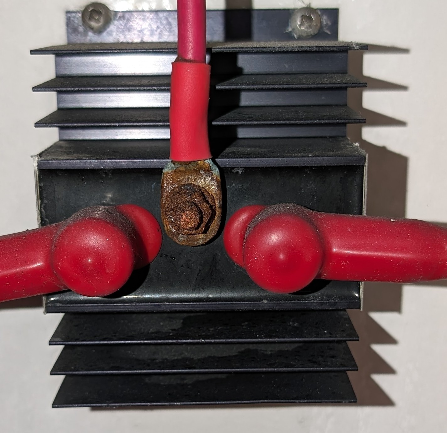

  3. Bayhouse
    Bayhouse New Member
    Oct 11, 2020
    46
    Brigantine, NJ
    Back with an update, was on the boat again today and traced the wires from the CB - that transformer is NOT related to the APS circuit (no light issues either).
    Found the attached is in-line - and it looks like the load wire might run up to the panel - that's gonna need to wait for another day.
    Haven't had a chance to search the interwebs for this device yet.
    CB's are the push button type, 30a on each batt.

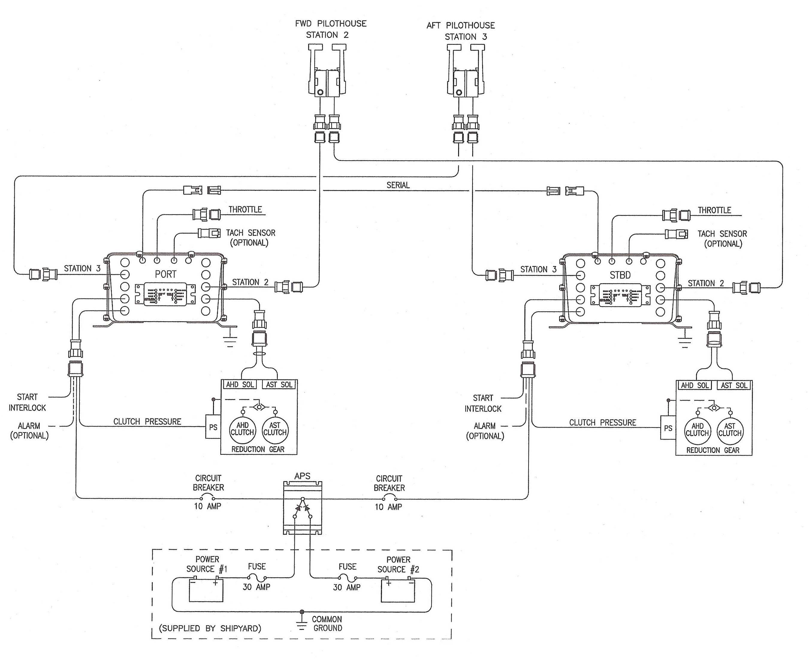

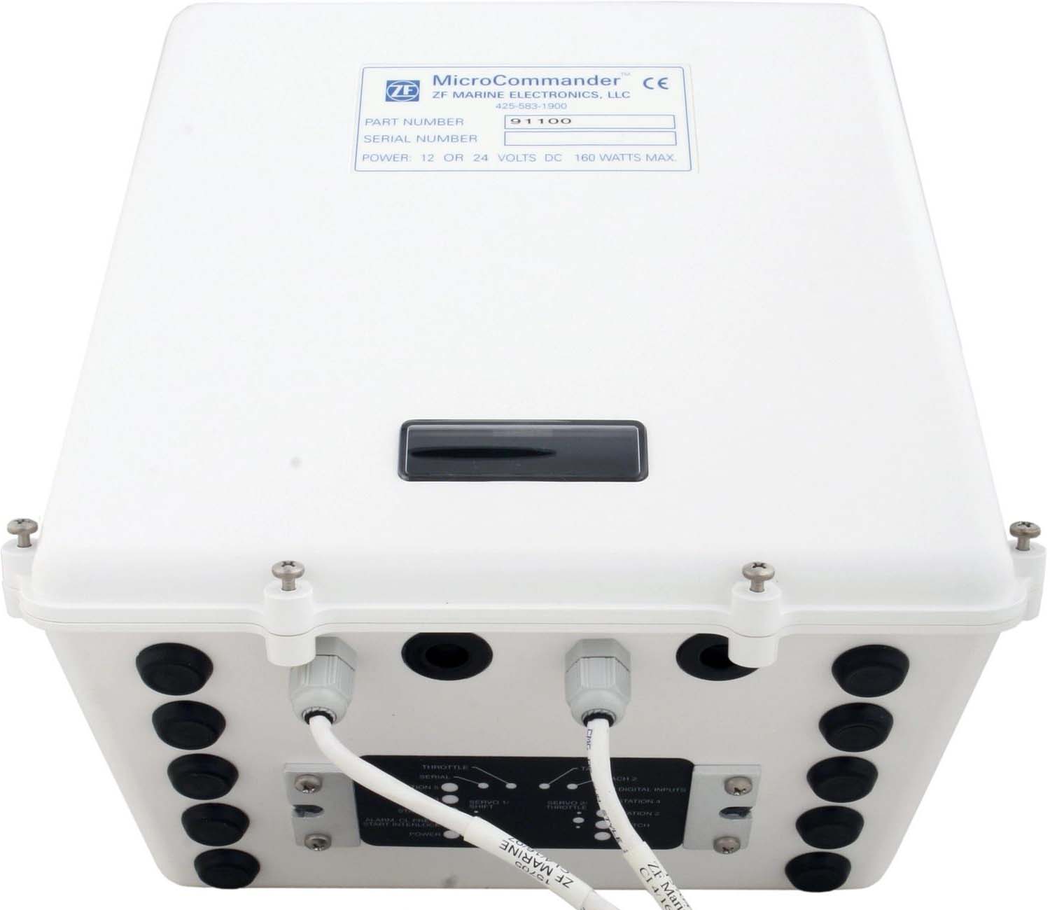

  8. mapism
    mapism Senior Member
    Aug 9, 2008
    2,297
    Sardinia

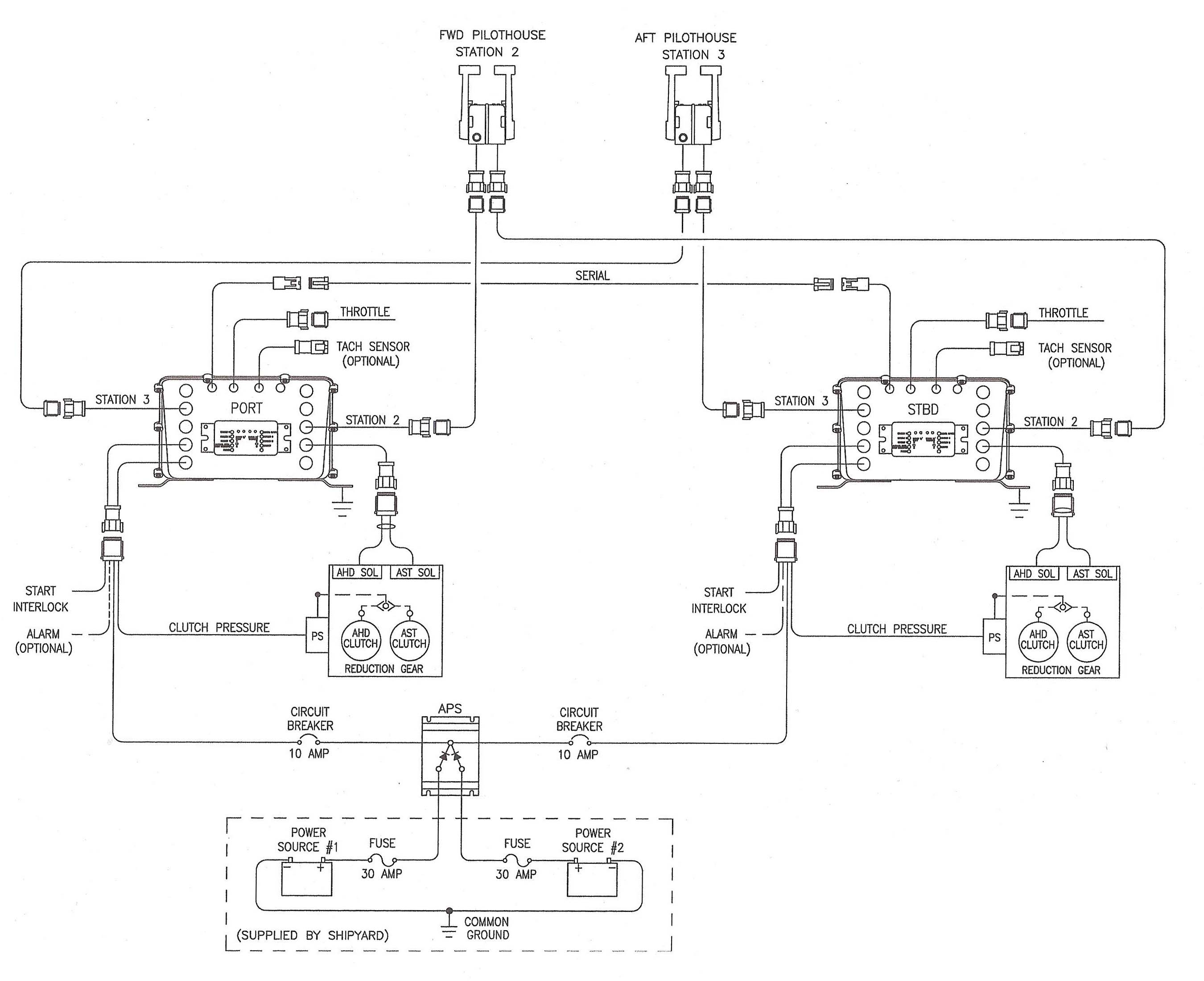

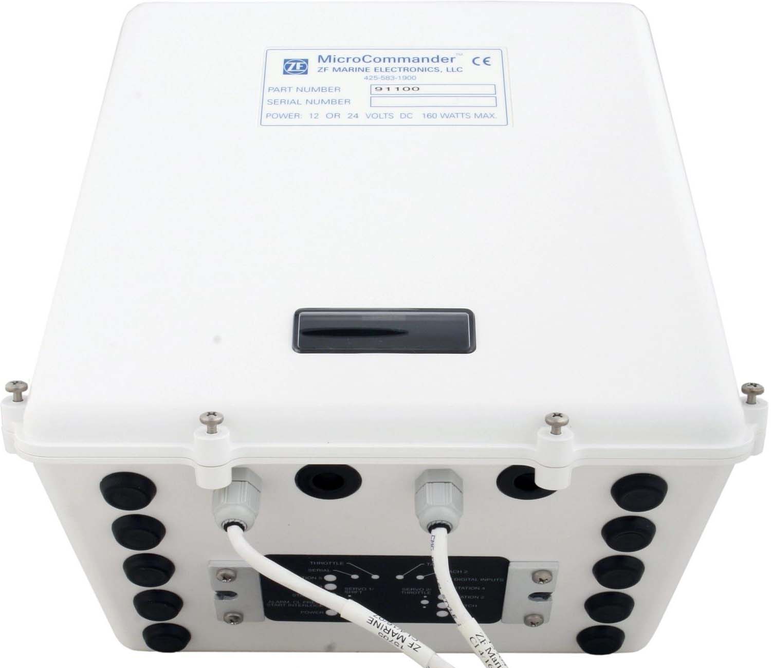

    Pretty sure there is, and I struggle to think of how your previous boat could have worked without it.
    I attaching below a photo of that box, which is usually (though not necessarily) located in the e/r.
    You might be interested to check out also the following diagram, which shows both the very same very actuator box (seen from its bottom), and also your APS unit. The diagram is meant for dual station, but you can easily work out how it would look like with a single station.
    BTW, just in case you'd wonder why in the diagram the two stations are called 2 and 3 instead of 1 and 2, that's just because 1 is meant for an e/r station, if present.
    Anyway, if the APS unit and its breaker are connected according to the following diagram, and the breaker doesn't stay on for whatever reason, I'd expect your levers to be completely dead.

  9. Capt Ralph
    14,578
    Wow
    Brother mapism found the grail*..
    Brother mapism drinks better than just a beer.
    * The object of a prolonged endeavor.

  16. Bayhouse
    Bayhouse New Member
    Oct 11, 2020
    46
    Brigantine, NJ
    Great diagram, I think there's clearing on the horizon!
    My prior boat (an OB express) had a micro commander box similar to the one in your diagram and had 2 stations, helm and tower. In fact, I removed that box and controls when I re-powered the boat (digital controls) but don't remember seeing an APS in-line. Hope the guy I sold it to figured out something was missing, he never came back and asked....
    I don't recall seeing a micro commander box on this boat, but in fairness there are a bunch of control boxes in the helm console that I just assumed were related to the CAT engines (I know for a fact several of them are). I'll climb in there and start poking around.
    In your diagram, my use of the term CB is in reference to the 30amp fuse between the batteries and the APS. I did not see the 10amp circuit breaker leaving the APS, but it may be closer to where the load wire terminates (thought it should have been closer to the APS though).
    This diagram also seems to point to the APS having no bearing on my electronics resetting when the engine starts. Note, I am careful about the start sequence at the dock, but often when out fishing I'll power down the mains while drifting. When it's time to restart I forget about the shutdown.
