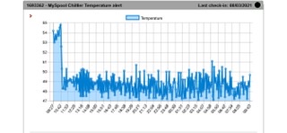

    36 hours ago, I switched to the nr 2 sea water pump and the breaker has held for 24 hours. Coil temps have dropped 5 to 7 degrees. The more I think about it the more I suspect the nr 1 pump is tired. Going to pull it and check the impeller.
    Yesterday was overcast here in Miami so chiller nr 3 was cycling on and off as needed :

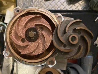

    I pulled pump nr 1. Impeller shows some erosion and the two holes are slightly bigger than the spare shown in the picture.

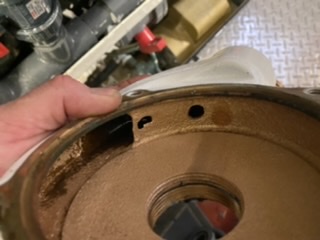

    what I am questioning are two holes in the pump body in pic nr 2. I ve never opened one of these before but can only guess they have to affect flow. I doubt they are meant to be there.
    DD235E93-07C9-4FAF-9DFB-32B91C6CCAF2.jpeg 8B70D84C-8F26-40A7-AA78-9F821B5C3184.jpeg

    Pascal, those holes are to let air out of the pump volute when shut on and off..many manufacturers put them in general purpose style pumps so pumpsbdont get airlocked on start..minimal performance loss.. so I am unsure if you have chilled water or freon going to the actual airhandlers in the boat..the Temps you give are for the seawater heatexchangers yes?
