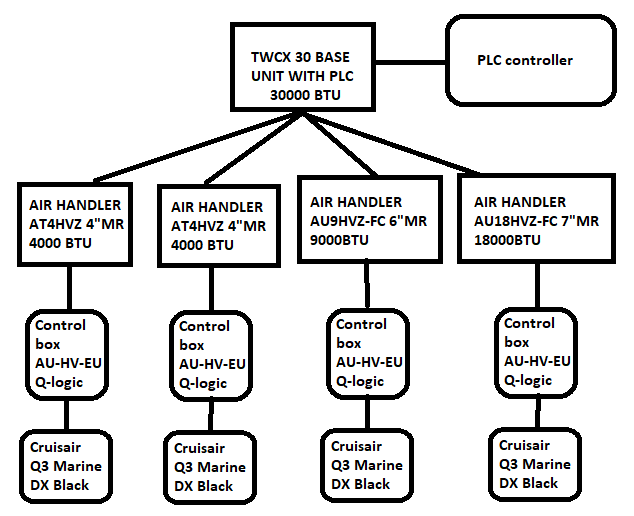

    I second Capt J's opinion... if you factor in the cost of not just the chiller but the air handlers, to only supply 35,000 BTUs in total, you'll end up spending less on 4 self-contained units… not to mention, a much simpler installation.
    If you do really want to get a chiller system, understand that Dometic isn’t the only brand out there that makes a decent chiller. Webasto has a titanium line, as does CTM Marine: https://citimarinestore.com/citigui...mpare-to-dometic-and-webasto-chiller-systems/
    I’ve heard good things about Flagship as well.
    They’re comparable in construction / quality, and less expensive in most cases.
