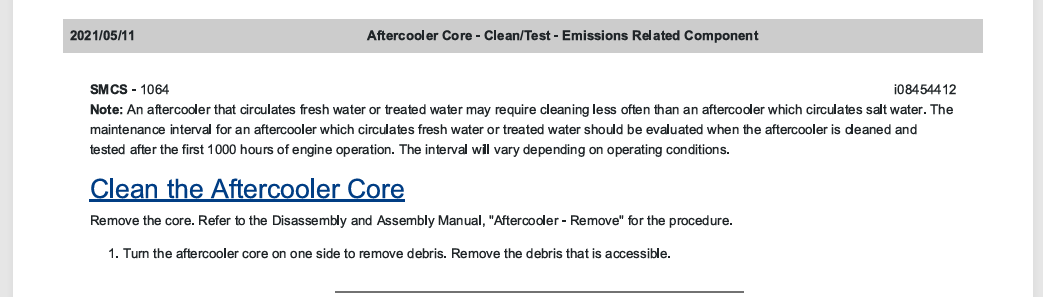

    The Cat guidance is 6 years replacement and every 2 years removal and pressure test for salt water use. For fresh water they recommend removal clean, pressure test and inspect without the strict 6 year replacement requirement. My current boat has C-18s and was in Wisconsin for several years, without aftercooler replacement, so I had concerns and wanted to build replacement costs into the purchase. I was provided Cat documentation explicitly stating the fresh water guidance which I can post if you want.
    When I took ownership, the first thing i did was have the aftercoolers out, cleaned and tested. As it happens one had been replaced 4 years earlier and tested fine so I kept it and replaced the other. After 2 years they will come out again and I will relace the other one as it will be at 6 years since new. I did have my mechanic rebuild the heat exchangers and replace thermostats to be safe and thorough.

    Here is the snip from the Cat document
