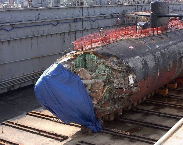

    Most of this is obvious from the photos except the extent the rest of the hull is affected. I have to say that this boat did hit something... ...water.
  15. SandEngXp
    SandEngXp New Member
    Jan 29, 2009
    50
    Texas
    This is hitting something.
    sea mount at 500' +/- below surface.
