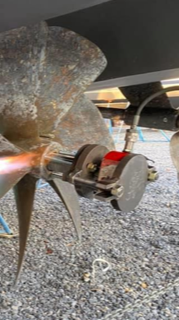

    Thanks brain trust! I made notes of all the do's and don'ts. One last question. My service guy wants me to call a local tech with this puller:
  7. Capt Ralph
    14,600
    I have to ask;
    After all of these attempts, How are the shaft end and threads holding up?
    I have witness the threaded end bent out of true also.
  8. d_meister
    d_meister Senior Member
    Mar 4, 2010
    516
    La Conner, WA.
    That's essentially like the set-up used in the video, so yes. Make sure there's plenty of heat arranged for it. Also, some way to keep the prop from flying off the end of the shaft. In your picture, the hub is too narrow to space the puller drilled holes far enough apart to allow for the nut to be on the shaft, it appears to me. You may be luckier in that regard and be able to have a nut on. Just a cotter key alone could shear, maybe.
  9. DOCKMASTER
    DOCKMASTER Senior Member
    Feb 26, 2012
    1,661
    Ketchikan, Alaska
    This type of puller should be a good option. You do run the risk of pulling the threads in your holes on the prop but if they apply enough heat they should jump before you pull any threads. Highly likely the cutlass bearings will need replacing due to heat damage. Do you have spares available or readily available near you?

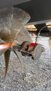

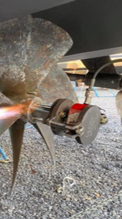

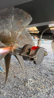

    OK so here is the update on removing my props!
    Hauled Monday morning to be out all week for bottom maintenance and finally get my new Veem props installed. We scheduled a running gear specialist from 40 miles south to come up a remove my props.
    Tuesday morning he arrives to remove and install the Veems. He installs a pretty beefy puller in the two threaded holes on the small prop hub. Torques it up and fires up his torch and applies heat to the hub. His assistant taps on the shaft end with a hammer repeatedly. After 45 minutes he packs up and goes home. Props still securely on the shafts.
