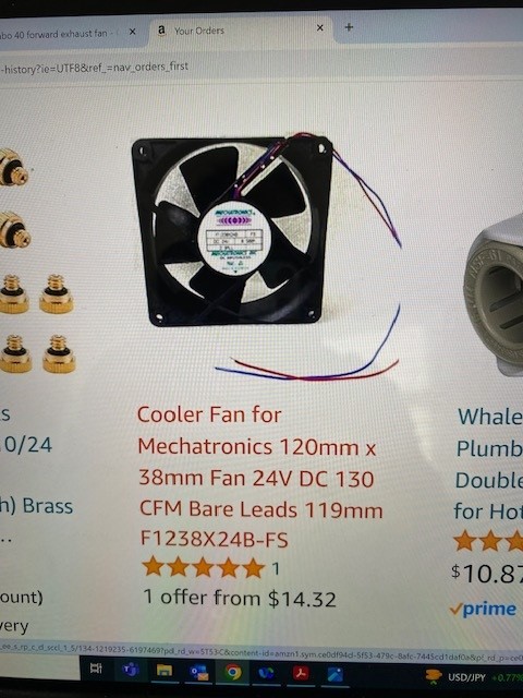

    Just checked both the guest and master head exhaust fans and neither function. Where did you find the replacement fans?

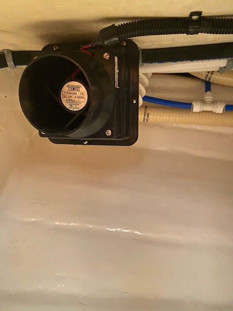

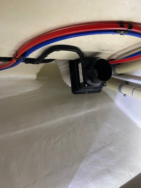

    Both exhaust fans for the heads replaced. STBD head exhaust fan - Cabo 40.jpg Port head exhaust fan - Cabo 40.jpg

    The fans for both heads are controlled by the bottom light switches in each bathroom. The fans are physically in the bilge area below each vacuflush toilet. The fans can be purchased on Amazon. I will send you part numbers tomorrow.

    See attached photo of the fans I purchased to replace both. You can see in the photos above you have to remove the the existing fans from the forward bilge area, disassemble the fan housings and install the new fans. The most difficult issue is the limited space in the forward bilge area.
