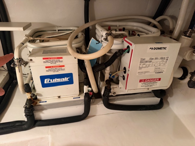

    My Cabo 40 convertible had two Cruisair units originally. The previous owner replaced the salon Cruisair unit with a Dometic unit. Both work fine on my boat, however the new Dometic unit is more sensitive to low voltage issues. Last summer I spent a holiday weekend at a busy transient marina with old shore power pedestals and the Dometic unit kept tripping on low voltage. All worked out well after we switched to a different shore power pedestal. The salon Dometic unit feeds the cabin air handler in the overhead and the Cruisair unit feeds two air handlers, one in each stateroom.
  10. Capt Ralph
    14,578
    They are all using the same compressor mfgs.
    Just the control boards may be different.
    The ol SMX and later U boards are programmable to lessen the low ACv false errors.
    You may consider this when working on 208ACv shore service again.
