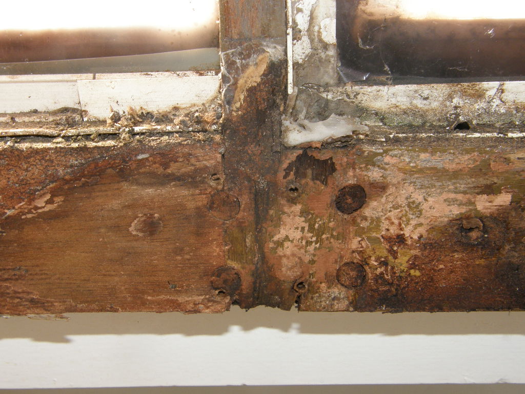

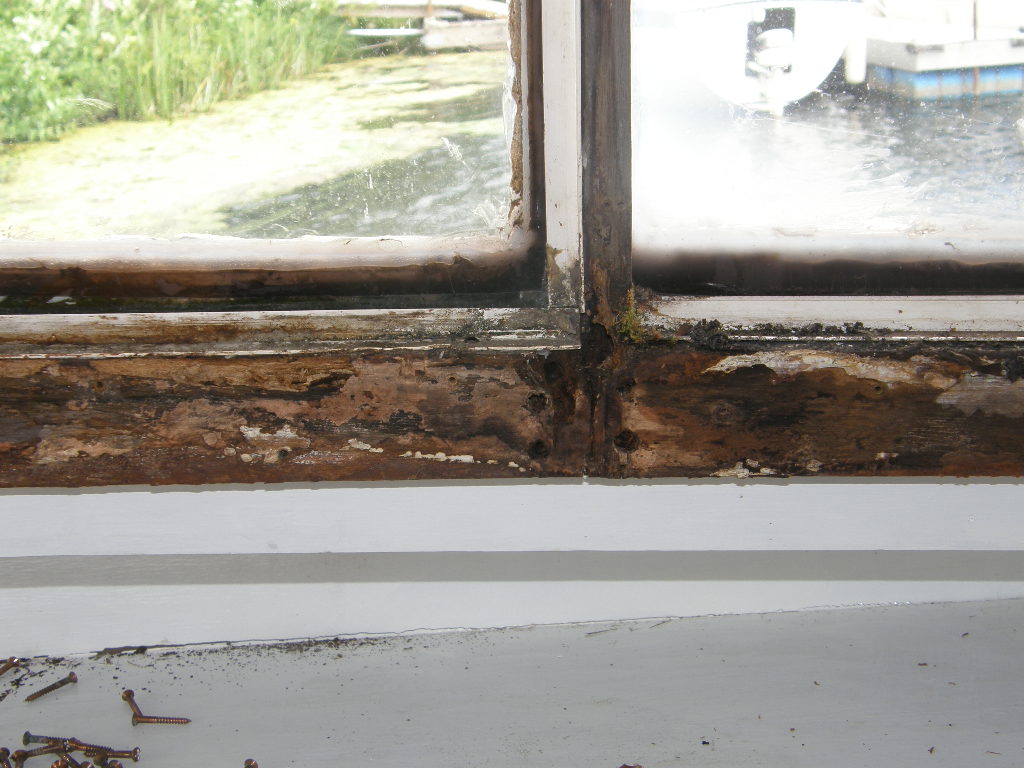

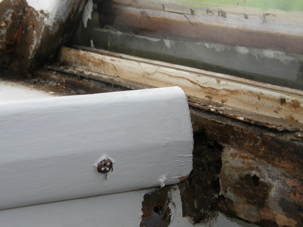

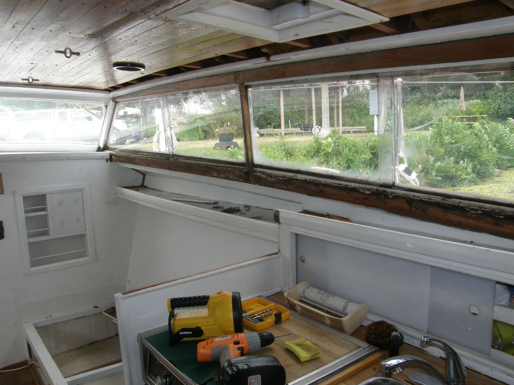

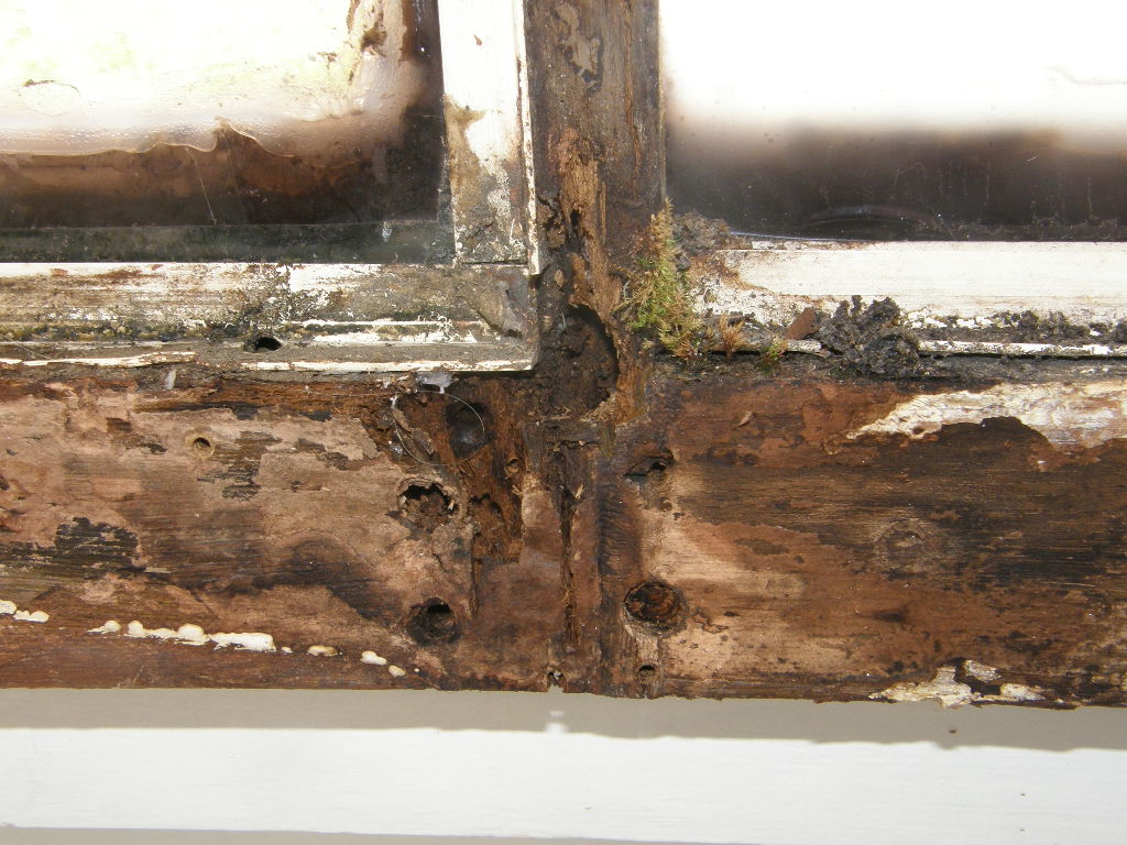

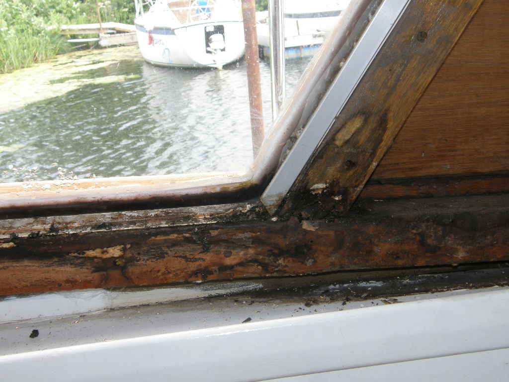

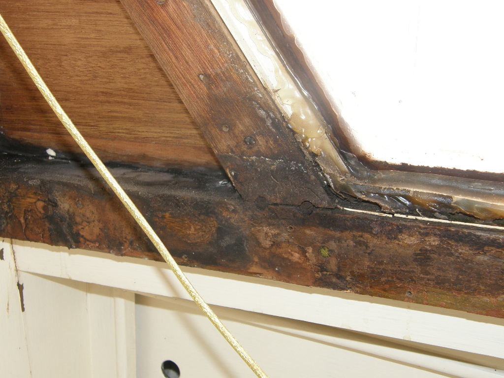

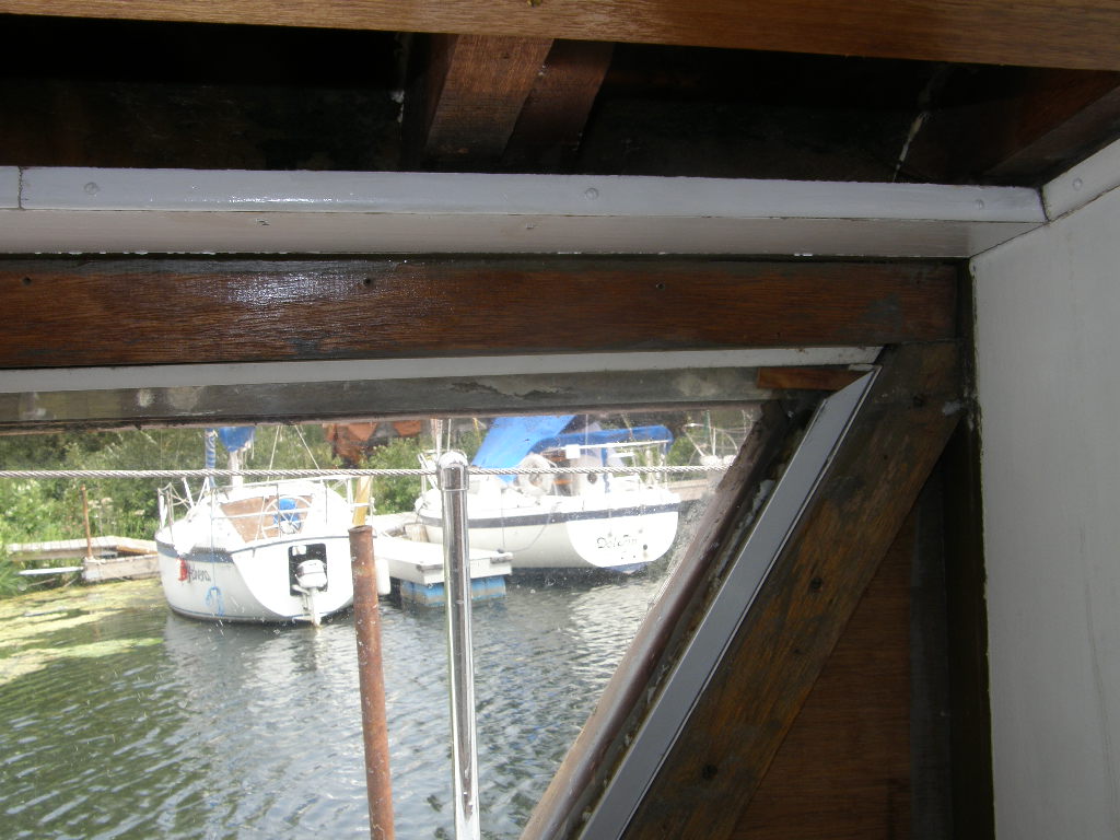

    Below are some pictures of water damage around the cabin side windows after the trim was removed.

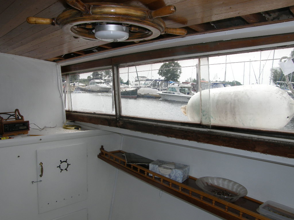

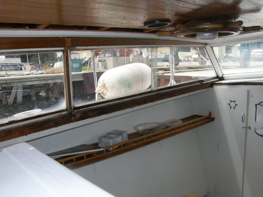

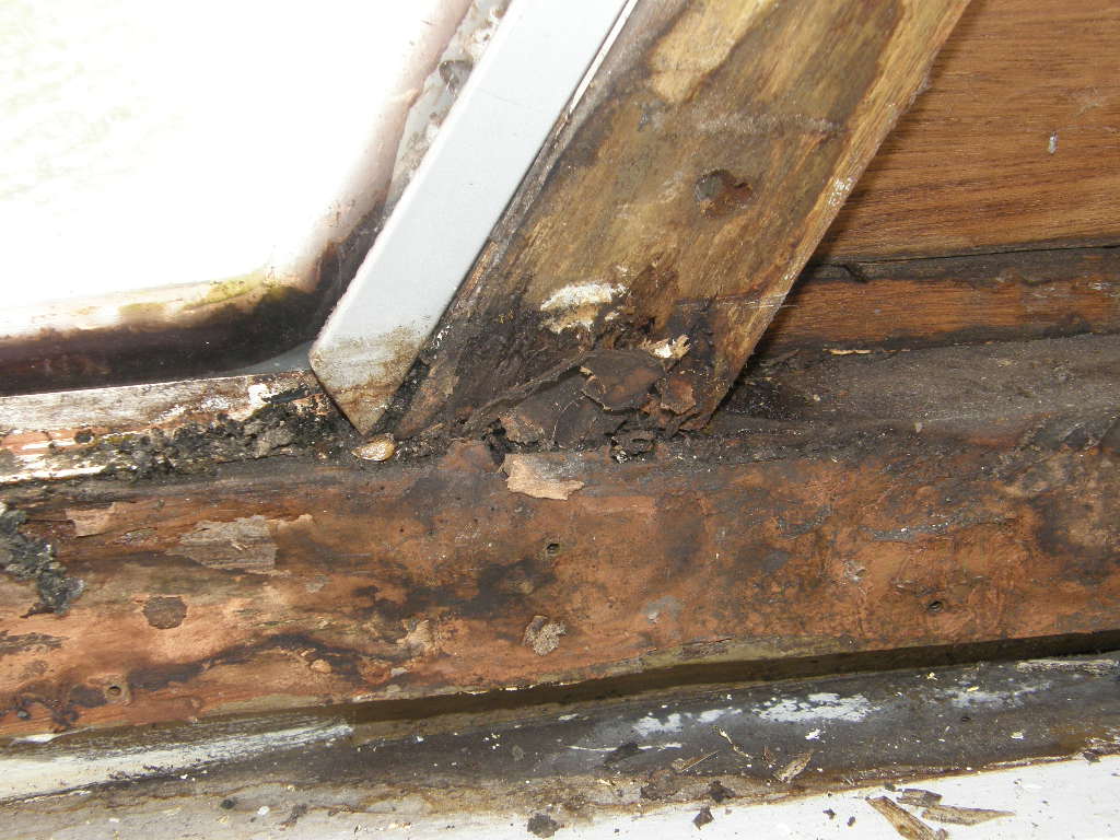

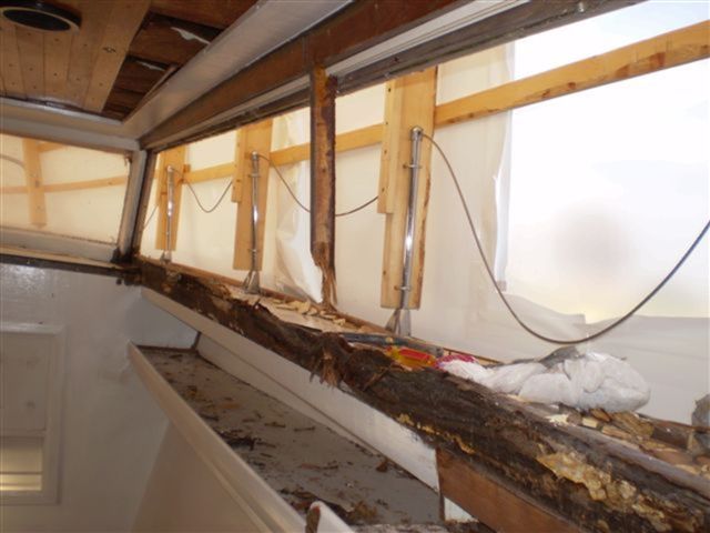

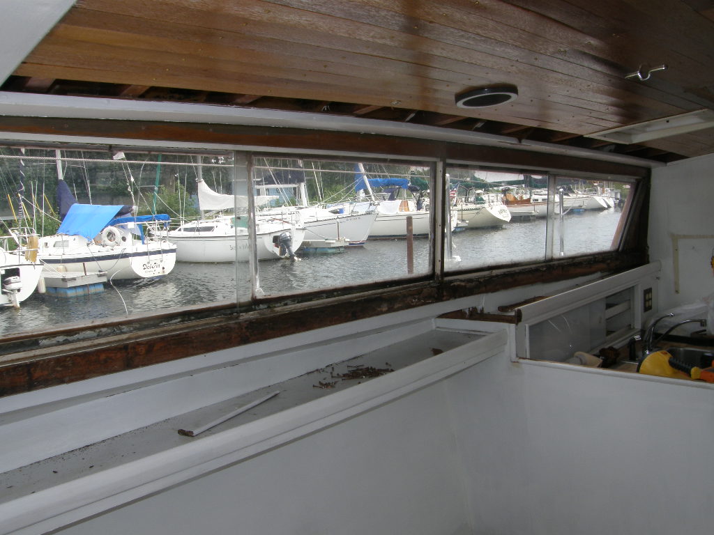

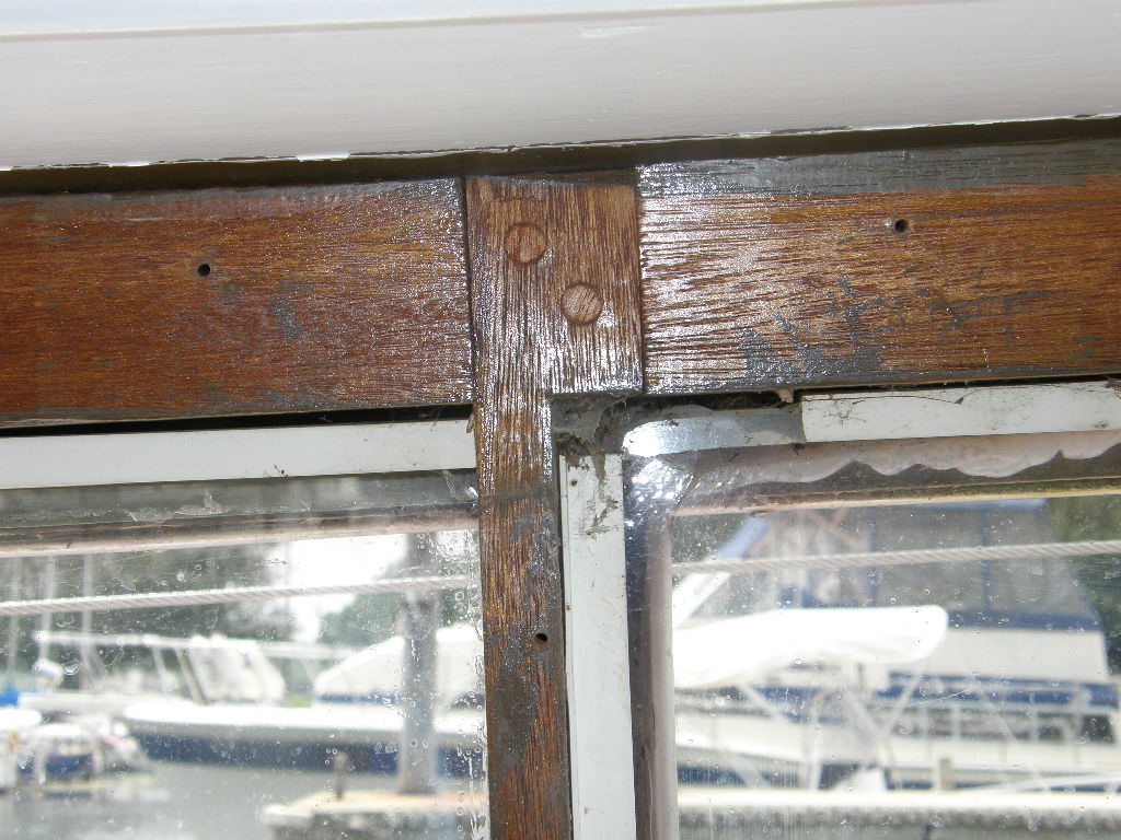

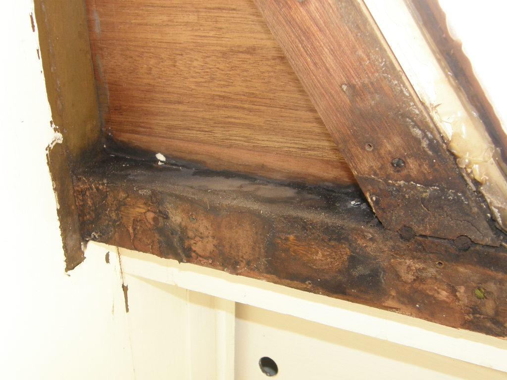

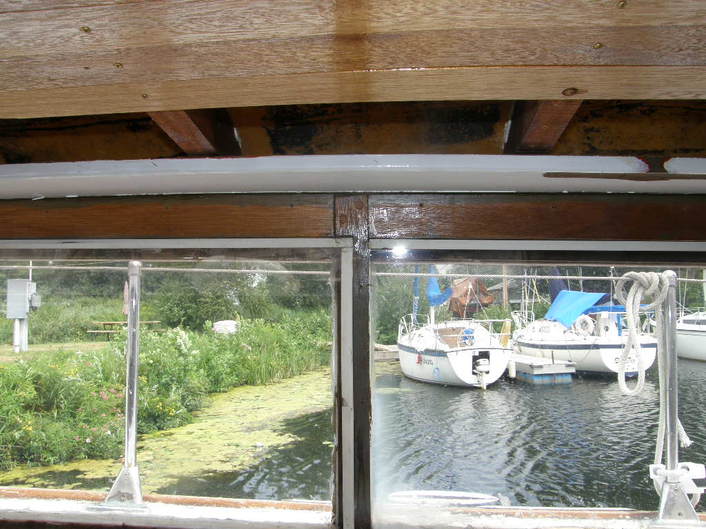

    More pictures

    Your pix really exemplify why shortchanging on maintenance is false economy. You can see all of that silicone that somebody gooped in the windows instead of taking them out and rebedding them... But hey, it's a beautiful old boat and you're doing it the right way.
    Who did you get to make your windows? I found a place to do the three bow seat windows on my 46 in aluminum frames, 1/4 glass, with an openable center window. $1375 sure seems like a pile of dough for three leetle teensy windows though...

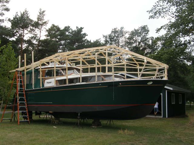

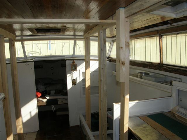

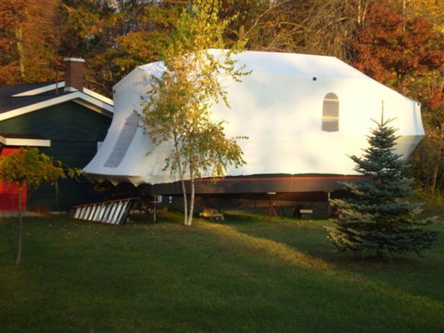

    Progress

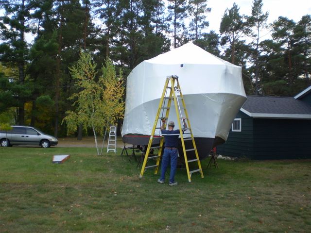

    We moved the boat 3 miles from the marina to John Winter's workshop. We built a support frame inside the cabin to hold the cabin top up after removing the windows.
    Then we built a support frame over the boat to hold the shrink wrap away from the cabin giving us room work on the outside while keeping everything dry during the winter.

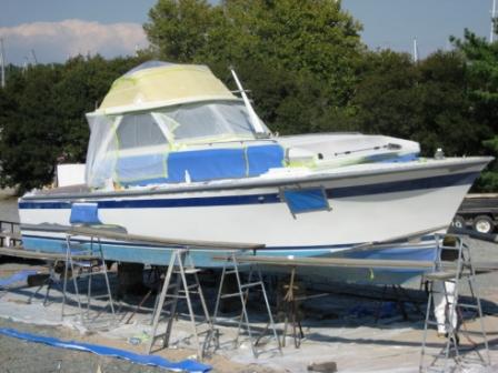

    The cabin windows on the starboard side have been removed. All of the wood on the lower sill will have to be replaced. The plastic vent cover over the galley has also been removed in preparation to remove the vinyl fabric over the cabin top and replacing it with fiberglass.

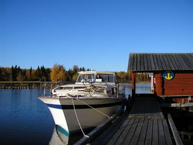

    Now the flybridge is off look better or?

    Mama get a hammer,...
    ..., baby's gotta a fly(bridge) on his head. :eek:
    Some love'em, others think not.
    Still others think the factory bridge could use some customization:
    http://www.geocities.com/super_roamer_38/FlyingBridge3.html
    All pretty valid thoughts.
    In any case, glad to see the Roamer flag being carried high in Scandinavia.
    Now, about that "extra" flying bridge - when's it going on eBay and how much? ;)
    You could definitely get a good (wooden) mast and set of rooftop hand rails with the proceeds.
