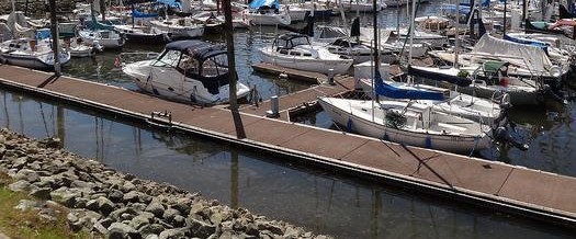

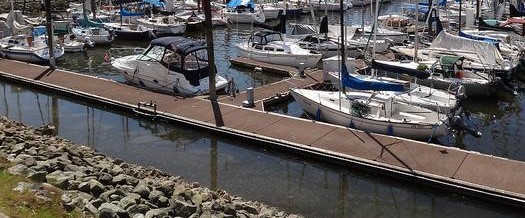

    This is off-topic, but about the holes in the dock: those look like floats made of concrete pods joined with wood waler boards, similar to the docks at a couple of marinas I'm familiar with. If they are similar, then the pods have little diagonal cut-outs on the corners that end up making a small "hole" but it's not big enough to get a foot into. You can sort of see them in this picture:
