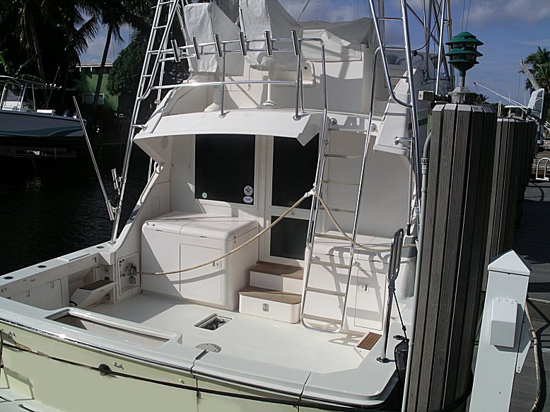

    The door on my 46, is 31 1/2 in. The opening was wide enough, using an A frame to lift it in two pieces through the never before used 24" salon floor hatch for the generator replacement. I believe it's centered as when the cockpit access E/R hatch-stairs are open they block access to the salon. Here is an old photo.
    LenR likes this.
