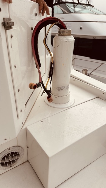

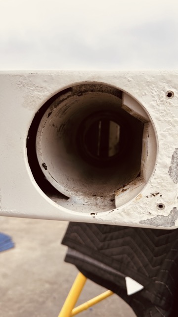

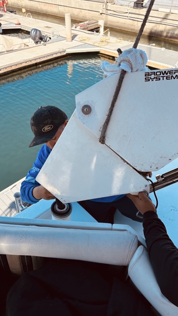

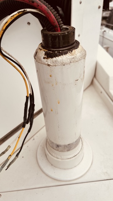

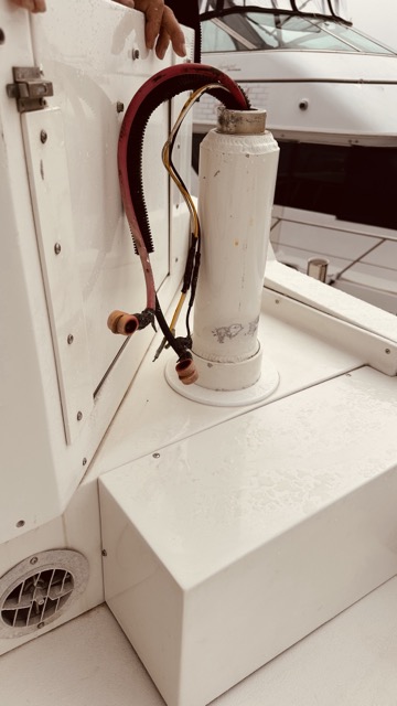

    The base of the davit. Nylon block is visible. I hope this wasn't overkill. IMG_3252 Medium.jpeg

    Thank you for the pictures, they help a lot. It sounds like people have a variety of conditions as one of the other posters had a nylon ring where your bearing is. Your install looks virtually identical to mine. Hopefully the repairs go just easy once I’m back on my feet again.

    First of all, thank you for posting the pictures. I have my crane disassembled, but it will not come out of the standpipe. something is stopping me from being able to access the bearing. Any Help would be appreciated. Thanks

    Not sure if you have the same mounting system. Mine has a clearly visible stainless steel bolt threaded into the base. I did have to remove that bolt to free crane from the standpipe.
