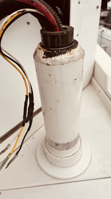

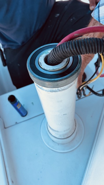

    I don't want to be "not cool" and I guess sometimes I just need a little push. Attached is the stand pipe with the bearing on top. I have a couple more.
    Dutch AdB likes this.

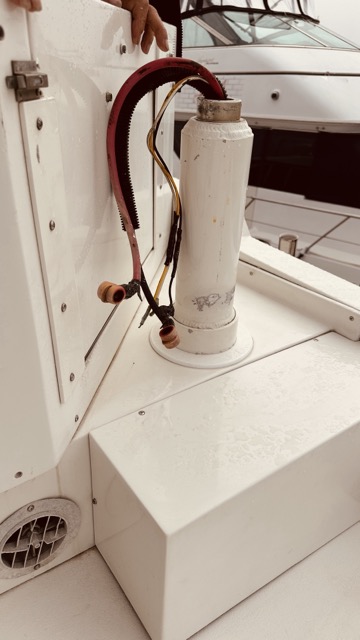

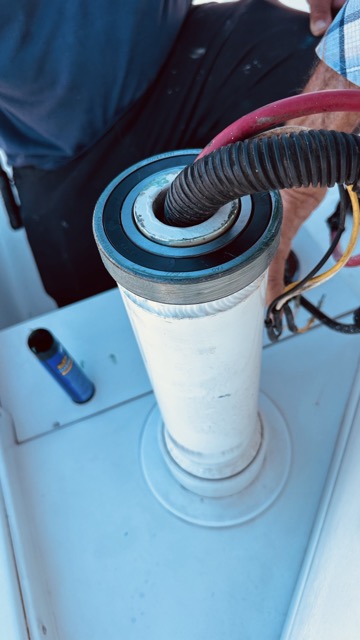

  20. Mixed Nutz
    Mixed Nutz New Member
    Apr 2, 2024
    9
    San Pedro, CA
    Stand pipe without bearing. The ring at the bottom indicates where the nylon block rotated around the pipe. IMG_3245 Medium.jpeg
