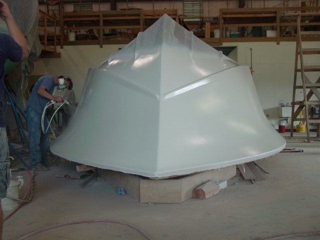

    You're going to have to come pick her up Capt J, I'm going to have to go to Africa to put the 41 back together after her freighter ride. The 37 is getting 550hp. QSB 6.7's and the 41 3-350hp. Verado's. Both hulls weigh under 6,000# right now (lot's of composites!) and will end up well under 20,000# wet weight, the size and power difference even out the speed numbers at 45 knots WOT. They were both laid up on the last hand cut jig I did prior to going CNC and lofted out from a plywood table of offsets.
    The venerable 31's chine is kept very full forward Far, in some conditions it made for a wet ride but they're known as bulldozers around here and would plow through anything you could throw at them. Because the power available at the time, their engines were heavy for their hp. but the weight down low made them stable as could be, albeit with a little roll. This is the 37 upside down, the chine is similar to the 31 being so full forward.

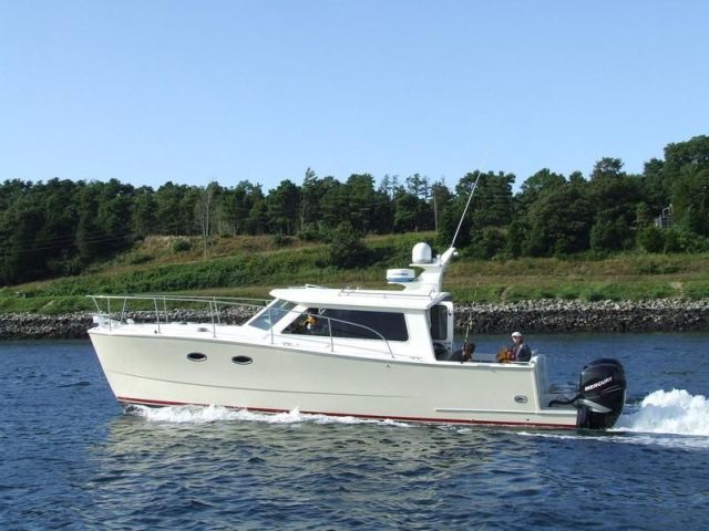

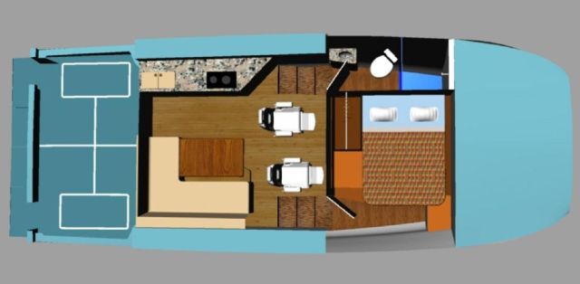

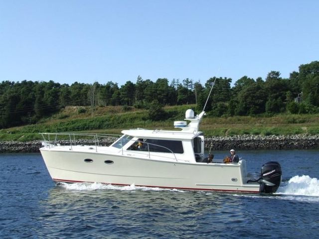

    Lets see, this is his 34 footer with the rear saloon enclosed. I like the 32 with the open design

    Bigger, bigger, bigger?? The point being made in many of the postings in this discussion is that many of the bigger boats (>31-35) are not the boats needed right now. There is a glut of cheaper used ones out there.
    What I have submitted is 32 & 34 design that fulfills that 'weekend desire' that many owners probably only have the spare time for. Or the retiree can afford, and probably only has the desire for. Its an efficient catamaran design that can be powered by outboards, or inboards. The catamarans have proven themselves to be quite seaworthy. It has a nice large aft deck like the Bertram had. It will likely handle sea as well as did the deep v Bertram, but with less rolling, and MUCH more efficiency.
    Plus it has a nice queen size berth.
    Perhaps the addition of a abbreviated flybridge could be done, but watch out for the extra windage. Its surprising how much windage there is with a 'tuna tower'.

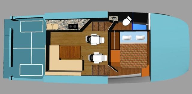

    Or how about this little larger 'weekender, picnic cat' I also included on that same subject thread
    Weekender/Picnic PowerCat
    This one could be constructed of 'flat panel' pre-fab honeycomb panels, or even epoxy glassed wood. Again outboard or inboard engine power,...small flybridge. Hey, it might even be aux sail-assisted power !!...(I'll have more to say on this one)
