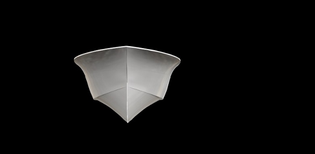

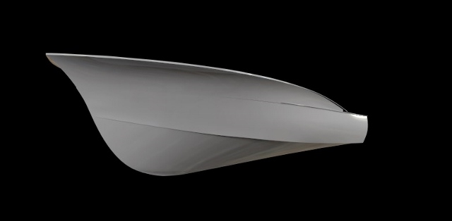

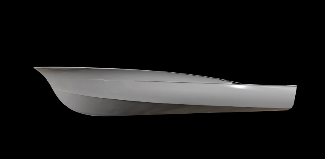

    I think Capt J's anecdotal observations from the helm viewpoint may be misleading you a little Liam. Over here we do indeed frequently encounter pretty steep head sea conditions and while different builders deal with it in many ways (deadrise, COG, appendages), we all strive to design a well balanced hull for all conditions. When Capt J sees things like forward extended range tanks and how the boat's don't "like" them full, it is intended to be that way as that's not usually the normal running condition.
    Most sporties on this side of the pond are optimized for the highest speed possible in calm conditions with flatter aft sections and sharp entry. When on top, they run on the aft third of the running surface only and the sharp entry stays out of the water to minimize drag. If heavy seas are encountered usually a small amount of trim tab is sufficient to lower the bow and let it do it's "slice and dice" act and while the drag is higher with more wetted surface, it's an acceptable trade off for the ride. The expected speeds are also somewhat higher over here, 30+ knot cruise is considered a minimum and if the average size 60' convertible couldn't maintain that reasonably comfortably in 4-6' seas, they would never be able to sell one.
    Here's a couple renderings of one of our hulls that show the sharp transition from bow to flat aft sections (I hope)
