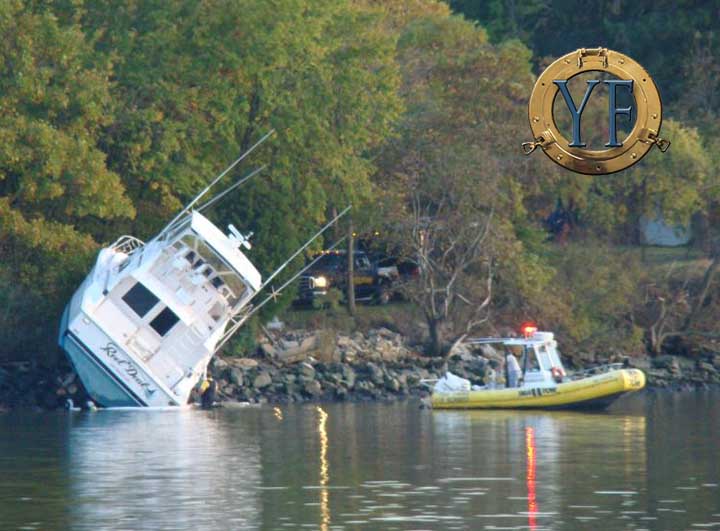

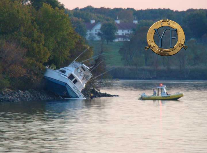

  13. Pascal
    8,950
    i took these pictures in the upper Chesie mid october a short time after the accident happened, incl. some injuries. That boat was too far off course to blame a mechanical failure, at least one that an alert captain could not have recovered from. The best scenario was that the captain missed the slight turn in the channel and continued for 1/2 mile straight to the rocks...
  14. NYCAP123
    11,209
    I'd guess asleep at the helm or he may have just needed to bottom paint and didn't want to pay for a haul.;)
