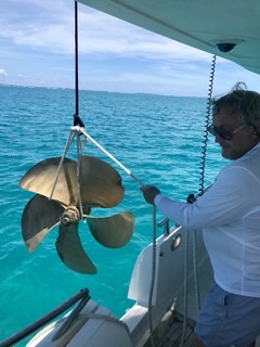

    I'm a little concerned that the shaft may not be strong/safe enough for a 5 blade wheel.
    I don't recall a shaft rating mentioned.

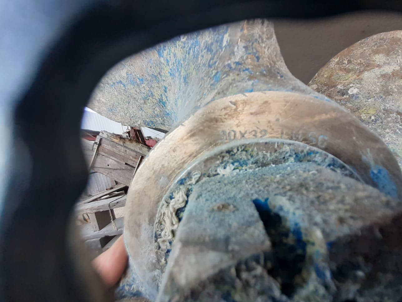

    Got some terrible picture from the shipyard today of my old propellers
  10. MBevins
    MBevins Senior Member
    May 23, 2008
    1,263
    Windsor On. Canada
    Is that a seized shaft cut off?
    That's UGLY.

    Showing the original prop is 30x32.
    much bigger than I expected

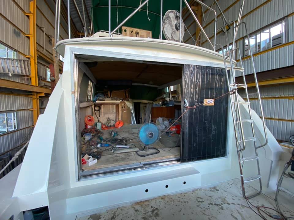

    Heres some pictures to update you guys on the progress...
    All the engine work is done.
    Hull Bottom Done.
    New Salloon Door Installed.
    Now working on the 12v wirings.
    No updates from VEEM or ACME yet.
    Finally! Feels like my B42 Repower Project is coming closer to the finish line. I’m guessing a lot of ppl may like or dislike this glass door mod, and my shipyard thinks is a waste of money! But here you go!
