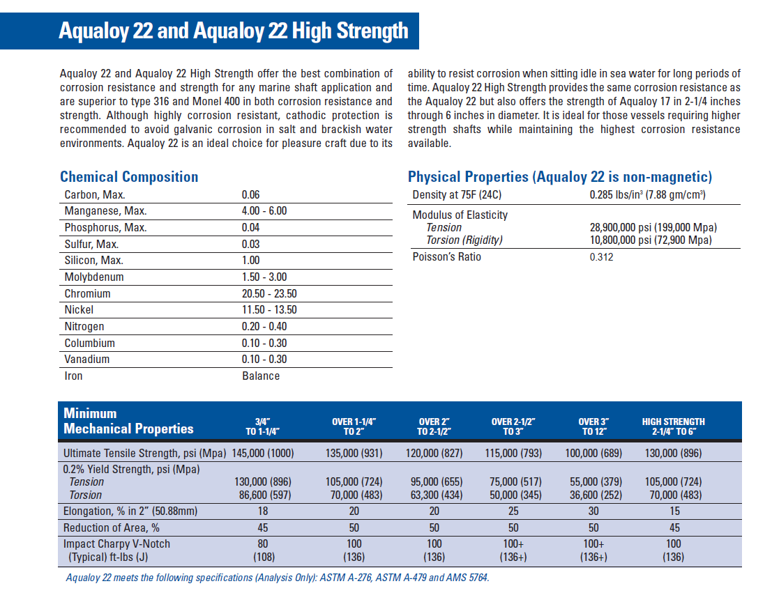

    I have just double checked the current old shaft size is 56mm (2.2 inches) diameter, and about 12 foot in length. If I use normal Aquamet 22 it will just fall short of 493hp at 491hp. But I dont see any where that supplies Aquamet 22 High Strength below 2.5 inches.

    While severely limiting buying used props etc. if you go with a splined prop shaft you can go with a smaller diameter shaft. I know of a 75’ sf with 2000hp 16v2000s and 2.5” splined shafts instead of 4” and a normal key way.

    56mm (2.205") is awfully close to a US 2.250" (57mm) shaft diameter. Assuming it would still be the factory 2.250" shafts?
    But for conversation sake, using 56m (2.205") and regular AQ 22 (63,000 psi yield strength in torsion for shafts 2" - 2-1/2") at a gear ratio of 2.20 /1, you get a Safety Factor of 5.20 and therefore have no need to go to AQ 22 High Strength. Bertram did their home work and has the right set-up for your needs.

    So you saying that the Bertram 42 came with AQ22 or with the shaft diameter is US 2.250" (57mm) ?

    As far as the shaft goes, I was commenting on your information regarding shaft diameter, it appears to be unknown what material was supplied by the factory unless you can get access to the manual.

    Ok understood so I will just order AQ22 with the shaft diameter of US 2.250" (57mm)
