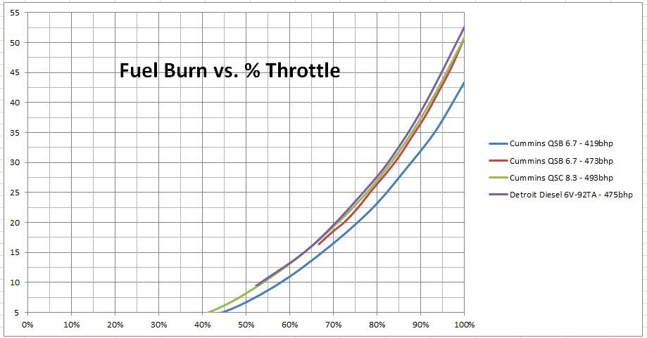

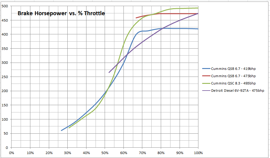

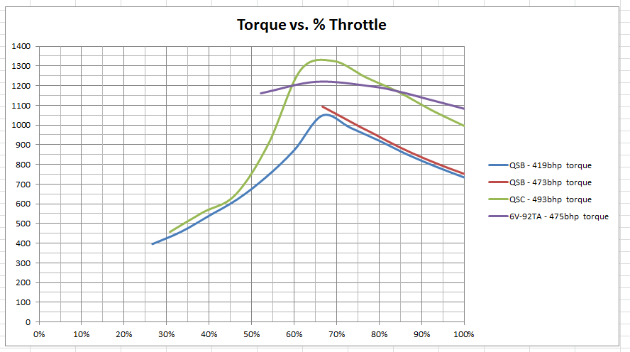

    QSC; Less weight, more torque, not killing the QSB to make HP & torque.
    I thing the OPs ship should come out of the water and move/handle nicley.
    Yes, the QSC cost more, the total price of re-powering including labor, controls, exhaust, hull mods & misc; the QSC upcharge is small.

    Thanks for the graph analysis! I really want the Cummins QSC but after balancing all cost, workmanship issue, and government certification hassle seems like Cummins QSB is a much simpler choice.
    The cost difference is minimal thats understood but the cost saving I can spend on the new genset thats a plus! Workmanship in Hong Kong is a high risk, I dont trust them at all so finding a slightly smaller engine is a bonus. If I go with QSC 493hp I will need boat surveyor to do the whole process will cost me time and money.
    Cummins 6.7 473hp, 3300/1150 = 2.87 gear ratio. I want to use ZF because its cheaper but the gear ratio isnt as close to as Twin Disc
