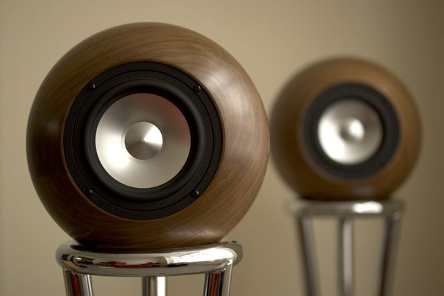

    Here's the loudspeaker I would put on the pedistals, (in walnut) assuming she won't let me do an exotic, embedded speaker array with a gentle curving walnut insert, completely surrounding the TV. ..YF pundits have already sold her on using the 'classic' 7" gaudy gold frame. -Thanks guys!

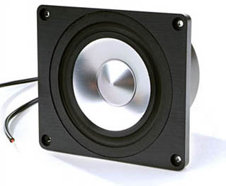

    Jordan JS92x... Sheer perfection?
    One of the old truisms we used to follow in the Klipsch days was that One top-quality mid-driver would always outperform Two drivers, even as they share the same load. And, while a marvel to look at, the Anthony Gallo 'balls' really don't step up to the plate once you get into the 65w -world, or go comparing anything in a system with monoblocs, or tubes.
    This product threatens to deliver something alltogether perfect for your 5.1/DTS direct soundfield. Mind you, nearly every other 'small-room' speaker diagram I've seen lately, really makes my ears hurt because the speakers are too close to match the expansion required.
    Sub-sat sets, (which is technically all we need deal with for future applications,) are problematic because the Bass is so difficult to couple with the sats. The usual answer is to use the best rated sub you can afford. One statistic suggests we must apply 50% of our total power below 200Hz. I know of no requirement for more than 400w at the bottom end. But, just to prove how 'inefficient' modern science can be, one Nevada Mfg has released a 2,400w set of 'THX-ultra' in-wall subs. ..And it costs more than the Kaliedescape suite!
