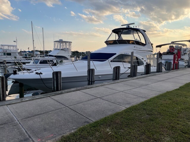

    We are at Whittaker Point Marina. Real nice place with a wine and cheese sailing yacht vibe. Staff is awesome. They have a courtesy car, real nice bathrooms and a nice lounge. The Piggly Wiggly nearby had a shuttle that runs to all of the marinas. See pic.
