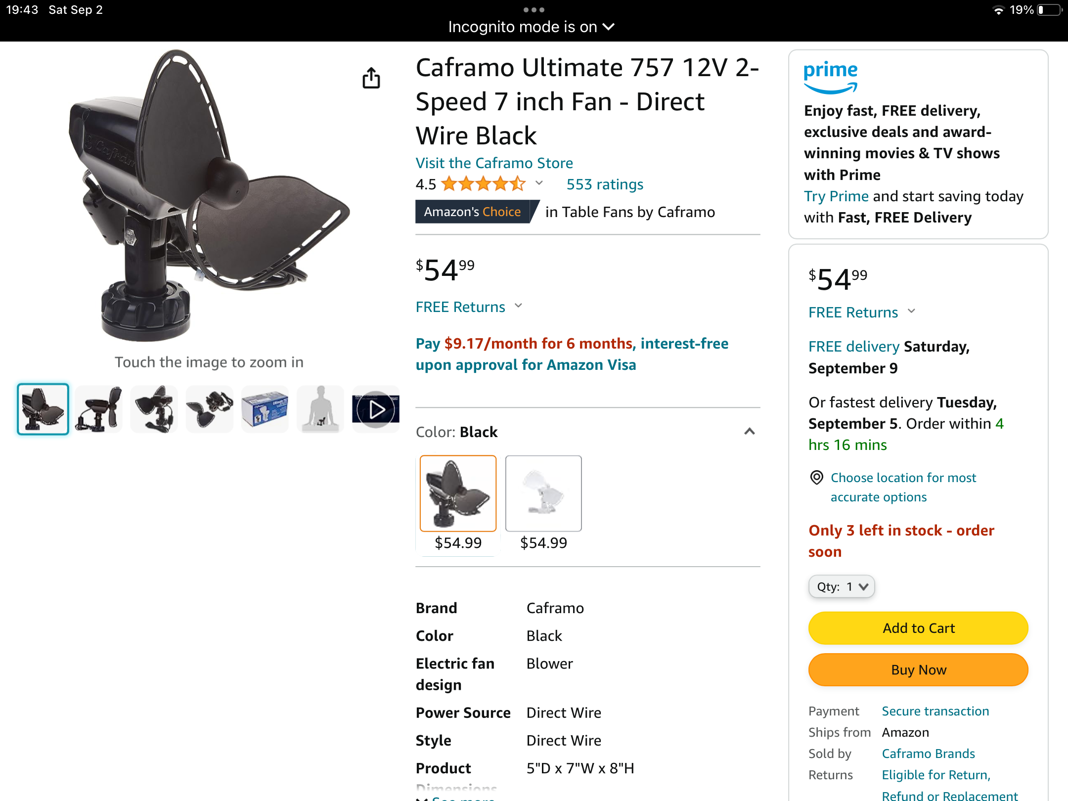

    Fairly cool at night these days, the hurricane sucked some heat out of the air.
    Open the portholes and run a 12 volt fan, it should work good if you have bug screens.
    (My wife is a native New York City girl, she never complained about no A/C on a sailboat we owned for 14 years, But we had great ventilation and more hatches and bug-screens than God)
    When we got into power boats, generators/shore power was a thing but we never really needed it as long as we had big hatches, bug screens and 12 volt Caframo fans.
