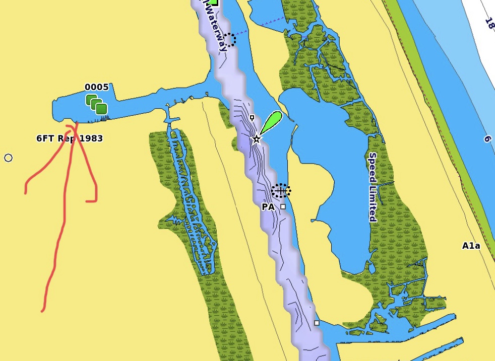

    Stop at our lagoon next to Marina del Palma if you want a break from running.
    We have a small bay with no restriction on anchoring, that I know of anyways.
    We also have docks, but not ready for transient boats yet. (50~60 empty docks)
    Stop by and anchor for a night or two and take the dink to shore, happy to help with a ride to a nearby Publix super market, also a Mexican Restaurant next to Publix with excellent 'Ritas..
    No haul-out facilities around here, but instead we have a lazy lagoon with no anchored boats except you:
    Nearest fuel dock is 40 mins running to the North and a slight detour to the West, like 0.5 NM from the ICW, Palm Coast Marina.
    Our anchorage is almost midway between Daytona Beach and St. Augustine.

    What is your draft?
    I will check my sonar next time going out, but have seen several 35'-40' sailboats
    anchored here, it is probably 5'-6' minimum, shallow entrance to the North, stay South of the center.
    I can give you a ride to shore if needed, will take the boat out Friday and/or Saturday. If the weather is good there should be boats going in and out from our docks and you can ask anybody for a ride to shore as needed, small harbor, only 80-100' to the dock. (Don't tell anybody I said you can anchor there, I am guessing it is okay, but don't know for sure)
    Big boat house on the North side and a Boston Whaler factory on the South side, they do the occasional sea-trial with big CCs.
