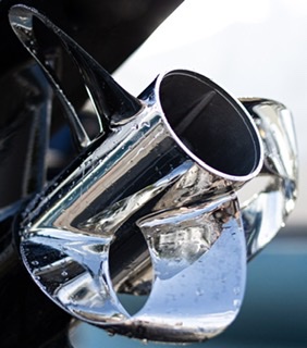

    Speaking of future props:
    The Sharrow Marine props looks real interesting: Like an airplane with winglets, big savings in fuel as the efficiency goes up.

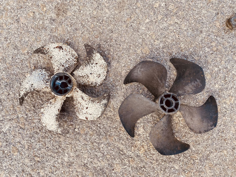

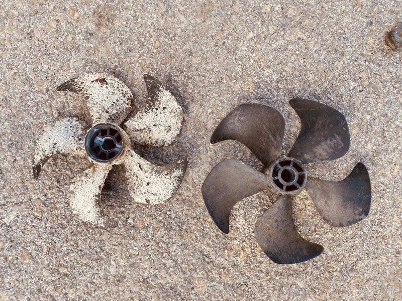

    I removed my new plastic sidepower props after six months they looked like this. I then cleaned one in acid which removed the growth. now want to antifoul with something. See before and after photos of cleaning.
