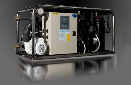

    What Condaria chiller are you talking about?
    If it's similar to this one, which is how their more popular models look like, I'm not sure of which alarm you are referring to.
    In fact, there's no such thing as an "Antifreeze 2" alarm.
    Beware: both CLP and CHP are reported as "Antifreeze alarm" in the manual, but that's a translation mistake.
    The only alarm which is antifreeze-related (sort of) is CLP, that is supposed to go off if sear water temperature is under 10° C (=50° F).
    If that's the condition you are boating in, you can forget warming up the boat with the reverse cycle of the chiller, and consider what Dockmaster already said ref. separate heating instead.
    But both the CLP and the CHP alarms can also be due to inadequate raw water flow - due to a restricted intake/pipe, pump not working as it should, whatever.
    OTOH, if you are referring to the "AL1" or "AL2" led alarms on the control panel, right under the LCD display, that's yet another kettle of fish...
