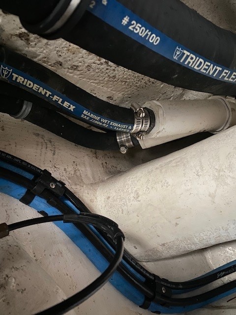

    My aft bilge pumps have a loop and then they discharge via a 'Y' with the fish box macerator pumps - port and stbd respectively. The discharge fittings are in the boot stripe which at rest is above the waterline. In theory, when running in rough seas the water pressure could overcome the loop and that shot of sea water could run back through the pump and end up in the bilge.
    Cabo port aft bilge pump discharge loop.jpg Cabo port aft bilge pump discharge.jpg

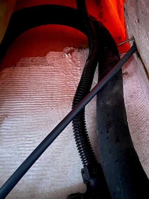

    In your left picture, is that a leak from your trim tab?
    In-between those just long enough screws?
    Is one of those screws in the hose?
    Was this a left coast or east coast built boat?
    Could it be time to get a set of eyes down there,
    back-down and maneuver some to make the leak happen real time, see where the water is coming from?

    No water in either fish box. Those macerator pumps restrict back flow. The Rule bilge pumps do not. No that is not the trim tab hydraulic line, its a Morse type push pull type cable for the live well dump valve. Those long screws fasten the dump valve flange and are much to long, however no they are not penetrating the bilge pump discharge hose. They will be changed.

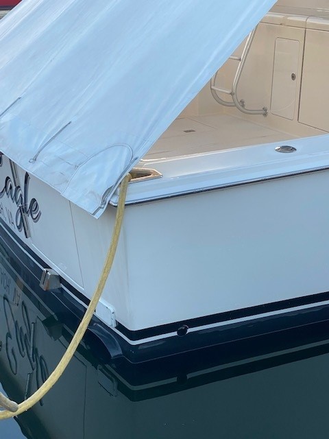

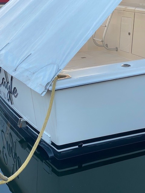

    See attached photo of the fish box macerator and bilge pump discharge fitting in the stbd boot stripe. Approximately 5" above the waterline.
    Yes it is time to climb around down there maneuver the vessel/back down and find out where the water is coming from. Keep in mind it is not much water each time - not even enough to kick the pump on.

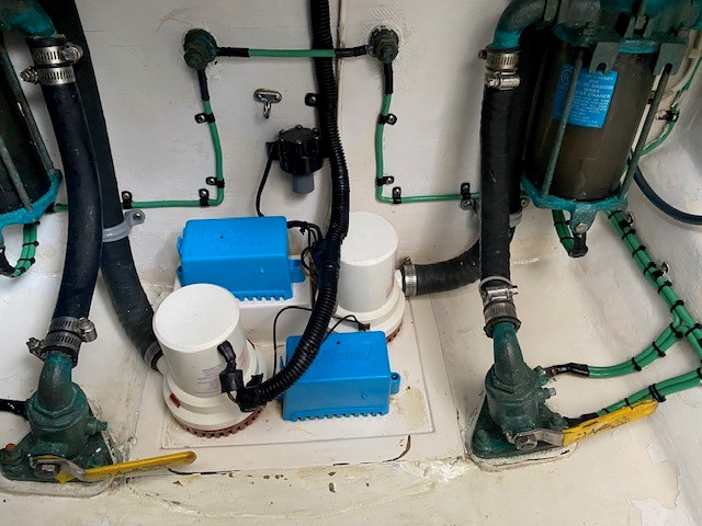

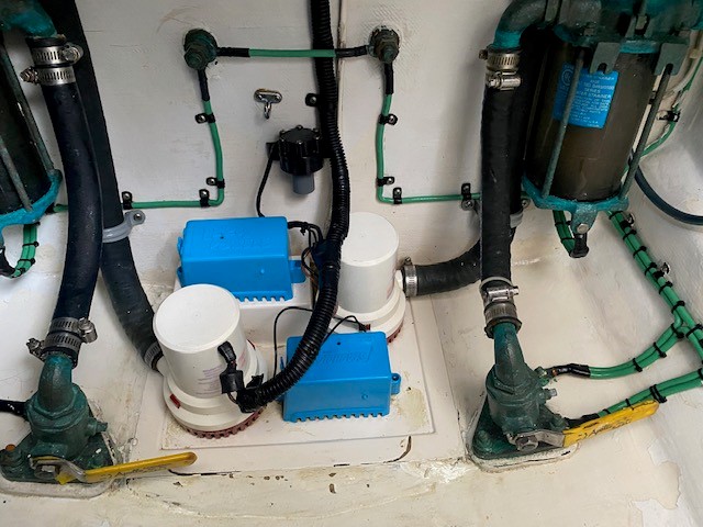

    My Cabo 40 has two 2000 GPH Rule bilge pumps on floats and a high water alarm. One discharges to stbd the other to port. Good redundancy and a good pumping volume when needed. Bilge monkey investigation next underway trip.

    Problem is, per your picture, on that pad, there may always be 1/2" to 3/4" of water back there.
    Those Rule pumps are not capable of picking up low water.
    And that pad has them higher than the bilge skin.
    I can see in your picture the redundancy.
    The second pump will only come on if the first pump fails, then the high water alarm to let you know the second pump is not making it, then you know there is a problem.
    IMO, a little late by that time.
    I would hope an alarm is sounding when that second pump comes on, then a second (louder siren) sounds when that high water float trips.
