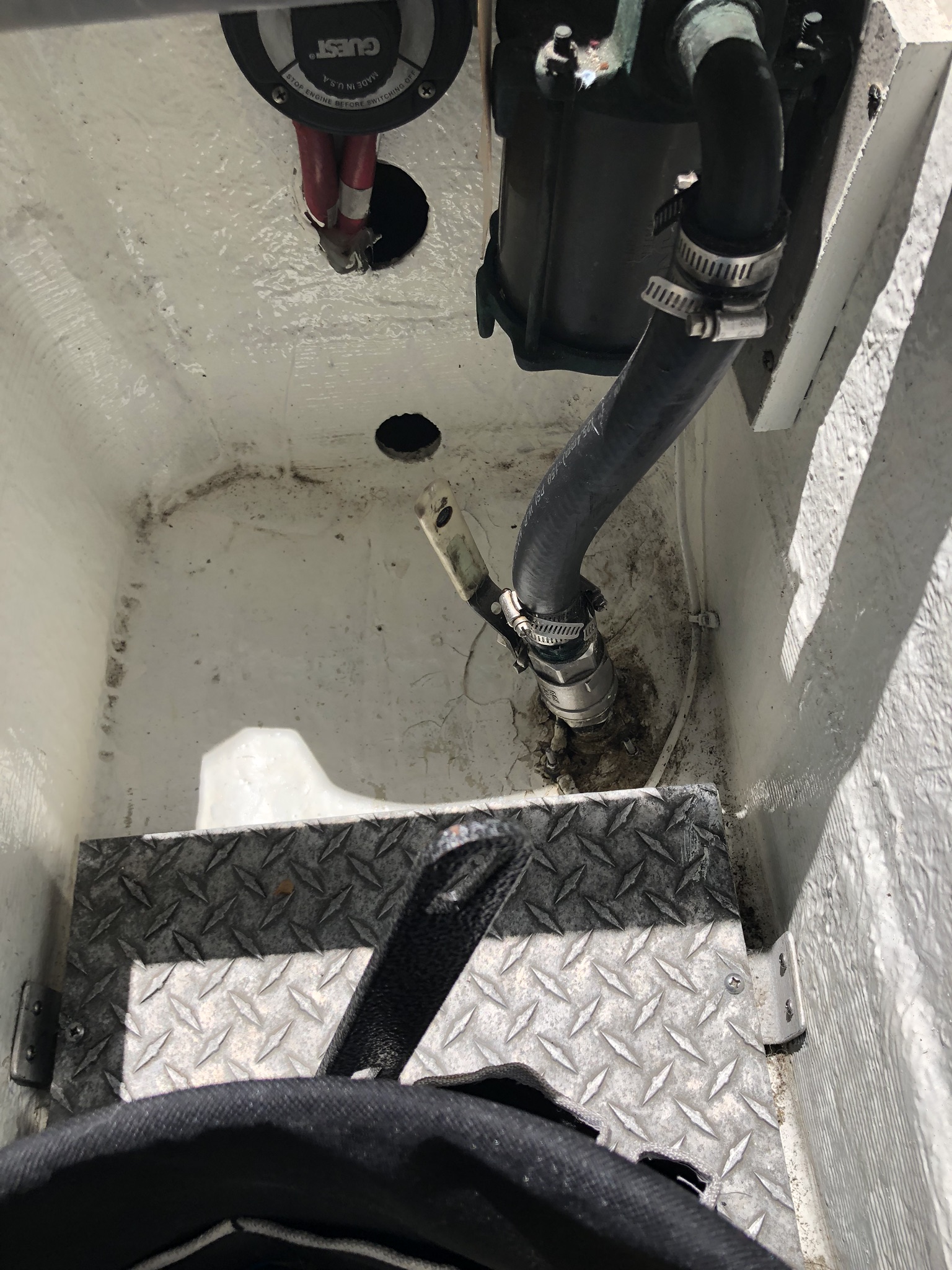

    7729C025-E3BB-40F3-91E4-926E14CE0458.jpeg Well I found something. This area now has one additional through hull for bait tank. The bulk head I want to cut shows the scupper on the bottom and battery switch that I would need to relocate. No picture yet on access behind generator

    I wouldn't cut a thing. Don't think it's a good idea. Find another way to get to it. You may have to move the generator a little bit to get to it. They are not to hard to slide around.
    Or just add the new pump at a new location.
