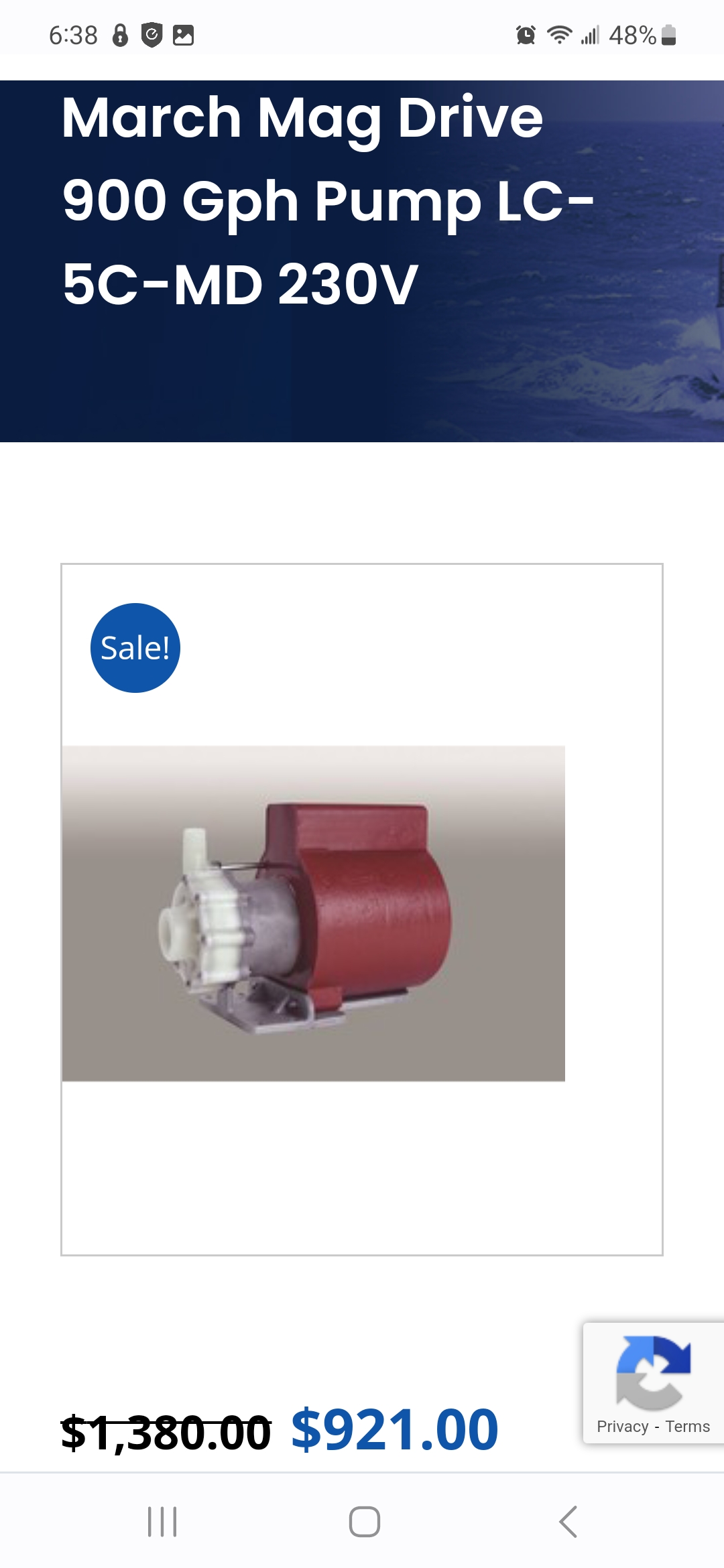

  11. CaboFly
    CaboFly Active Member
    Aug 24, 2018
    287
    Seattle
    I am going to go confirm but I believe my units are
    20k Salon
    12k Master Cabin
    12k VIP and Bunk Room
    Based on that math above 180gph per ton I believe the March

  15. Capt Ralph
    14,585
    Lets see; all 3 condensing stations are there in the picture?
    Top condensing station raw water inlet 5 feet max over the hull water inlet?
    Pulse a few bends in the hose and fittings, lets guess the pump is pushing a 6 foot head.
    You require approx 700 GPH for 44Kbtu.
    The LC-5C-MD will push 840 GPH at 6 feet, 715 GPH at 12 feet.
    IMO, good choice.
    I would further say, your previous pump was moving to much water and not letting the condensing coils work to well.
    Just the 104M is a common and more readily stocked (cost reduced?) model.
    I have 3 of them on my boat.
    Yes, I am over pumping but their cheap to me.

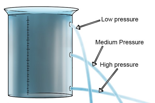

  17. Capt Ralph
    14,585
    I would like to ad more thoughts; Mount the manifold high if you can and install a hose bib for a 4th outlet there.
    The higher the manifold helps ensure the 3 ACs get a lil more even flow instead of the top one possibly getting less.
    There is some name for this that escapes me at the moment, I did find this picture;
    Or, install all three hoses up to the same height, then town to their own condensing station.
    Just imagine the same weight of water to each unit.
    The hose bib makes a great bleed and test valve and a good connect for back flushing.
    Oh Yea, I luv spending O P M.
