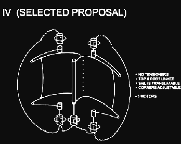

    As I was looking back thru some old postings of mine on that other forum, I ran across this possibility that I never took the chance to explore more thoroughly upon.
    Unlike my 'single-masted ketch' design that I feel is not necessarily appropriate for a vessel of less than 45 feet, the DynaRig is appropriate for this smaller size vessel. In fact a ‘3-panel’ dynarig might be considered rather than the 4 panels of my new 63 foot DynaRig cat design, or the 5 panels of Falcon. However, I would still favor the 4 panel configuration, as it offers more variation in reef-able sail areas. And with my simplified sail furling mechanisms, it doesn’t add that much weight or complication to the overall rig.
    Falcon’s dynarig was complicated by requiring the sails to be furled up inside the mast thru a hollow slot on one side;
    1) the mast itself needed a slot in itself all the way down one side of the already weaker side of an elliptical cross-section. This necessitated an internal structure be built into the carbon mast section to reinforce it at the slot area
    2) the furling mechanism then needed to be built inside the mast section, and a complicated track mechanism was required to guide the edges of the sails out onto the bridges to the yardarms & the yardarms themselves
    I am proposing a much simpler furling and track mechanism for this modern square-rigger concept:
    1) The mast will not have internal stowage of the sails, so no slot is required, nor internal support structure. It will be a simple elliptical section that will taper at either end to a smaller section at the top and a circular section at the bottom….not that much more complicated than an ordinary carbon mast for a sloop rigged vessel with a mainsail attached. It might also be a ‘sealed unit’ for ultimate flotation purposes.
    2) Each rectangular sail will furl around a ‘wire’ (PBO, Kevlar, Spectra, carbon, etc) sewn across its mid-girth, and having eyes at both ends that clevis pin into ‘continuous line furling drums’ as you might find on ‘Code’ type reaching sails. The sails are constructed of low-tech, light-weight ordinary Dacron, and are of such relatively small dimensions that when furled around a very small diameter ‘wire’, they present a very small diameter package to the elements when ‘stowed away’. Each individual sail panel can be quickly and easily replaced, and inexpensively as well.
    3) The furling drums are incorporated into the leading edges of the yardarms/bridges so as to present less windage, and they are’ stacked’ up vertically end to end in a line such that they ‘share’ bearings at either end. One small electric motor drives each panel for furling. For each panel of sail there are two (top & bottom) additional motors to unfurl the sail.
    4) The yardarm ‘bridges’ can be shorter in length than Falcon’s with many inherent advantages including the more readily usable ‘forestay arrangement’ with or without a ‘code’ type reaching sail. Shorter lever arms requires less power to rotate the rig as a whole.
    5) Three of the yardarms are of equal length thus less production cost…in fact probably these three would be only slightly more expensive than the elaborate furling/stowing booms now found on many ‘ordinary’, modern, short-handed sloop rigs.
    6) The low-tech, Dacron sails of this rig should present some considerable savings over those modern sails for Bermudan rigs, and help offset the other initial extra cost of the Dynarig.
    7) The sealed mast and yardarms could offer the flotation for the ultimate non-capsizing protection.
    These proposed changes to the original Falcon’s interpretation of the DynaRig concept should result in a less expensive version, which is just as viable in sailing characteristics as the Maltese Falcon is proving to be.
