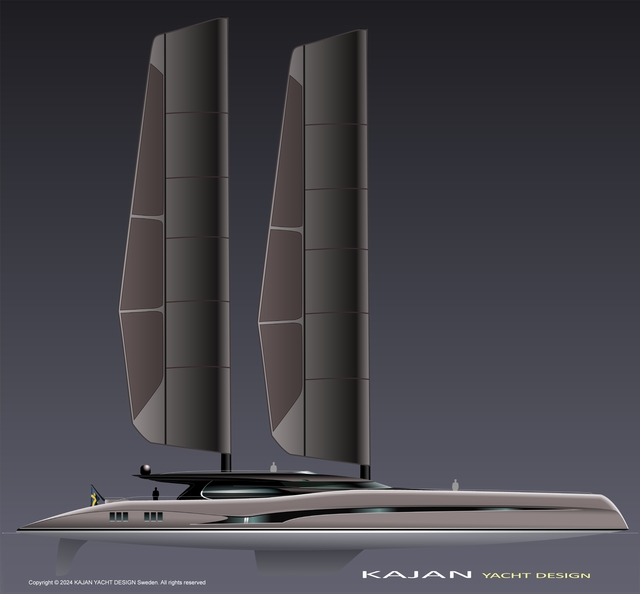

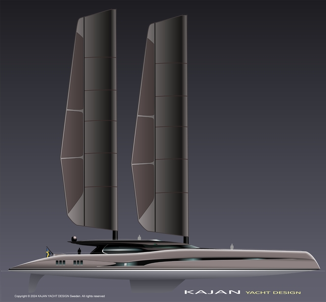

    In this case the design was aimed at maximizing interior space with large windows and a slightly larger superstructure.
    Attached is one of my old large catamaran concepts but with a different aim, and rigging. ;)
    ZacSc likes this.

    Not everyone is like that. For example, my wife :) I take my wife out to sea sometimes. She doesn't enjoy steering the boat. But she enjoys being at sea. Maybe it's for the best, I'm less worried about steering the boat wrong.
  5. ZacSc
    ZacSc New Member
    Feb 22, 2024
    5
    Sydney
    It looks very modern! I don't understand why it's an old concept.

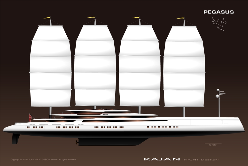

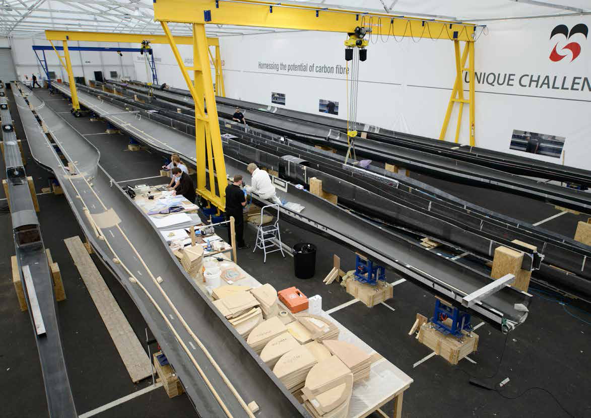

    There is not very much to be simplified on a dynarigg. There is no alternative to the Inmast furling, as the vertical inyard furling will not work because of the neccessary bended design. I am not saying a dynarigg will not work on a multihull but not on a relatively small 50 meter multihull. On a much larger catamaran, lets say 300 t0 40 ft in length with with multi deck superstructure or a twin deck bridge deck, there might be sufficient distance between the lower and the upper bearing of the masts. But here we are talking about an at least 3 or 4 mast design like the study of Mikael Kajan below.
    But if this giant would be built for example at Lürssen Blohm & Voss, Hamburg, it would bust the one billion Euro border very easily. And there are not very many other yards in the world, capable of building such a large multihull according to megayacht stadards.
    Attached a file about Dynarig masts. When You see the construction, one can easily understand, one of those masts can only be built in carbon fiber. Again we are talking about alot of money.
