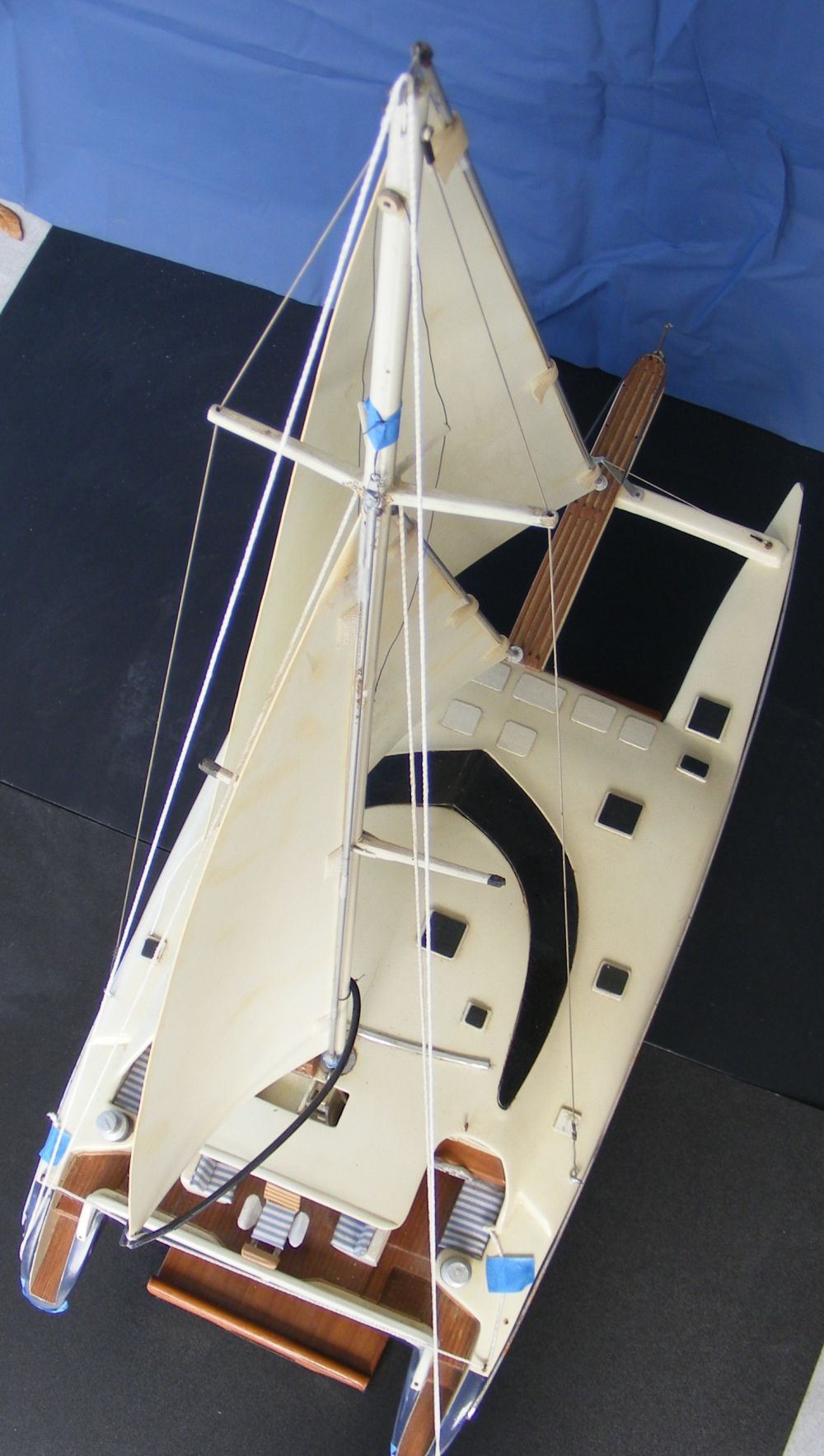

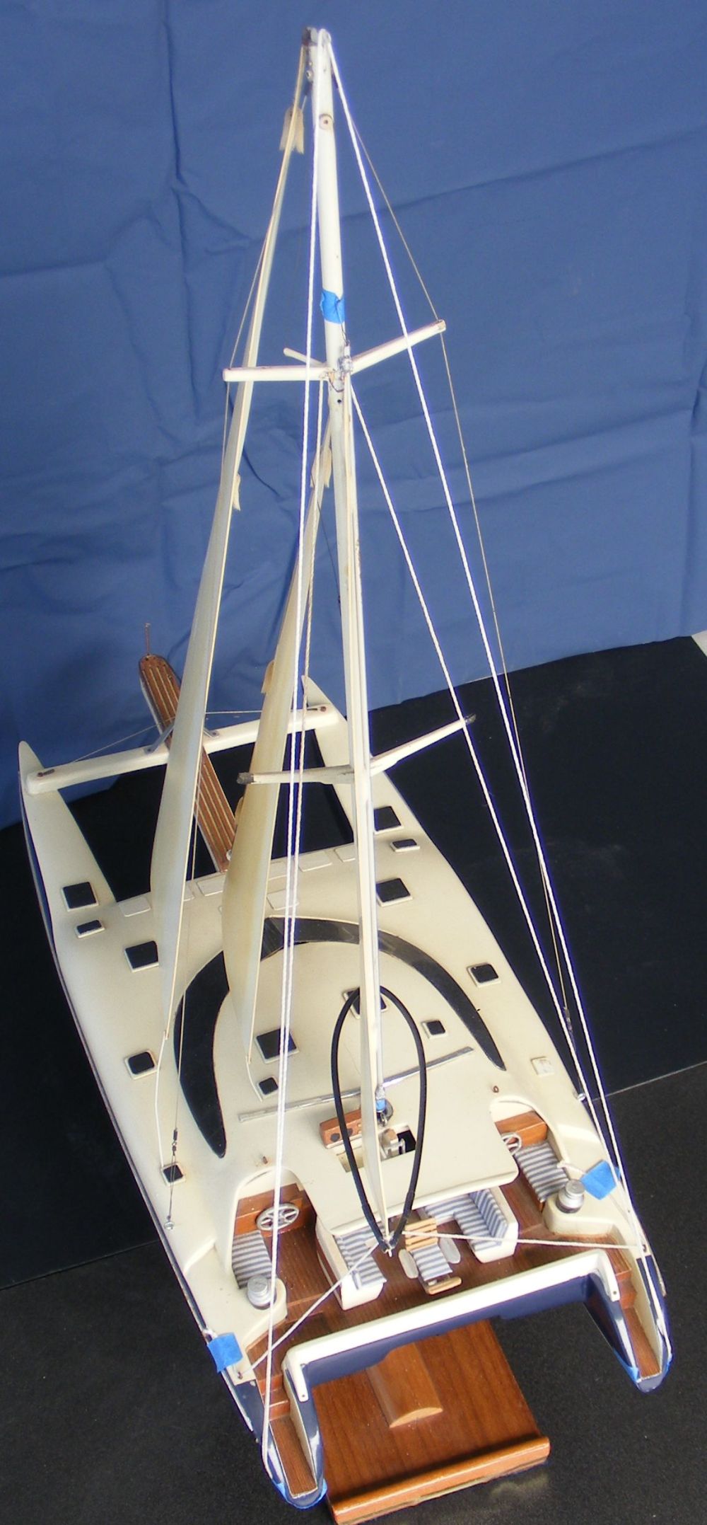

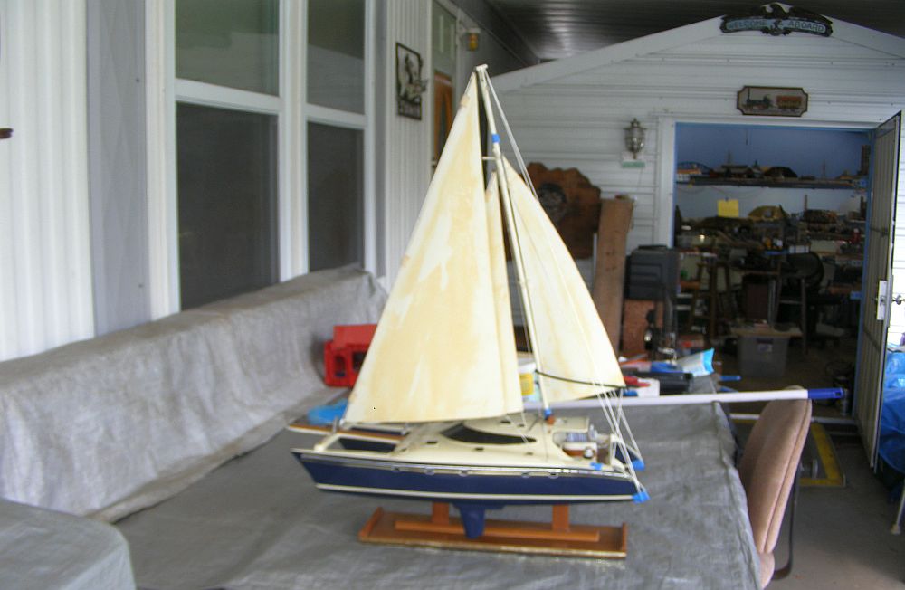

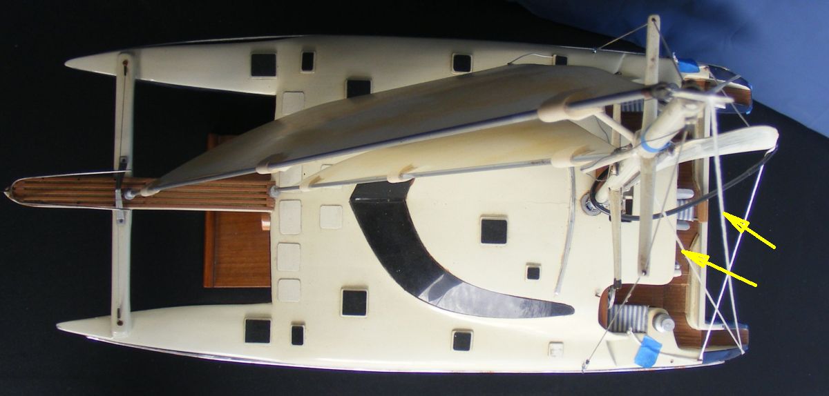

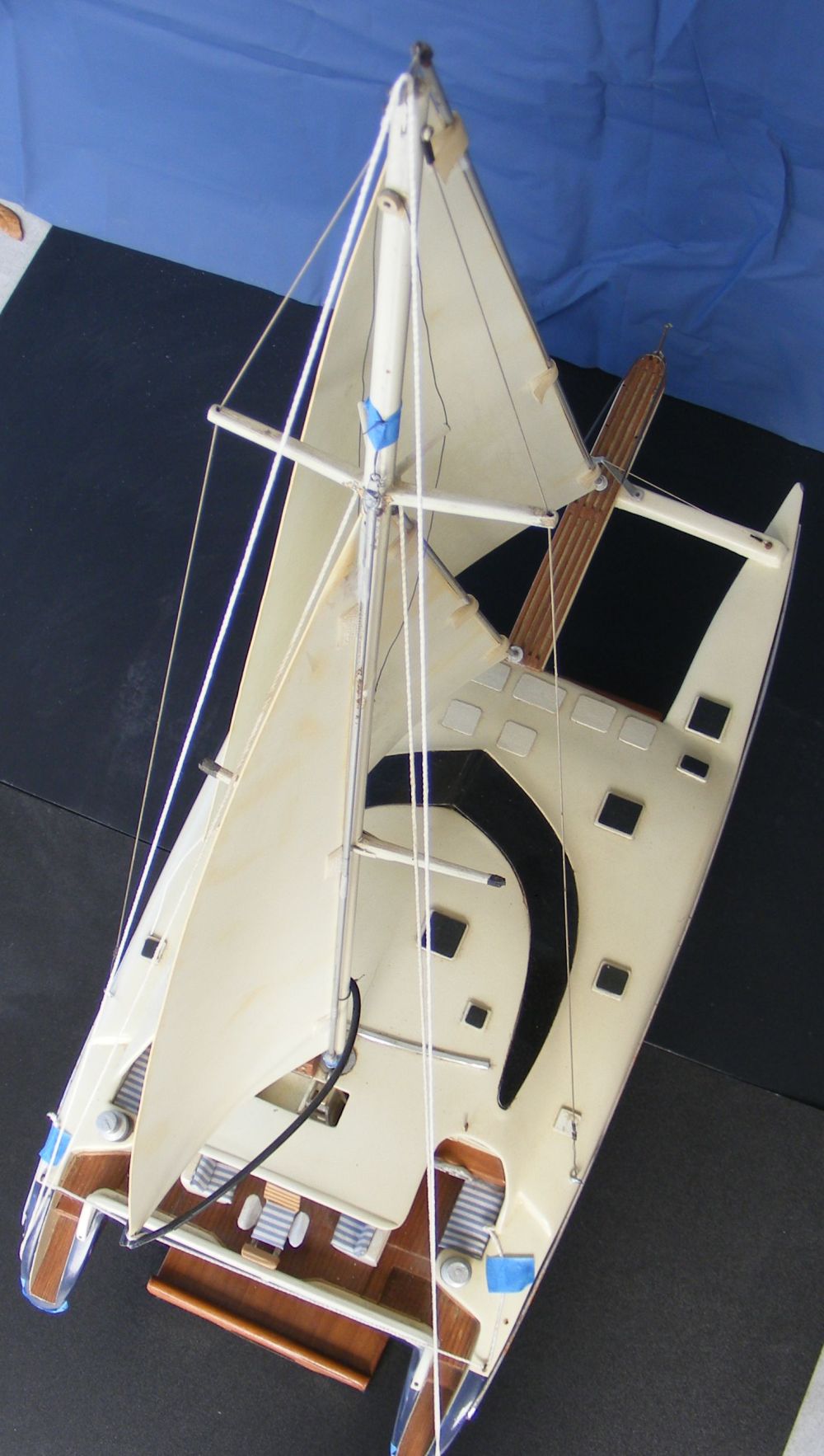

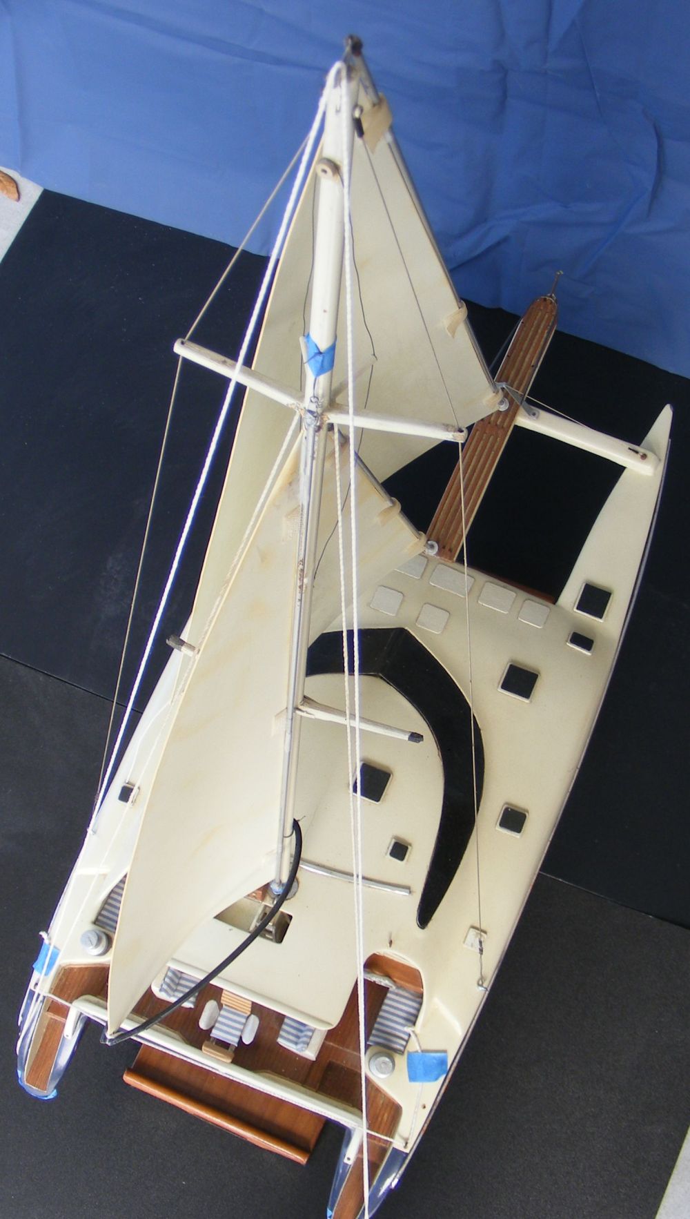

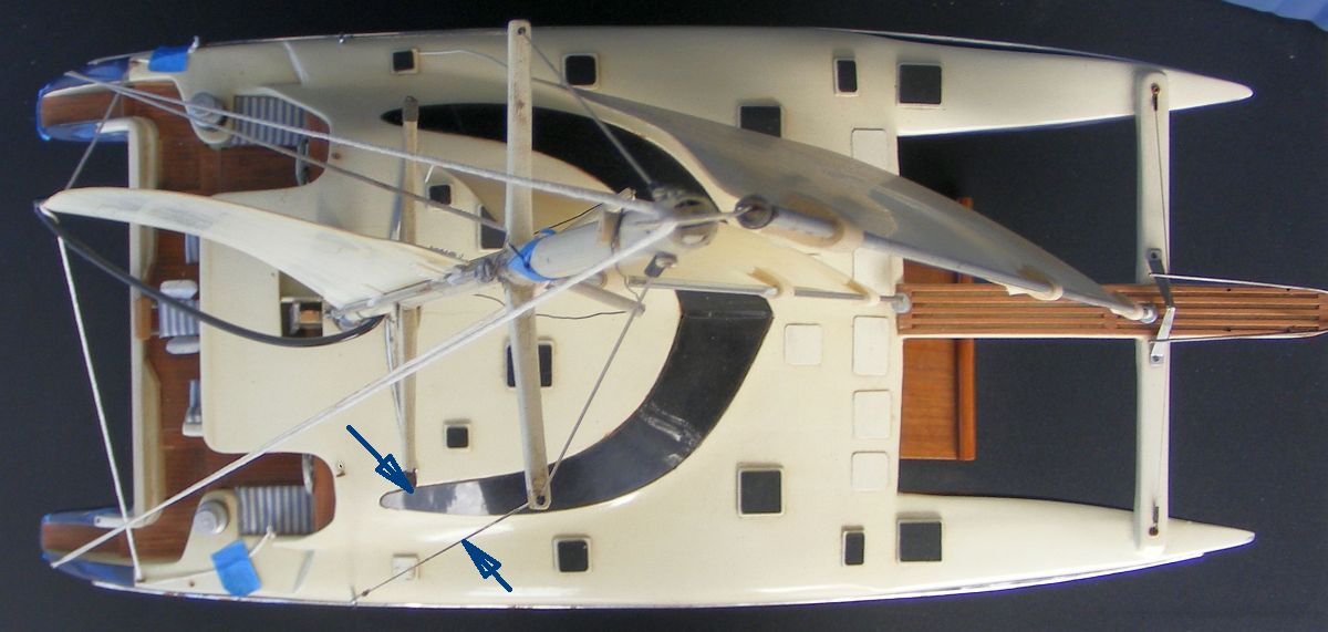

    I'm going to use my old model of the boat to show the rigging, but please remember I have not modified this model of the boat to reflect the new cant of the mast to 5--6 degrees. It still has the old 10 degree cant.

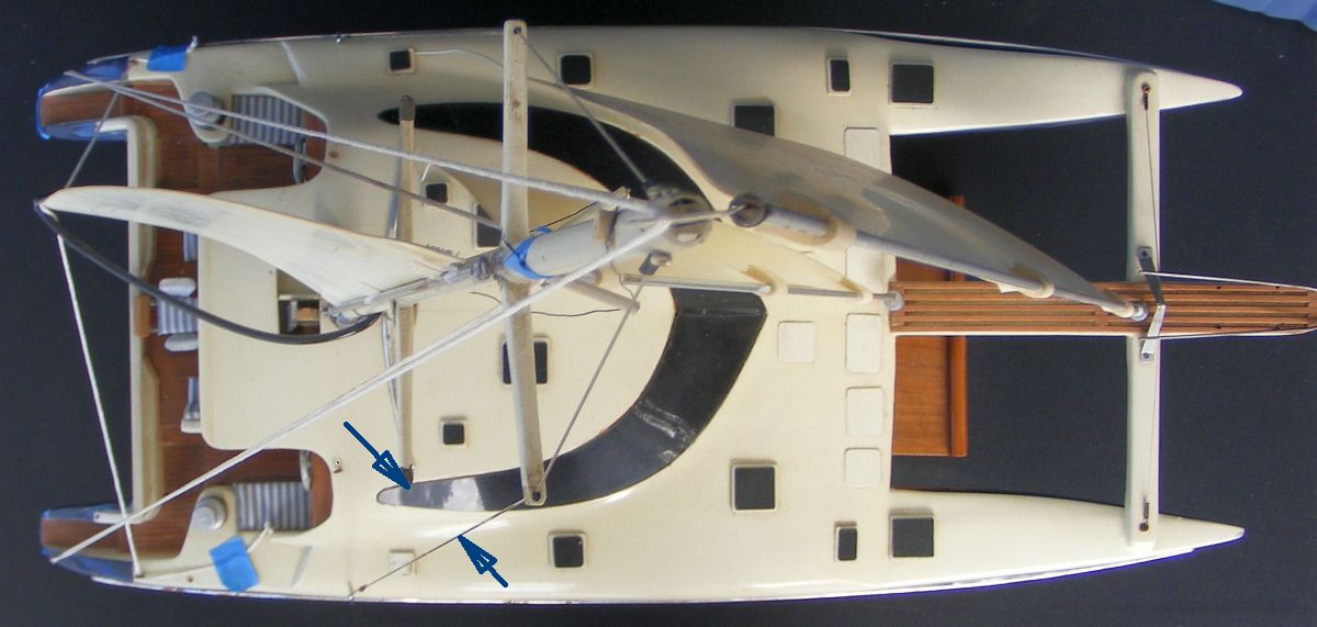

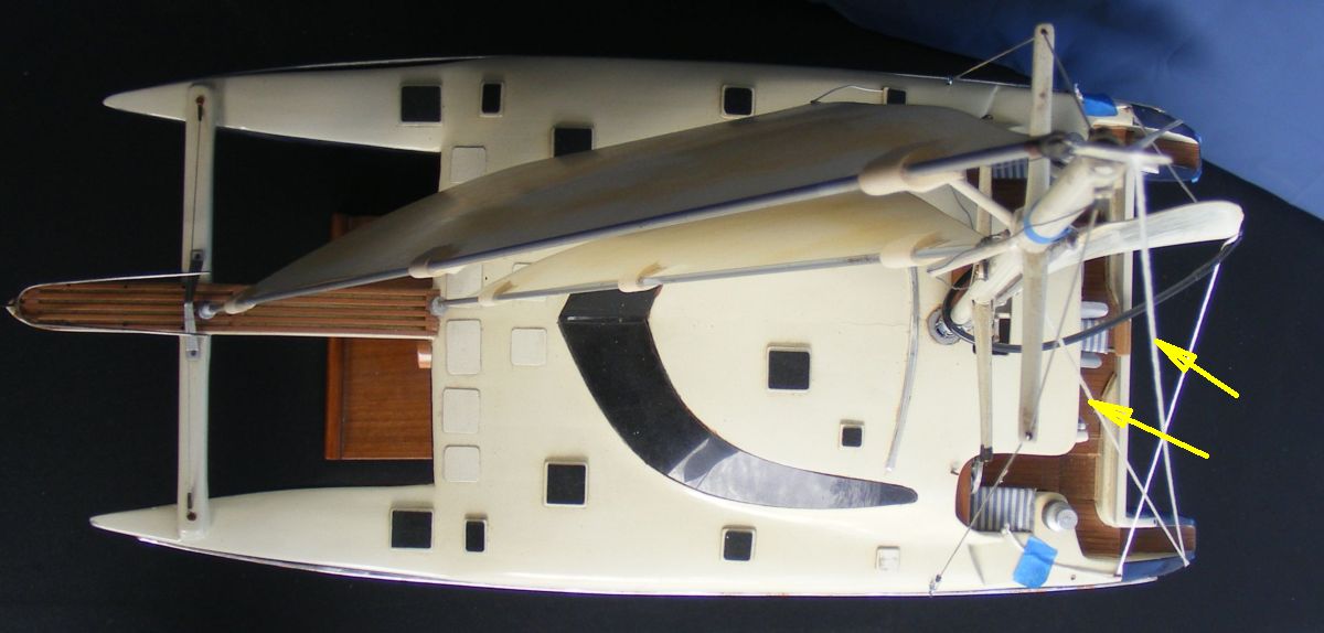

    I'm not sure what went wrong with my posting the images,...some were full size, others were NOT?
    I was trying to show how with a little bit of extra beam on the boat,... those backstays could be attached inboard of where I have them, while still providing plenty of room for the mizzen sail to swing out even on a broad reach. It is also possible that the mizzen sail could be hosted higher.
    The mizzen and the staysail can both be self-tacking, and both be made to roller furl. In fact all 3 sails can be roller furling, thus no hosting of BIG (and heavy sails).
    This rig adapted to Kajan's vessel design could be made to look real acceptable.

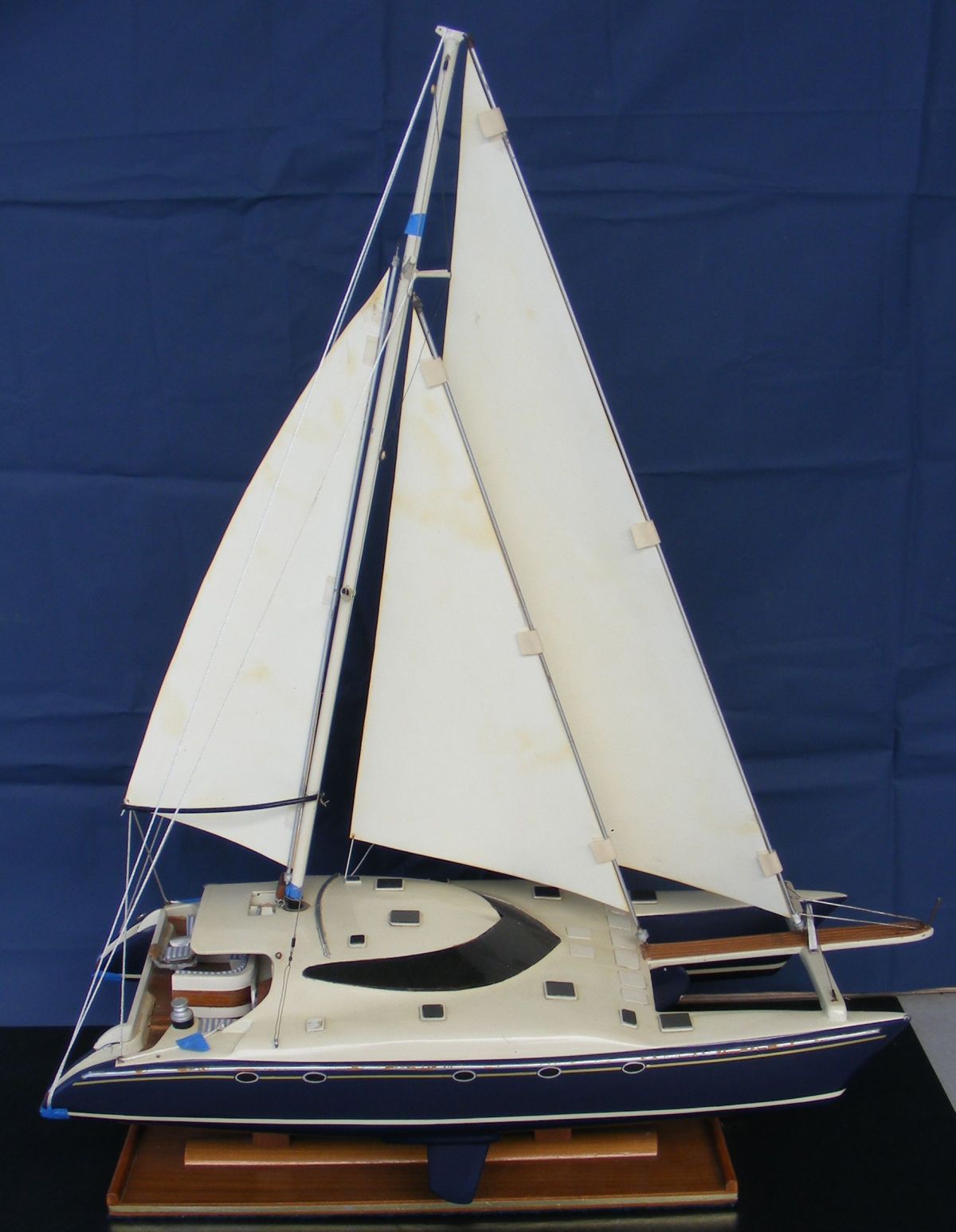

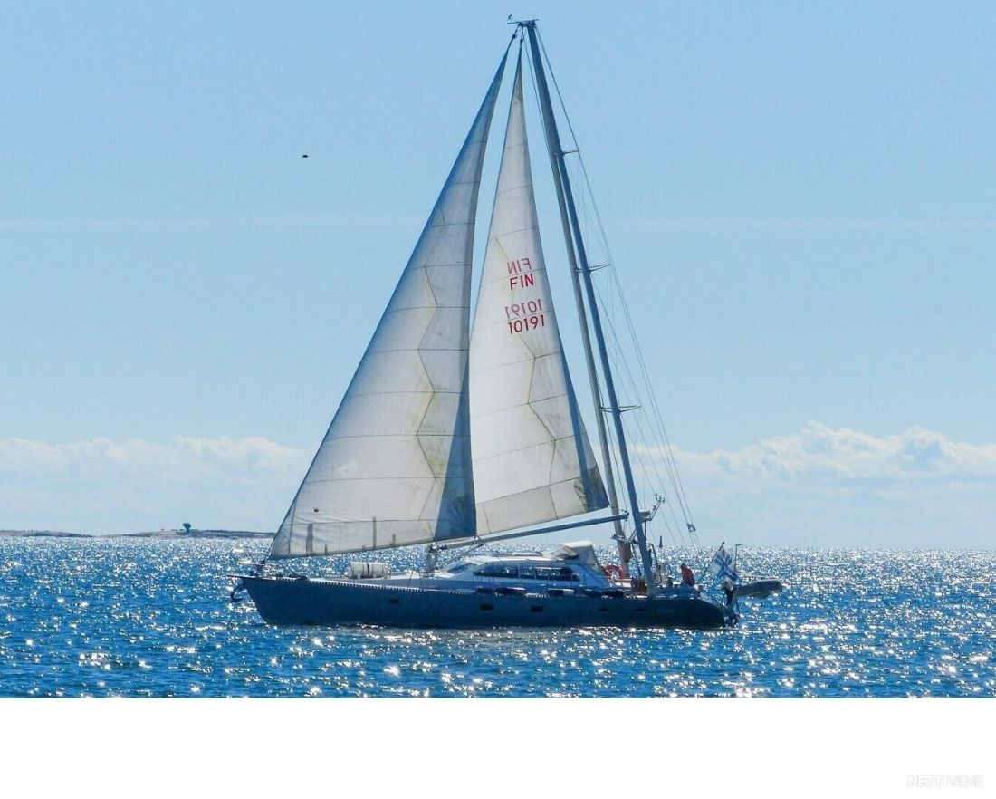

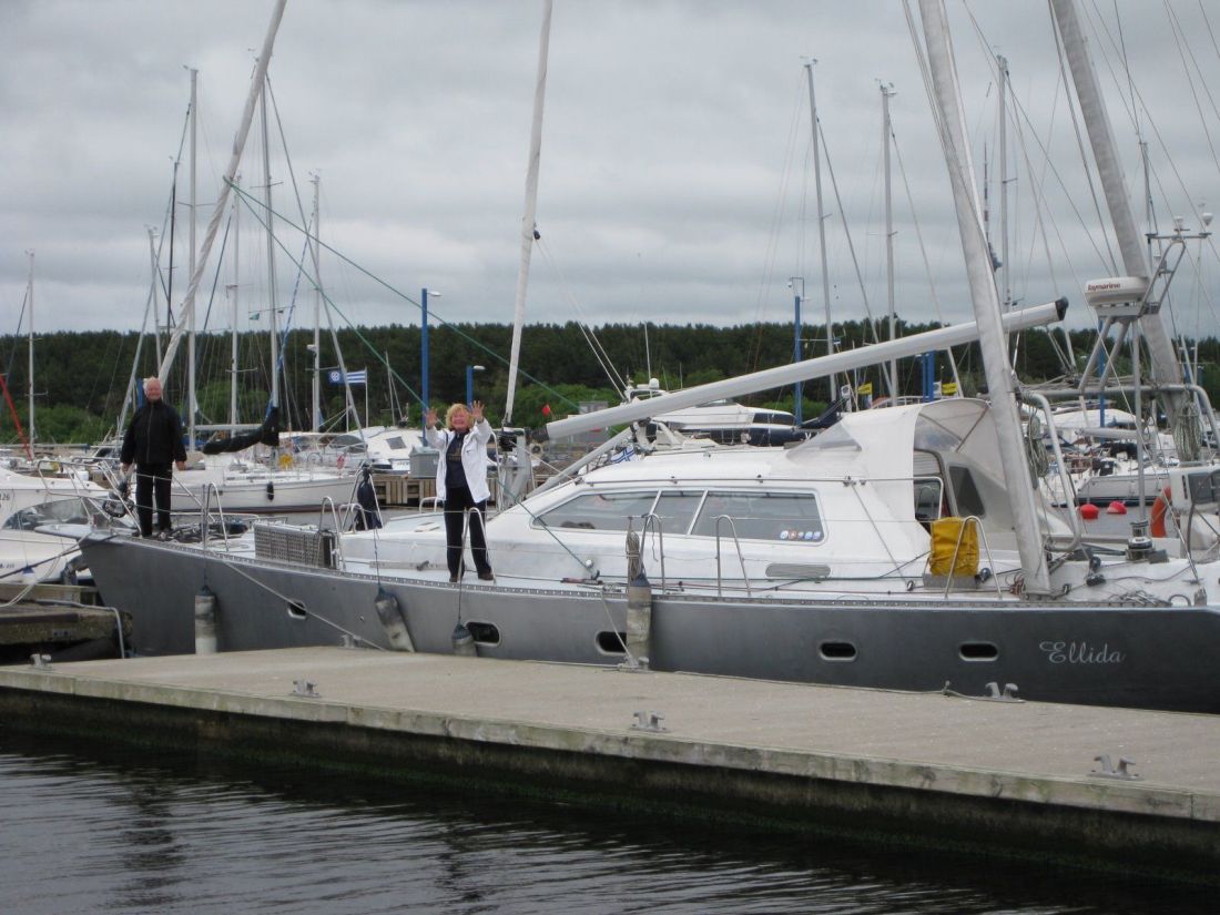

    Rather surprisingly I just recently happened to have received a private message from a gentleman asking about helping him understand a mast aft monohull he was (had) considered buying. He sent along 2 pictures (attached).
    I vaguely recall hearing of this vessel a few years ago, but seeing that it appeared to be Finnish owned, I could never establish a conversation with the owners.
    In looking at the design I would guess that they considered some of the results of that wind tunnel testing I mentioned above, (posting #22 above)

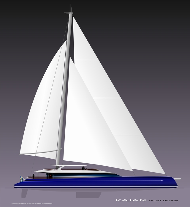

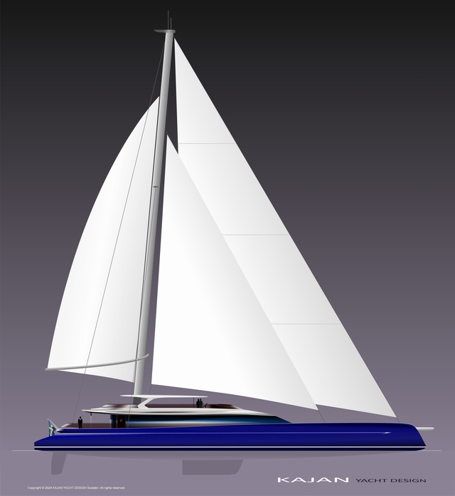

    I did some quick doodles of the rigging based on your scale model. Of course the measurements need to be adjusted, this is just to get an idea of the rigging concept on a large catamaran design.
    The rigging concept is growing on me.

  14. HTMO9
    HTMO9 Senior Member
    Jan 13, 2009
    1,681
    I have never sailed such a rigg but I estimate it would be very weather helm with high rudder pressure. Second, there will be a lot of weight aloft, if one translates the pictures of this Finnish sailboat to a 50 meter boat in length.
    As far as Aesthetics are concerned, well, beautiness is in the eye of the beholder :).
    With my very traditional taste, I could never own a boat with such a rigg.

    Nice looking rendition Kajan!
    PS: It even looks fast, just sitting still :D

    Thank you very much, Mr Eiland!
    I have since checked your links and there is of course a lot that needs to be adjusted in order to better illustrate the aft-mast concept.
