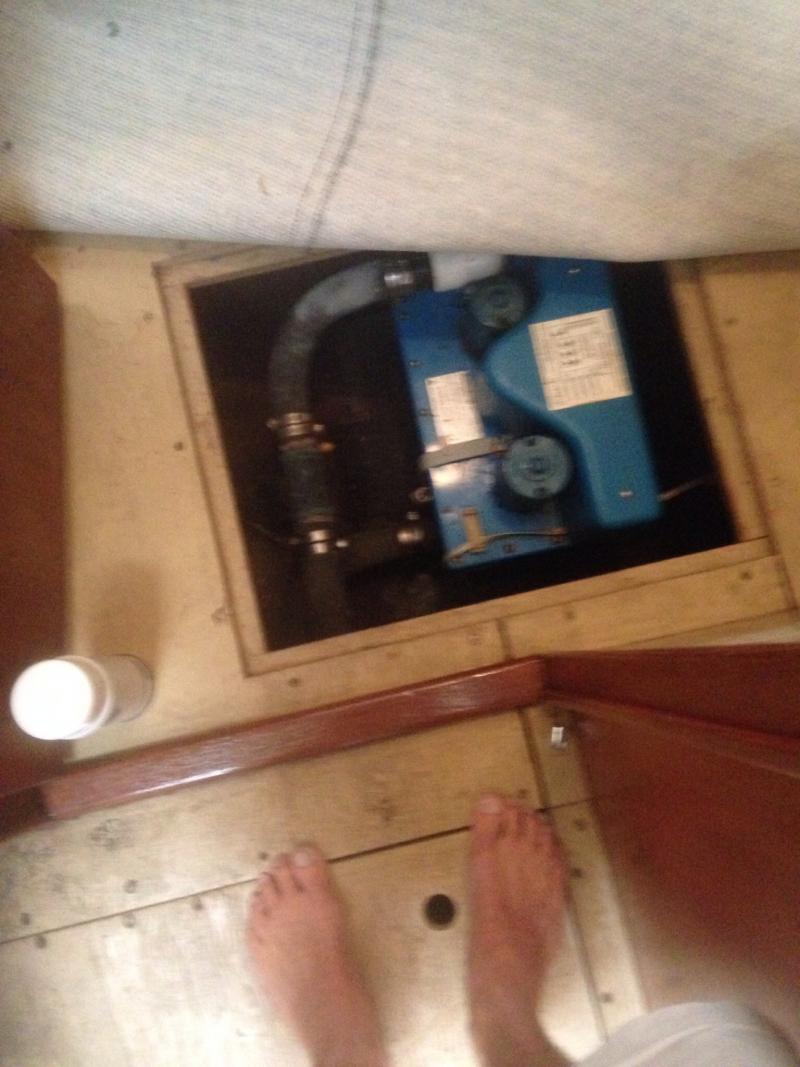

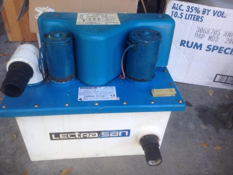

    Mark, you are exactly right. The thru hull and sump are under the floorboards in the galley. Time to yank the LectraSan to send back for refurbishing.

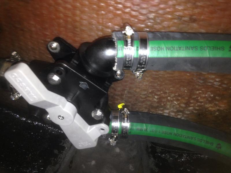

    Ok so I removed the LectraSan today and cleaned/prepared for refurbishing at Raritan. I also begun the process of replacing the defunct Jabsco Y valve and sanitation hoses. Currently this plumbing consists of 1 1/2 in h black rubber hose. Like a wise guy I thought I would replace my hoses with the 1 1/2 inch white sanitation hose. However, I am learning that the white sanitation hose is far less pliable and can't make the bends and turns needed to keep the white hose from kinking. So I guess I need to go back and get the more flexible black hose. Do you guys have any recommendations?
    Thanks!

    Hi Bill,
    I need the 1 1/2 inch hose. Also, I do have white 1 1/2 inch sanitation hose I just got from WM @ $4.90/ft. Not the same brand you show however. The problem I am having is that my product does not make turns without kinking, which of course is a no go. Is the product that you shared more flexible?
    Thanks,
    John
  9. Berean
    Berean Senior Member
    Aug 26, 2007
    303
    Sarasota FL
    This is not a great photo. However the black hose you see going from the seacock to the lectrasan is seeping, it is probably 30 years old. It is this and other sections that I am replacing. Unfortunately, the "sanitation hose" that I am trying to use will not even make the bend illustrated by the photo to replace its old black, seeping counterpart. Instead, it wants to kink. Moreover, not viewed in this photo is another section from the Y valve to the LectraSan intake that has even a more severe turn.

    Nice feet though, huh

    However, the Lectrasan is out, cleaned and ready for shipping to Raritan to be rebuilt.
    PS the Rum in the background must be Ralph's...

    But anyway, back to the whole hose saga, I think I'm set. I took the stiff white sanitation hose back to WM and got the black 1 1/2 inch sanitation hose. It is much more flexible and much easier to work with. I went ahead and cut sections to match those hoses I removed and installed the new Jabsco Y pump. new hoses and new clamps so my work is complete and ready to install the refurbished LectraSan when it comes back from Santa's shop.
    When I had everything pulled out of the bilge compartment I scoured it clean with copious amounts of bleach, Dawn and fresh water. It looks and smells much better!
