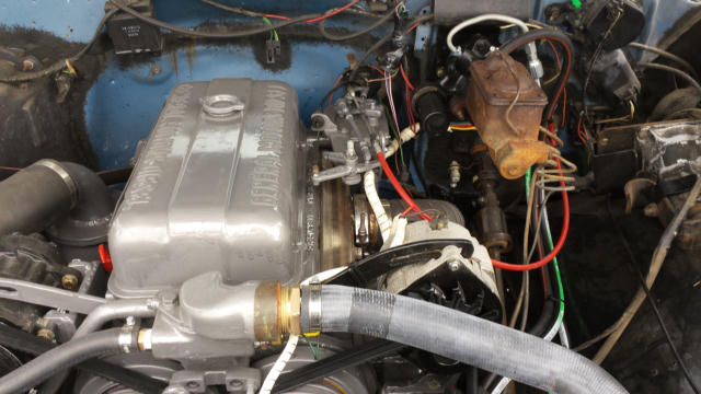

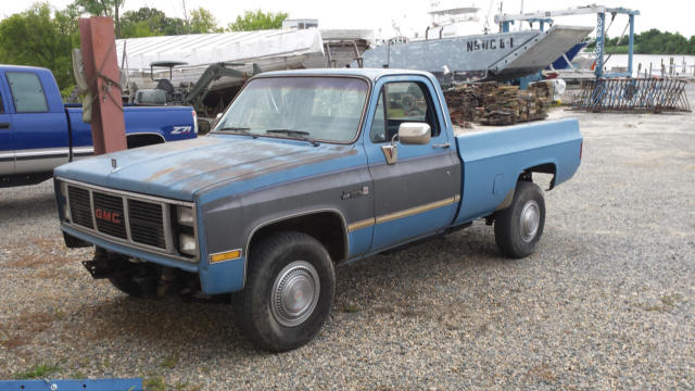

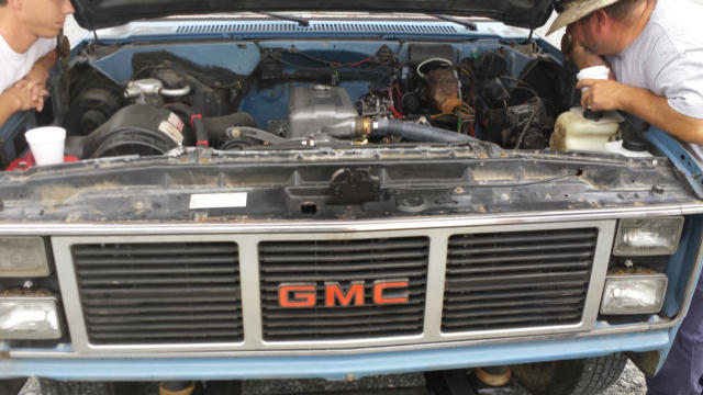

    YO HO ! been cruising this site looking for some of you guys with the Detroit Diesel know how...Sounds like I have found it. I know I am off topic sort of , but was hoping one of you guys could answer a question. I just bought a Post 46 with Detroit Marinized 6-92s , 550 hp ( 1993 ). No real history on them , one may have had a rebuild , alittle quieter and no black smoke when jump on the sticks. I may be right out of my mind but I have this idea to buy 2 6-92s which were in a pair of fire trucks , probably 4 K for the 2 of them .I would strip them of all the road ready gear and clean them up and have them as drop ins incase I suffer a great failier of one of the boat engines. I Wonder if with adding the right injectors , turbo , cooling system , setting up the heads etc if they will basically be what is in the boat. Thanks in advance....
  20. Capt Ralph
    14,582
    WOW
    Before we spend your money, lets review a few things.
    The marine 92s may have used up to 4 different pistons in the marine application. Have no idea what piston was in a fire truck.
    Exhaust manifolds and turbos are not compatible.
    The marine 92s used 2 different gear driven blower speeds. Have no idea what ratio was in a firetruck.
    The marine 92s used a whole bunch of different injectors. Have no idea what was in a fire truck.
    The marine 92 may have advanced cam timing (usally big HP). Have no idea what the cam timing or hp is in a fire truck.
    SAE 0 and 1 bell housings were used in boats. Different fly wheels. Different harmonic ballancers. Different oil pans, oil pumps, oil coolers.
    For your purchase and storage waiting for the big one to happen, it may be smarter to put that cash in a savings account, don't touch it ever until you blow up an engine. Storage will be cheaper.
