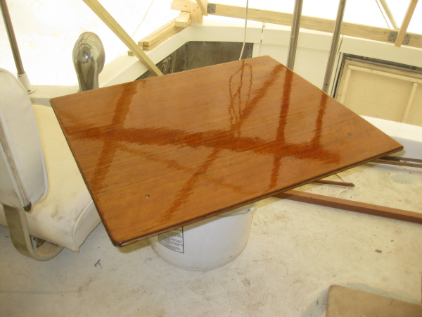

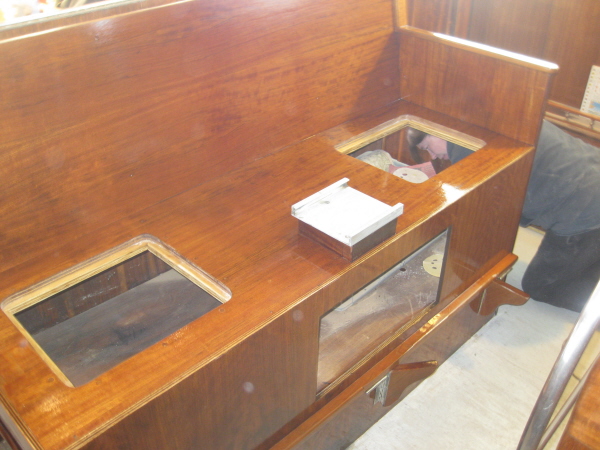

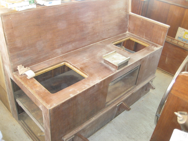

  2. Thanks man... shes come long way and there is still PLENTY to do... this was todays work. ws

    Very pretty work.
    I would like to see some more pics of your work. I will shoot you a pm.
