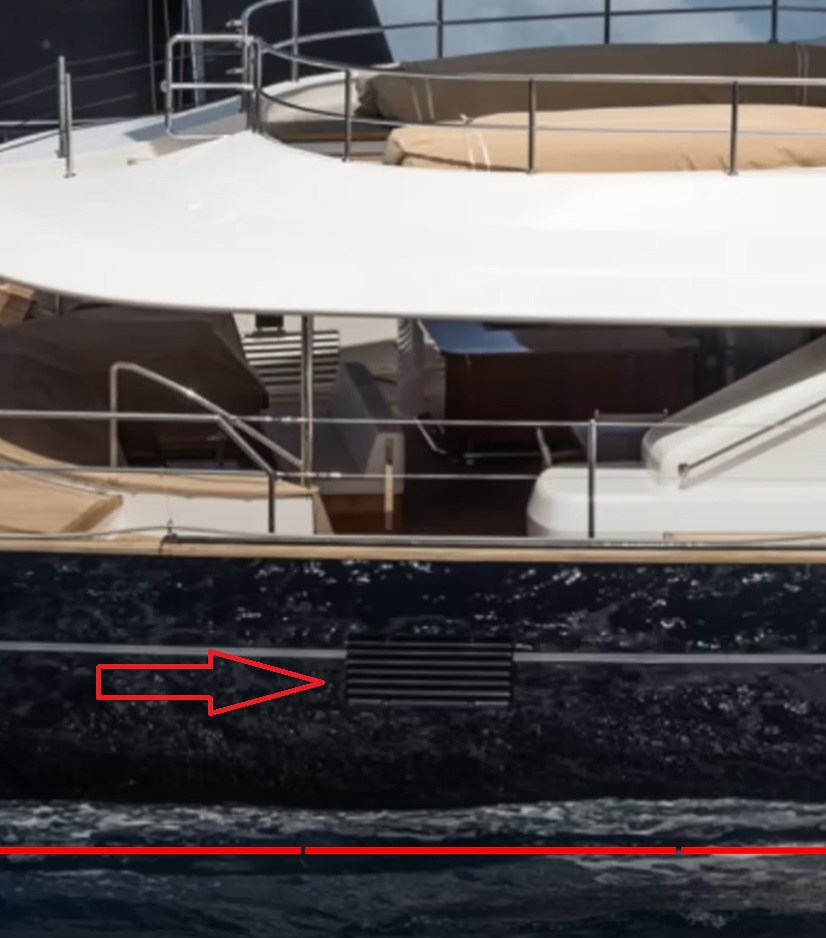

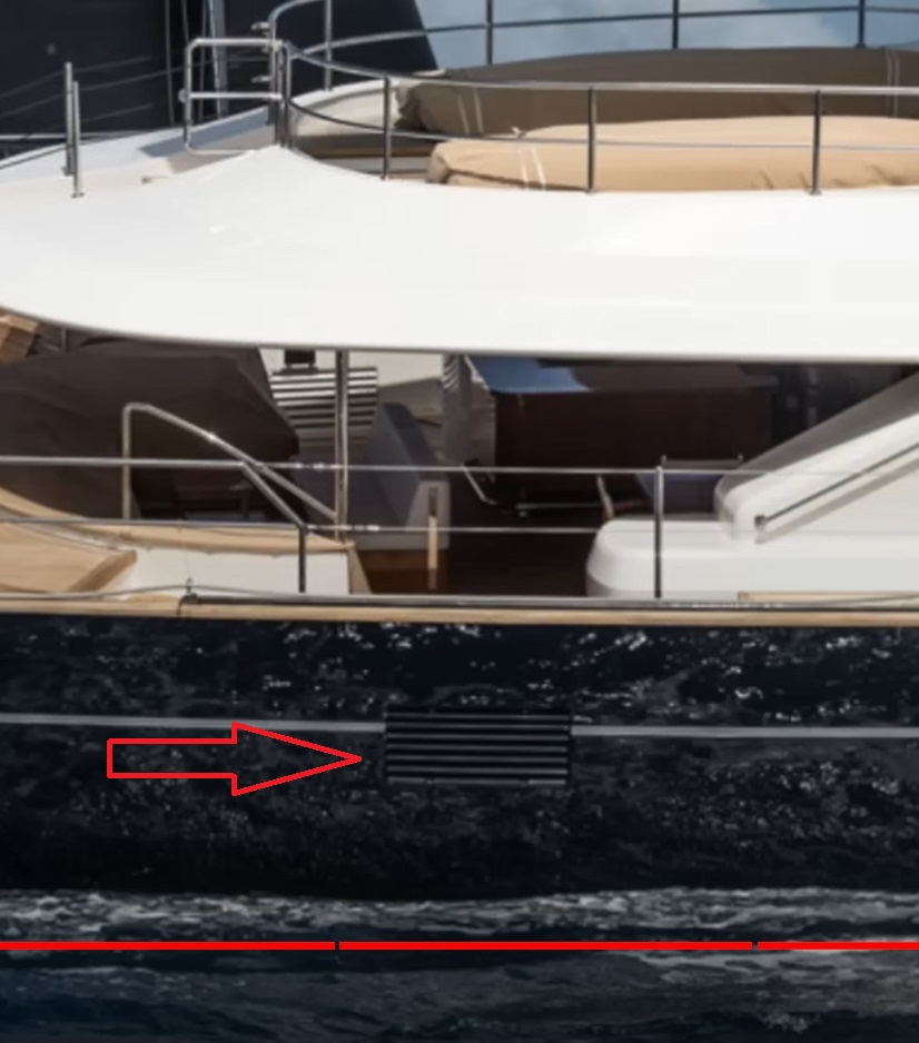

    That is not an option on a SY, as when heeled the windward side is subject to spray and wash of waves as well. The problem has been discussed for decades, but without a bulletproof solution I am aware of, except locating intakes as high and spray protected as possible.
    45deg is an exceptionally low angle for an offshore SY. Is there a large ER air intake in the topsides, as it looks on this picture - or what am I getting wrong here?
  10. BlueNomad
    BlueNomad Senior Member
    Jan 11, 2022
    108
    At Sea
    That's not an air intake, as there were no openings in the hull topsides, other than the structural doors port side aft and transom, not even opening portholes.
    It's likely a protective grill to avoid incidental contact with a fixed window, as that location may be vulnerable when alongside.

    I may be mistaken but the louvred vents on the white structure inside the cockpit look like some type of intake/ventilation box that may lead below decks.
    The discontinuity in the coaming to allow the recessed steps would raise an eyebrow. It will be interesting to see what procedures were in place to prevent water ingress once the deck edge became submerged.

    Unlikely that this is a protection for a fixed window, as there is no cabin behind, but the recessed deck steps. Rather a ventilation duct to the ER?
  13. Pascal
    8,939
    Could also be air outlet… you need both inlets and outlets to cool the ER. At least that’s how it done on smaller MYs

    No chance. Looking at it again it may be some type of freeing port, meant to allow any water around that sensitive area to drain overboard.
    If so, this arrangement will likely be scrutinised very carefully.
    pro from dover likes this.
  15. Pascal
    8,939
    you can see matching opening on the inside of the port side in that picture. Cockpit drain
