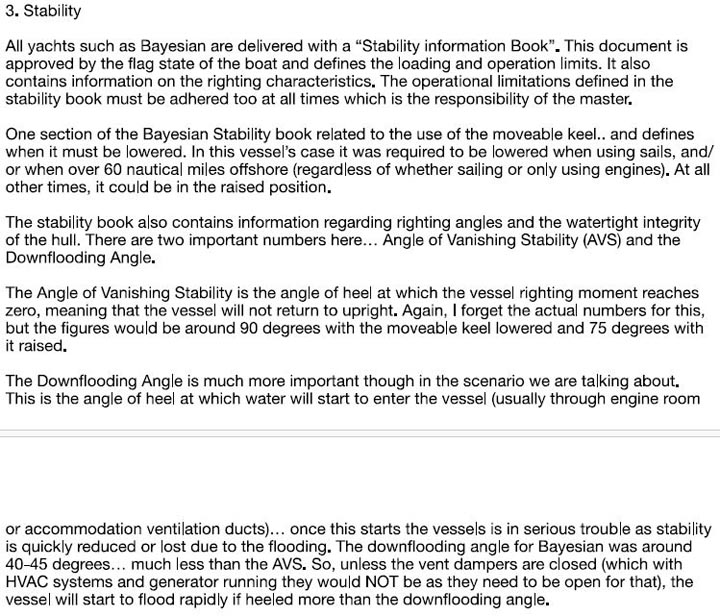

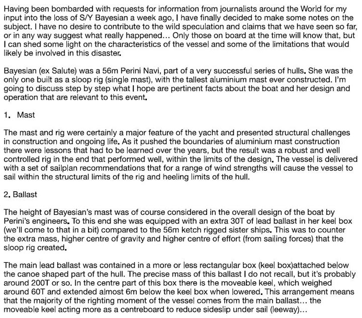

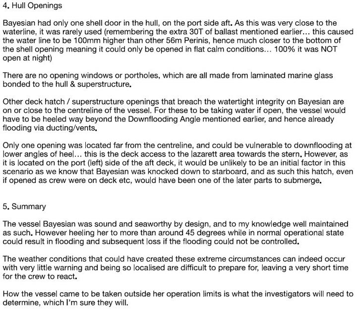

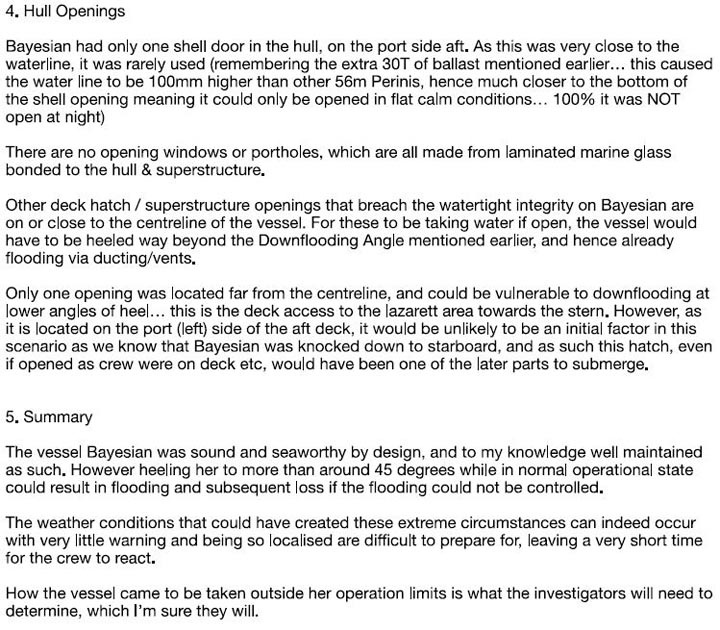

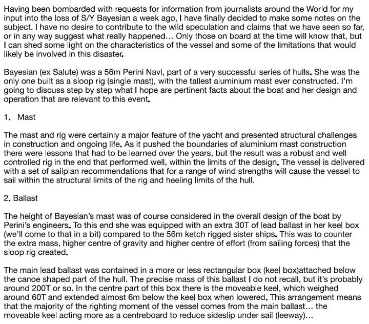

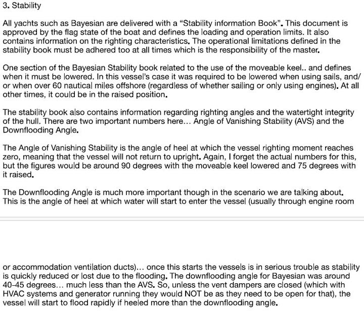

    Detailed remarks and observations from Stephen Edwards (the former captain of Bayesian) on the mast, ballast, stability and hull openings for Bayesian are contained within the attached PDF. The pages have been snipped from the PDF and are displayed below.
    PDF supplied by YF member Norseman.

  13. Pascal
    8,947
    none of the videos mention any type of automation on the sliding doors which I find very odd on a sailing vessel which will heel under sail. I used to run a MY with a big heavy pneumatic sliding door and you couldn’t force it open
  14. Pascal
    8,947
    Very interesting details. I was wondering about the keel design as there had been conflicting information out there. So it turns out it is not a lifting keel with most of the weight in the bulb but just a very heavy center board.
    one thing I wonder though is why the dampers don’t automatically shut down once the boat reaches 45 degrees. Also at what angle do the generators stop working due to falling oil pressure when the oil sloshes in the pan? Years ago, in rough water with a non stab boat I had a gen shut down due to oil pressure. Usually loss of AC power will trigger a damper closing
