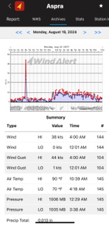

    Btw, most weather stations within 25/30nm of Bayesian reported brief gusts of between 35and 45kts confirming, no surprise, the waterspout was part of a large thunderstorm or squall.
    This one is just around the point from where they were anchored

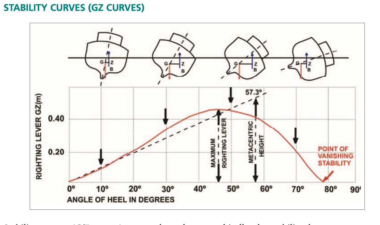

    Agree about the 45° heel on smaller vessels, but on this big'n, things could be different. With the keel retracted, GM is small for comfort, GZ will therefore be minimal, and the ability to recover from a knock-down is compromised. I wonder if 45° is the peak? The following is only an example; not unique to Bayesian. . .
    I want to see what the captain says in the investigation. . .
  14. BlueNomad
    BlueNomad Senior Member
    Jan 11, 2022
    108
    At Sea
    This graph would be representative of a motor vessel.
