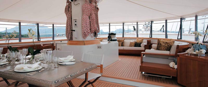

    The area in the photo where the mast meets the deck is a "temporary" structure recessed into the deck, much like a pool. It's used as a living area with a water tight door to the crew area. Tend to think the crew surfaced in response to the weather, the door was open, and chaos then struck. Width of that mast is itself a significant sail.
  8. Pascal
    8,939
    That and possibly watertight side doors left open or at least unsecured while the crew was securing the boat as the storm hit.
    Crew or contractors leaving critical doors open drives me nuts. How much help will the fire system be if the ER door is left wide open for instance? Same with transom doors… doors may have contacts to show they re closed but it doesn’t mean they re actually latched
    being Italy where local prosecutors love to make a name for themselves…. The captain and crew must be worried by now even if this falls into the freak accident category.
  9. rtrafford
    rtrafford Senior Member
    Jul 13, 2019
    1,991
    Vero Beach
    This is the front recessed area under the tent.
