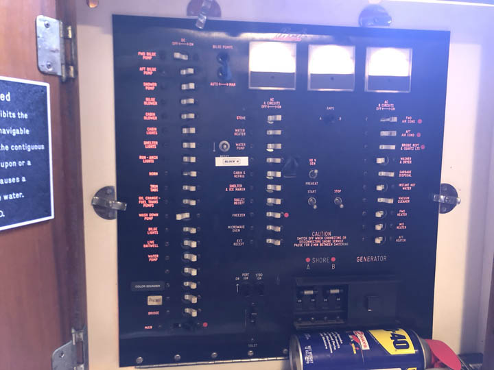

    I had not seen anyone using that before, but the marina the boat is at did have that plug (see pic). Marinco does sell and adapter end that I guess would then just connect to one leg of the more common 125/240-50A service. The single line does power both branches of the panel (all circuits were hot) as seen in the pic.

    Your pic is a 240Vac/50A connect.
    The standard marina connect.
    Check Marinco lead from post #3
    That does look like a dual lead, 120Vac/50A panel.
    Branch A & B are the two legs of 120Vac each.
    In zooming in on the panel, It looks like no 240Vac appliances in use.
    It maybe better described as all 120Vac appliances working on dual 120Vac legs.

    It may be owner mis-speak and has already been re-wired. There was a second power input in the cockpit not connected (I have seen photos of 43's connected with a Y to both outlets). It's similar to our Viking panel with two 120v banks, but the Viking has a 240v generator and at least one 240v appliance (water heater).

    I'm sure this gen-set is 240Vac also, Just like the sore power connect, supplying two, 120Vac lines.

    Maybe not. My boat started out with 2 x 30 ,125 v cords and was converted to 1 x 125/250 v 50 A cord . Both cord sets fed/ feed a 120v A side and 120 v B side but the genny is 120 v output only and feeds both A & B. There are no 250 volt loads on the boat. The drum switch makes the change.
