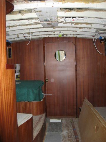

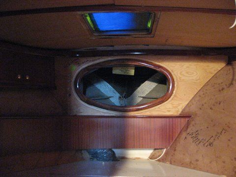

    Hand carved Anchor locker Door
    This is a handmade African Mikore anchor oval locker door. It will have a mirror in the center, Chris Craft logo will be etched in the glass. It will be backlit with bronze LED baclklights.. at night "Chirs Craft" will shine throguh the mirror.
    We deleted the Vee birth and made a sideways double bed.. plenty of room. Everything curves.. no square corners allowed. Look closely and you will see the bow is shaped and cold molded. The original simply dropped in straight pressboard and covered it with wallpaper.
    Behind the coldmold here is Thinsulate insualtion. The cold mold will be covered with sound deadening closed-cell foam, header Ivory Ultrasuede and fully insulated.
    So you all know, Roamer used pink fiberglass insualation in the salon header only, but never insulated the bow area or the sides of the boat. I always wondered why it would not stay warm or cool in certain places. Well, it will now and much quieter.
    Most of this kinda stuff one can do themsleves with proper materials, time and patience. The original hatch (very high quality cast aluminum BTW) was removed so a new cast couldl be there with full view of the sky plus the ability to put install an Oceana sunscreen unit.
    The old 1600 AC unit is built under the birth, all we did was upgrade the contol unit to the latest. The isolation transformer will be replaced by a Charles Industries unit and located in the helm area under the Captain's Helm to the right. Electric now enters the vessel from the starboard aft.

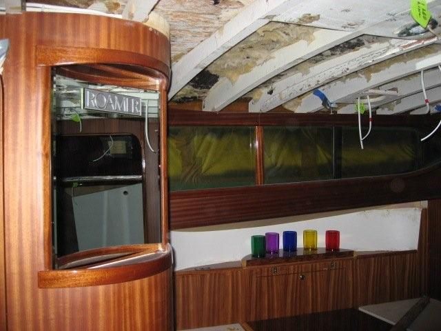

    Roamer Mirrror
    We deleted the closet here, rounded the corner, cut-out installed a mirror with the Roamer logo. This gives a nice sene of openness. What did we do with that space? I will show you later... but the bathroom has a full step-down shower with a tinted gray sliding tubular plexiglass shower tube like the new boats.
    The window is there so it opens too. This was one of the flaws fo 37/38 Roamer baths.. could not open a window! How embarrasing it must have been for guests teaching the china man a music lesson.
    As far as closets, we did lose a lot of haning space as we only have one now, but we built so many drawers. The boat actually has twice the organized space than the original however... like everthing else.. give and take.

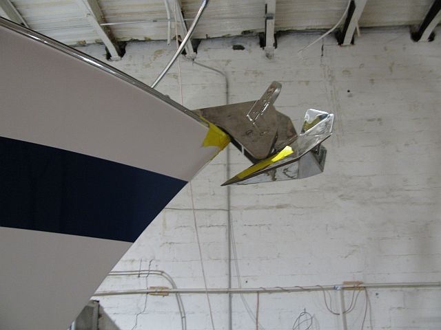

    What's new for today...
    Well, Dennis and Sean are mounting the $160 35 pound polished 316 stainless anchor...
    Again, got real tired of the real high prices from Lewmar and others... so tried China. They did a GREAT job... see for yourself. The roller was $99 and makes most of our stuff look so so. It weighs over 20 pounds and you can shave in both.... Custom made for your Roamer
    e-mail me for catelogue and contacts.. very honest people and positive dealings.. you will have to wait a few weeks though.. maybe six.

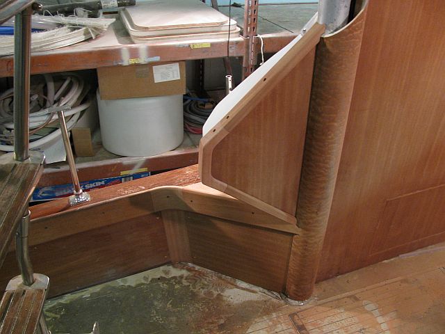

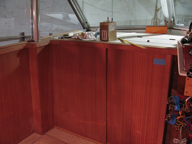

    What's going on in the cockpit?
    Well, let's jump around....
    Note the slider... lots more room now and door is 1.5 inchs thick.. next week watch the porthole and lockset join the party.

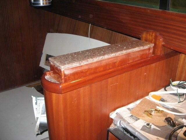

    Is that Snakewood?
    Snakewood... Haa?
    A rare exotic Snakewood is found in remote areas of South America... a place we will all have to go if the economy goes anymore North. All it is is veneer covering a piece of PVC that acts as a decoratve cover for the 3 inch aluminum pipe that is welded into to hull and to the welded aluminum top. Once it is clearcoated really looks cool. Dress up your Roamer, why not?
    The new wood you see is 3/4" solid, and double sound proofed behind. Note the fine joinery being crafted by Capt. Sean. We create as we go... no plans or drawings here.
    I look forward to the finish work.. it's a hobby of mine that I have been practicing since 12 years old and am actualy getting pretty good at... at least I think so. If you like to sniff glue, boat epoxies and clearcoats bring a whole new dimmension to the sport... Come on now, just joking.

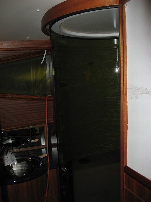

    I'm sweating and smell bad...
    I stink... all this sweat equity is a stinker. Let's clean-up test the new Astro-Tube Star Trek step-down Beam Me UP shower. Oops forgot to pay the water bill! Yes, we lost the closet but who cares.. it was a lot of deep dead space that was well worth the trade-off. Those shower curtain showers that douche the whole bathroom with steam and water.. NO MORE!
    We now have a window in the bath that opens and a really nice shower that is "with the times." Again.. goal is 196O's classic style exterior with the 2010 interior. I beliveve it has been achieved.. and it is a lot of work, but it's fun too! Nothing worse than an old mildew gal. Se smells sweet... "The New Boat Smell." If there is one stink that is the worst it's boat mildew.
    Actually Roamers generally do not have this problem.. praise Metal Hulls!! When is the last time you saw a super tanker made of fiberglass? They use metal for a reason... it's stronger.

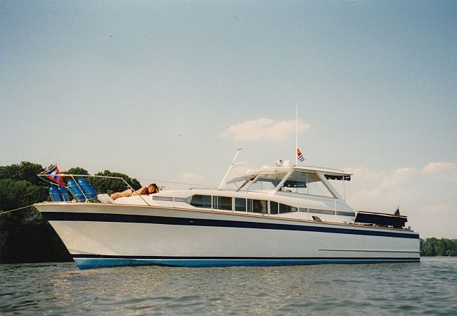

    Another Roamer Citing...
    It's not a UFO, three F-16's just flew over from Andrews in formation... look closely, she's anchored out in front of Mount Vernon just a few miles from Washington. Hard to find one sitting still, 427 Ford Cobras have terminal "ADD." Yes, she's bold... bathing in the No Fly Zone... exceptions are made.
    She's a long way from home. Look closely again... was this Roamer in a Swimsuit Competition? Is there room for two woman?.... You bet!!
    But did she win?... Not sure, but good chance.
