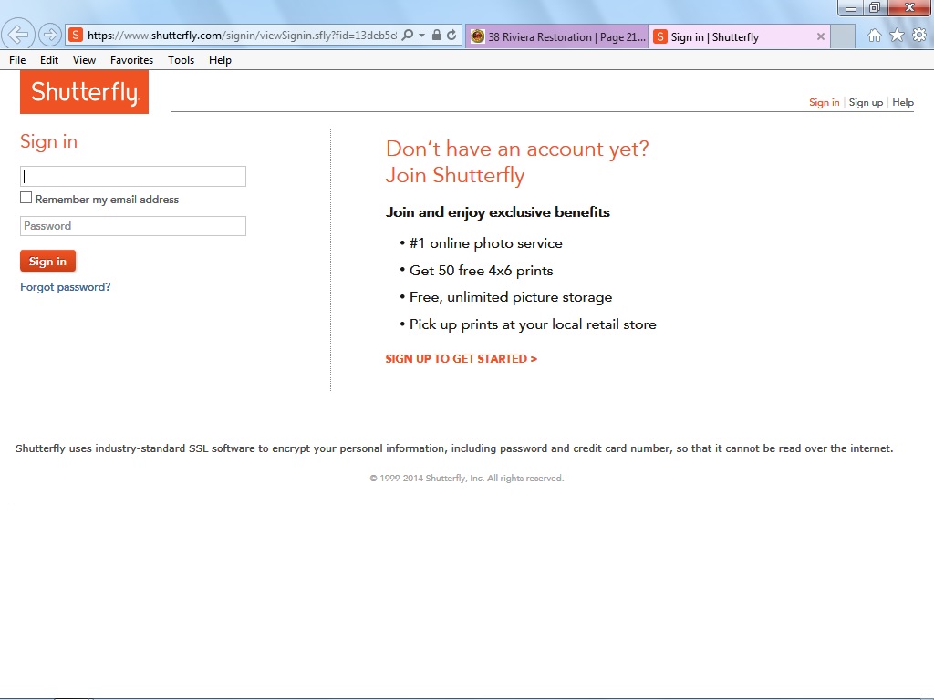

    Clicked on your Shutterfly link and
    posted the result, in prior post.
    Was in hopes something magical
    would cause the pics to appear, now;
    but, alas, was not the case.
    Link requests a login or create an account, still.
    P.S.- Tried post 413 and the same result.
    Caledonia had success posting a link to his pics.
    https://roamer102014.shutterfly.com/pictures#n_5
    Try copying the Shutterfly link for your pics, again.

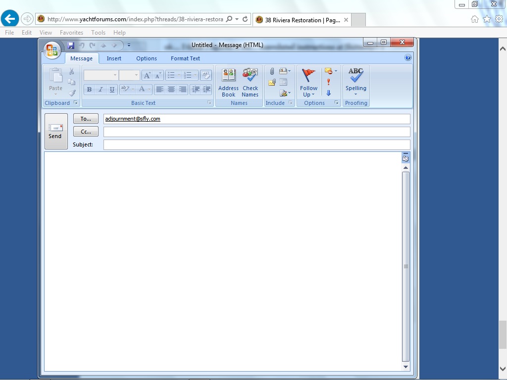

    I have no idea how to paste shutterfly album so it remains live on this thread... again, no instructions... more software errrrrrrr.
  16. homer1958
    homer1958 Member
    Feb 10, 2009
    481
    Annapolis MD
    ok.... I think I figured it out... convoluted instructions at Shitterfly!! I will post when done. Gotta love it... like when your photos are too large, the dopes at VB just have a pop window simply saying "the photos are too large."
    What they should have is a "click here to connect to photo compression tool"... BUT NO, they just leave ya hanging. Unless it is something you do frequently it is a head scratcher for many.
