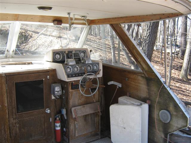

    A few more pictures of the Stargazer.

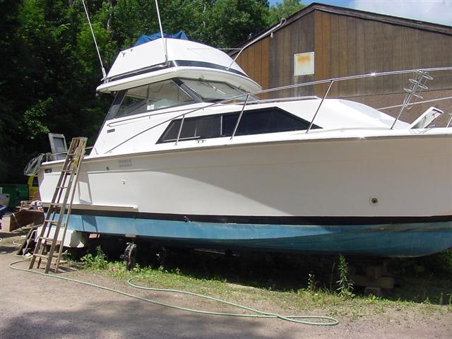

    Any findshed pics of the Trojan?
  3. Henning
    Henning Senior Member
    Sep 22, 2009
    940
    Ft Lauderdale FL
    That my friend is a warning sign that you are dealing with a project where people didn't know, or would not commit to doing a job properly. If they do not care to do the hull properly, what else have they done half a-ed? Right there is where I walk away from it unless I'm taking it as a complete project to strip down and redo. Basically the only time I take on stuff like that is when I'm being payed, or at least given the boat to get it out of a marina operators slip that they are losing revenue on. Rarely do these projects have much value to them, and it has to be something rare and of high value when completed, or something I'd want to keep for the rest of my life.

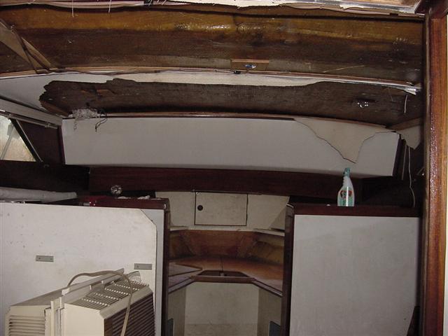

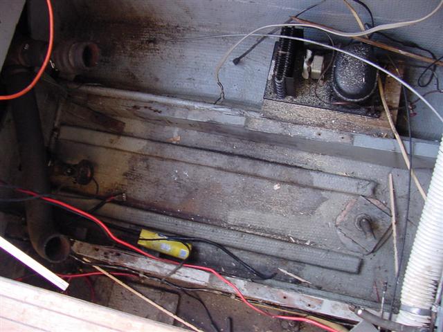

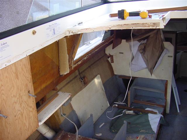

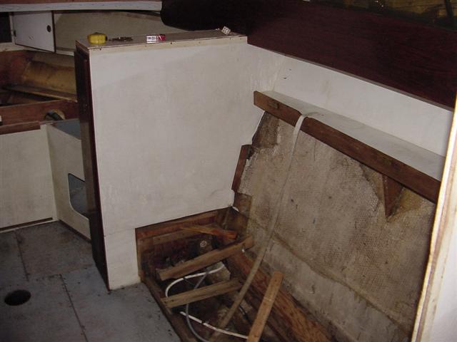

    When I found the F-30 I had actually been looking for an F-32, which is a boat I'm very partial to, because of the classic flybridge lines. The problem was I could'nt find an F-32 that did'nt need deck/gunwhale recoreing and that's something I dont like to do anymore. So I settled for an F-30 sinker, with 2 non pickled 318's and rotten engine stringers instead.
    Here are a few pics before and during My refurb, they dont show how bad it really was. They were taken after a lot of cleanup with the hotsy/steamjenny.
    Both inboard motor stringers were shot.
    After pics soon, Kiwi

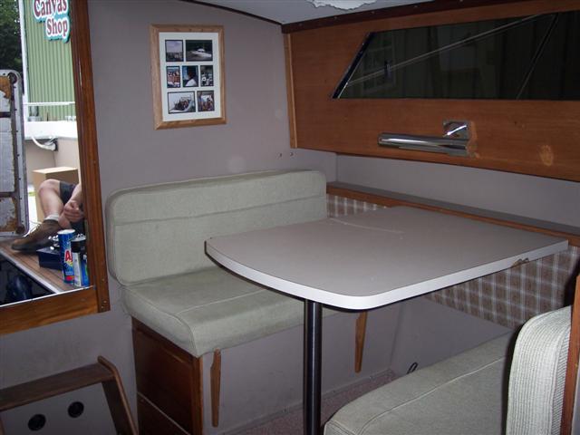

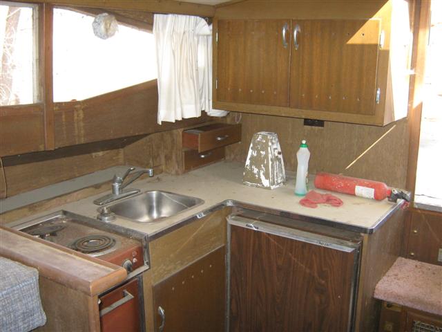

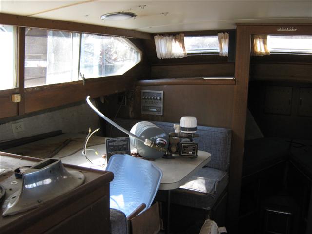

    Here are a few after and during.
    What, You're expecting granite? Ya gotta love the fridge doors and latchs.

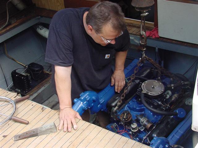

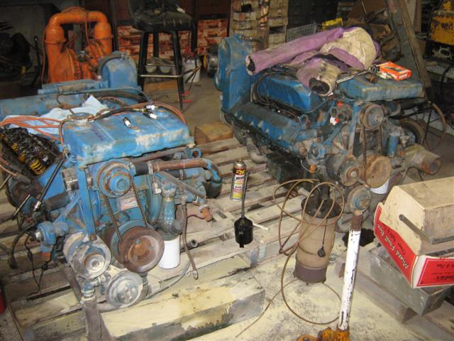

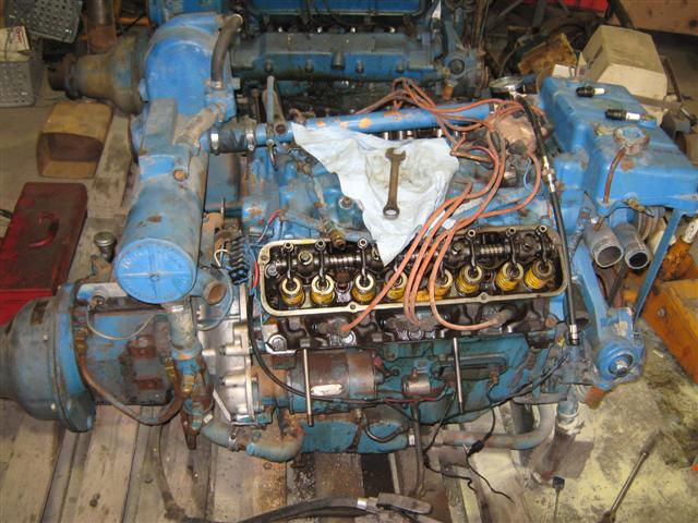

    Here I am installing some fresh iron, the starboard motor needed a crank cut and shells, bored cyls, pistons and a simple valve job. In the port motor I kept the sunken shortblock as it was except for seals. The heads were junk except for the castings. Believe it or not, the B&W Velvetdrives never had any water intrusion after a about 4 days underwater, I changed the oil in them and ran em, no problems.
    I miss that boat, Kiwi

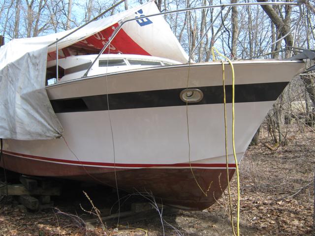

    Back to Roamers. Here's a peek at the Seafarer, from a few days ago.
    We pulled the 427's out, We did fire them up, within 24hrs of pulling Her up from 63' of Tennesee river, (Kentucky Lake) water and mud, some 7 years ago. They were well oiled and still roll. I'll be tearing them down soon.

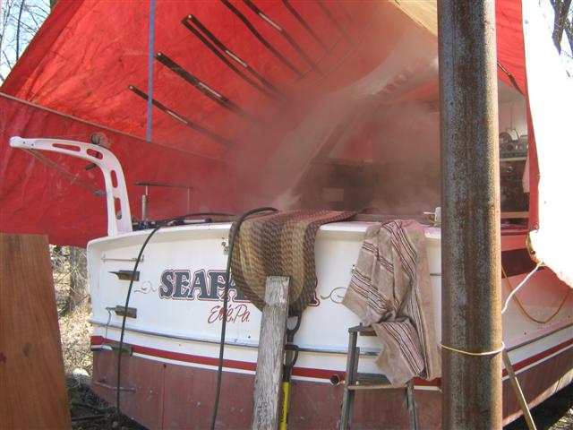

    After removing several thousand pounds of mud and some hotsy work, it dont look to bad?
    The engine room is gutted and the complete cockpit deck, has been removed. Under that cloud of steam, is Mike....He's the only one who can fit into the fishing waders:D
    Can You follow this? Kiwi
